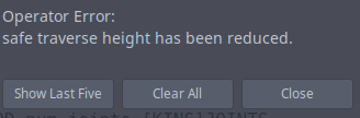

04 Mar 2022 03:51 #236308
by RNJFAB
Replied by RNJFAB on topic Homemade, cheap, plasma CNC
Everything has been going great since the last update.
A few tweeks here and there to provide better cuts, still a few little things to go and i dare say this CNC plasma may be done.
A THCAD has been ordered to add ohmic sensing, this will be a great upgrade as I cut a lot of thin material for signs.
In the last week I must have changed something, somewhere, as I am now getting a error. (safe traverse height has been reduced).
All settings in qtplasmac and sheet cam have this set at 30. so not sure what has caused it or why it suddenly popped up. I do know that everything I have read and tried doesn't fix it.
help
help
- phillc54
- Posts: 5711
- Thank you received: 2100
04 Mar 2022 03:54 #236309
by phillc54
Replied by phillc54 on topic Homemade, cheap, plasma CNC
It this warning is happening during a cut it usually means that the sheet buckled enough to decrease the available safety height.
The following user(s) said Thank You: RNJFAB
- RNJFAB
- Posts: 251
- Thank you received: 59
04 Mar 2022 08:06 #236317
by RNJFAB
No Phil,
It happens between moves, No sheet buckling.
Z axis has 15mm up and 150mm down. nothing interfering. good probe, good height control.
- Posts: 22011
- Thank you received: 7491
04 Mar 2022 13:29 #236339
Replied by tommylight on topic Homemade, cheap, plasma CNC
Set probe height higher.
