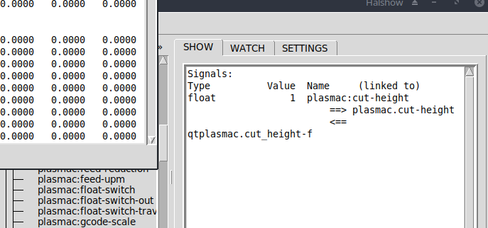

Can you check the hal pin plasmac.cut-height and make sure it changes when you change the Cut Height parameter in the GUI.
Oops, that should be plasmac.safe-height
Last edit: 12 Mar 2022 17:57 by phillc54.

Use the WATCH tab and it should be plasmac.safe-height
- RNJFAB
- Posts: 251
- Thank you received: 59
12 Mar 2022 18:05 #237051
by RNJFAB
Replied by RNJFAB on topic Homemade, cheap, plasma CNC
Confirmed. It changes as i change the safe height in the GUI

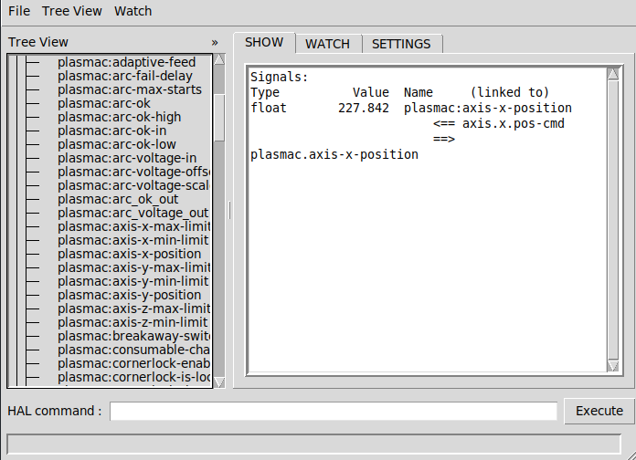

In Halshow select the SHOW tab and then look in Signals on the left panel and select the signal named plasmac:axis-position and see what pins are linked.
I dont see the link in your hal file but the error you are getting doesn't seem to relate.

12 Mar 2022 19:26 #237059
by RNJFAB
- phillc54
- Posts: 5711
- Thank you received: 2100
12 Mar 2022 19:31 #237060
by phillc54
Replied by phillc54 on topic Homemade, cheap, plasma CNC
That was plasmac:axis-x-position, there should be one named plasmac:axis-position
If you cannot find it then edit your hal file and immediately after this line:
add this:
It seems to be missing from your posted hal file but I wanted to make sure.
# ---JOINT ASSOCIATED WITH THE Z AXIS---add this:
net plasmac:axis-position joint.3.pos-fb => plasmac.axis-z-positionIt seems to be missing from your posted hal file but I wanted to make sure.
