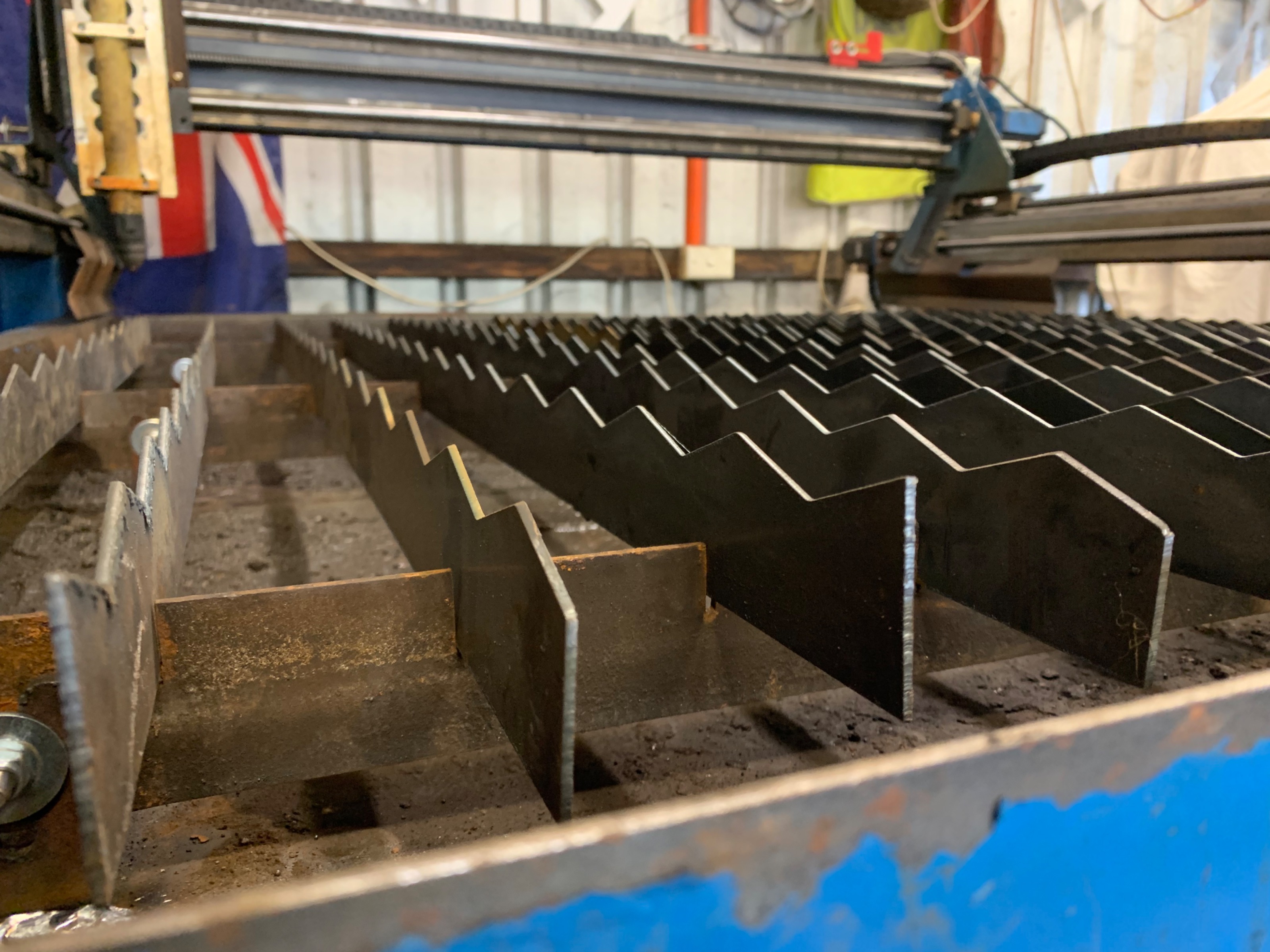

31 Jul 2022 10:23 #248712
by RNJFAB
Replied by RNJFAB on topic Homemade, cheap, plasma CNC

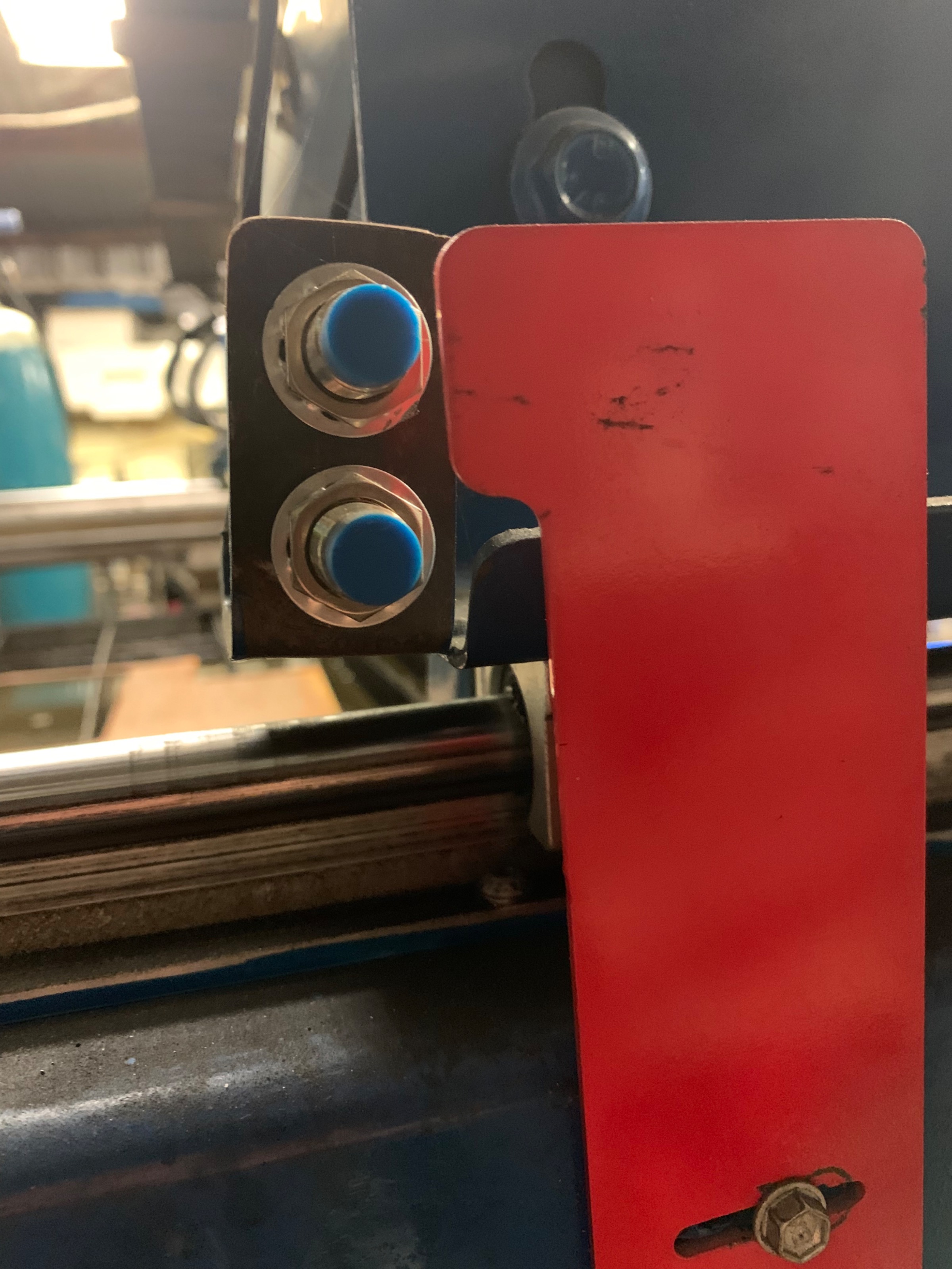

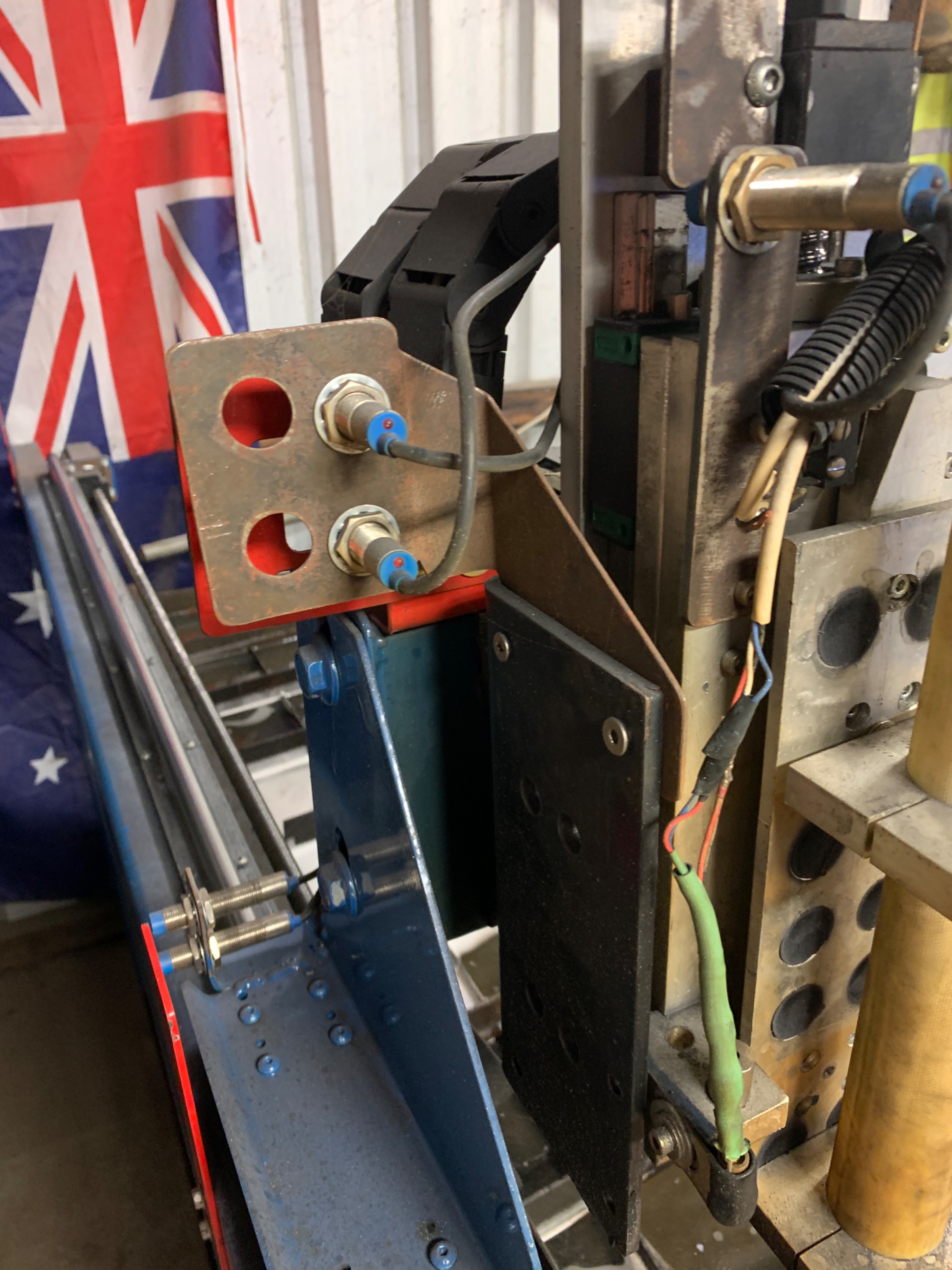

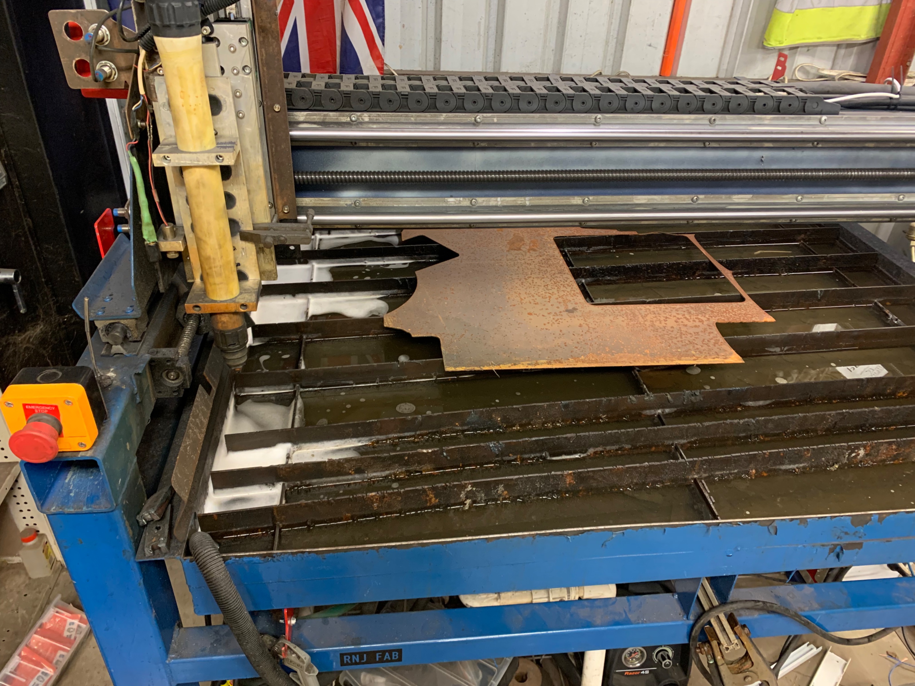

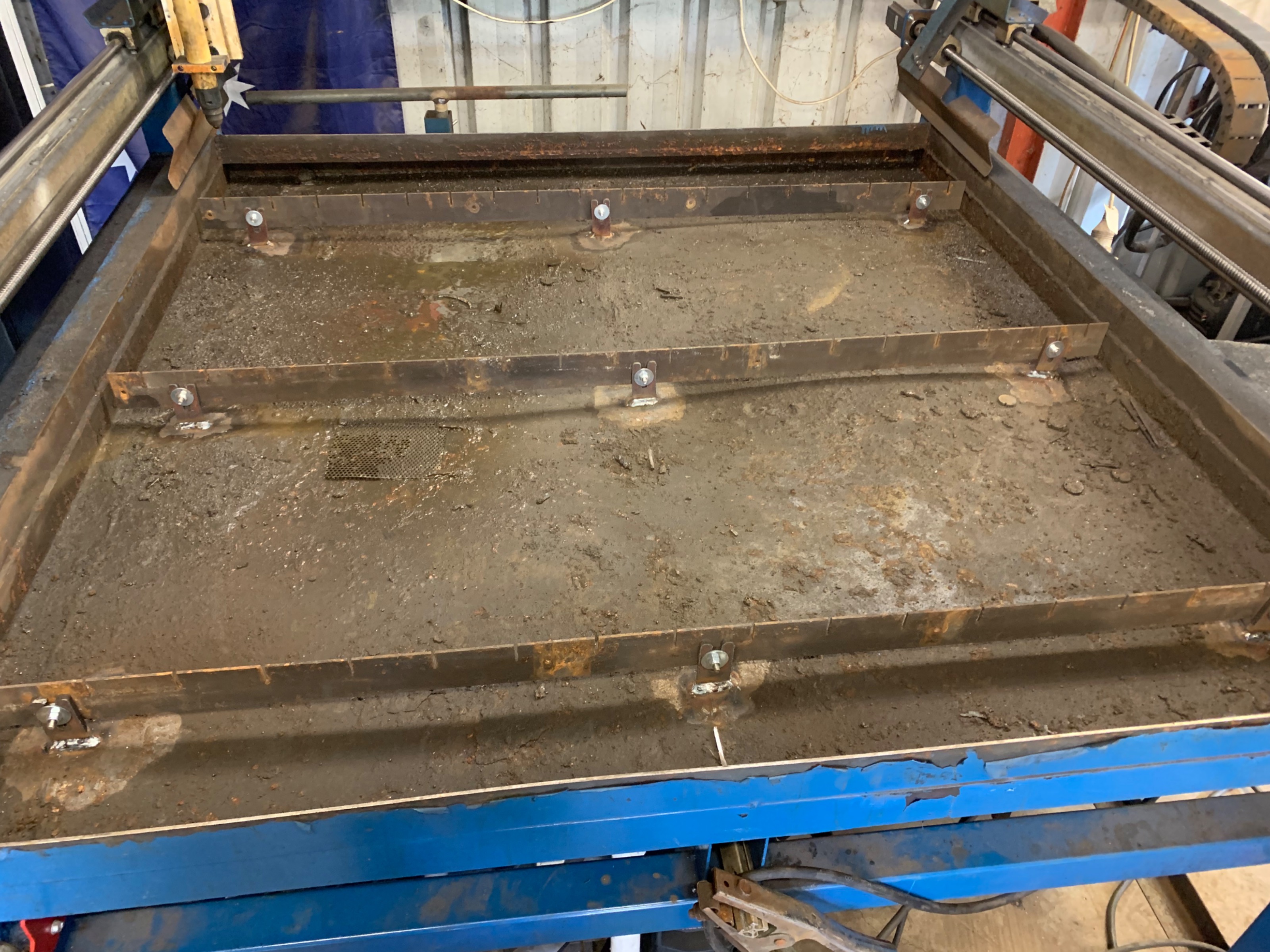

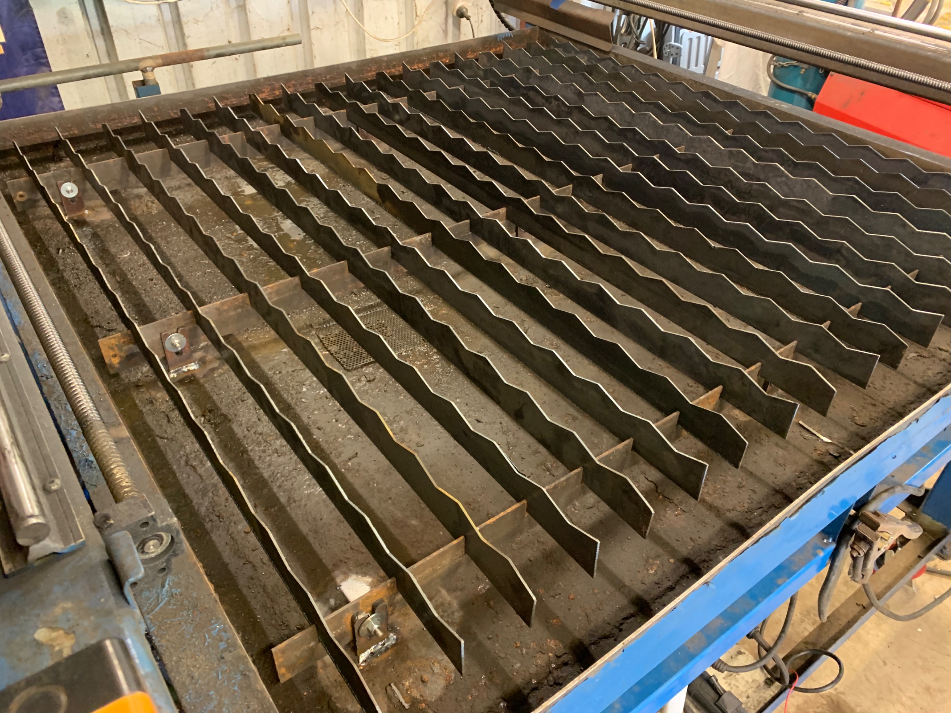

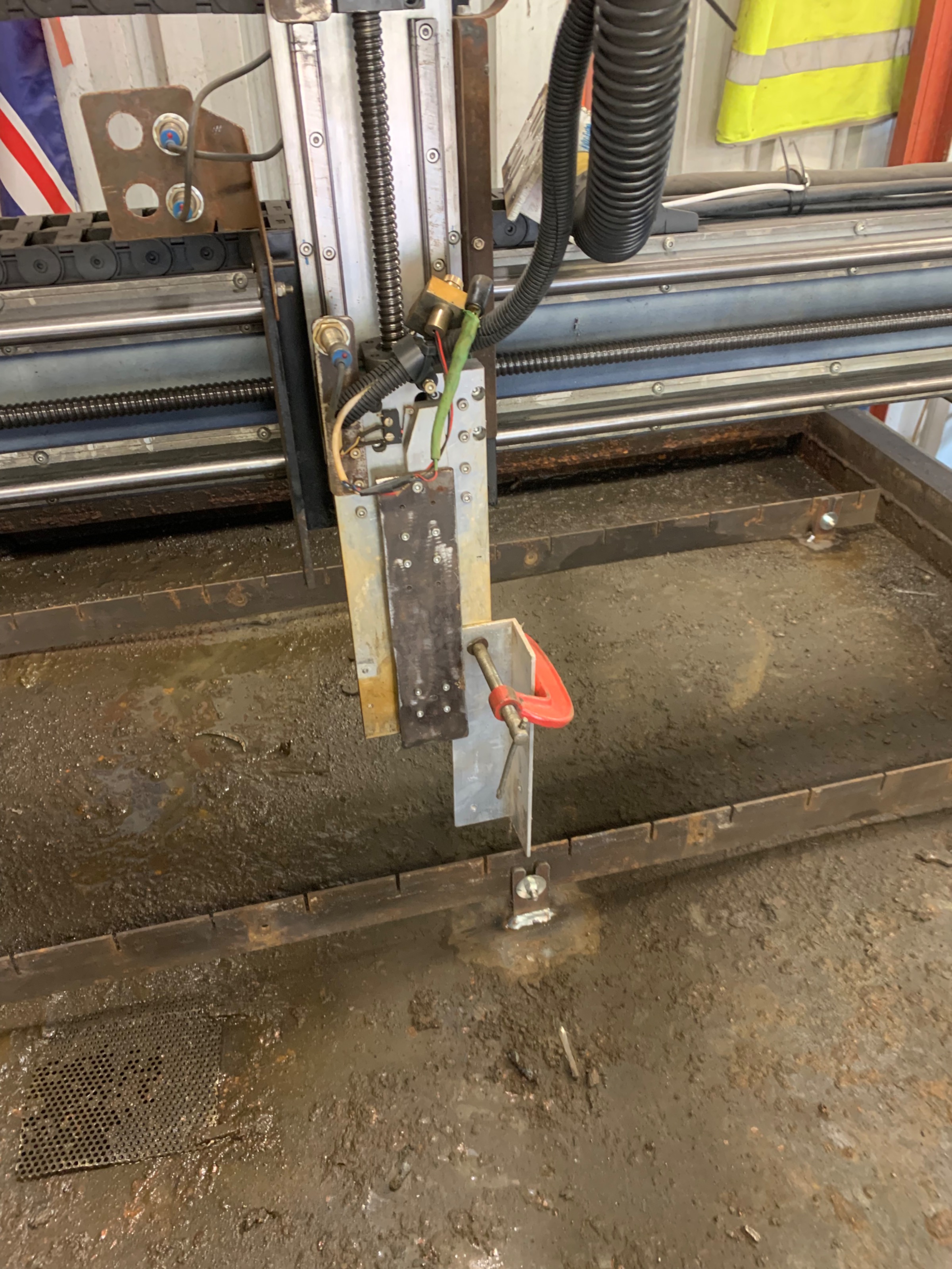

Been a big weekend for the CNC.
Cut the old mounting system out of the water table and designed and installed the new one.
Changed the slat orientation, made new slats, new slat holders.
One of things that I should have done from the start, but didn't. It all works much better now.
Next thing on the list is to redo the laser mounts.
Pics below.
Pics below.
