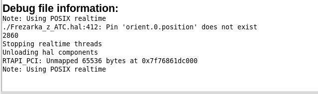

20 Jul 2023 10:19 #275881 by Artur_1617
Replied by Artur_1617 on topic Mill atc configuration
 Get error on start.
File Attachment:
File Name: Frezarka_z_ATC.hal
File Size:16 KB
