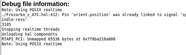

OK, I see you have loaded orient with names=
So the HAL pins should be just orient not orient.0
Also, I think that line should be orient.command not orient.0.position.

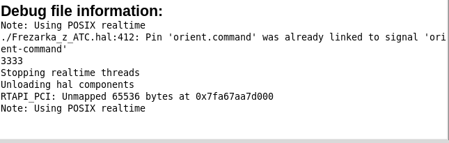

20 Jul 2023 11:06 - 20 Jul 2023 11:14 #275887 by Artur_1617
Replied by Artur_1617 on topic Mill atc configuration
Another
Try to change to command and get error to
Last edit: 20 Jul 2023 11:14 by Artur_1617.
20 Jul 2023 13:30 #275897 by andypugh
Replied by andypugh on topic Mill atc configuration
Yes, so, fix the issues as described. I did say that my example would need to be altered to suit your HAL.
Also, it's not the best idea to have signal names identical to pin names, it causes confusion.
Also: I forgot the "loadrt" lines for the wcomp and sum2 components.
