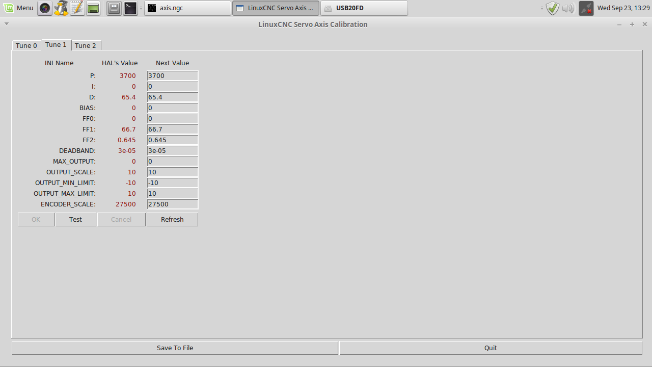

Many thanks to tommylight and JR1050 for your help. I have been working with AMC engineer and the recommendation is "current mode" drive set up. The motors are DC "brushed type" with encoders, other that that I know very little about them. Today I have the ability to use the "Linuxcnc logo" cutter path to provide motion to motors, they are noisy, especially at low speed. Lots of rigidity, hard to move off stop position with motors energized. It appears to me the original P,I & D settings are being used unless the drives know how to work around this.

Seems like something is not tuned properly as servo motors should be quiet while moving and stationary.

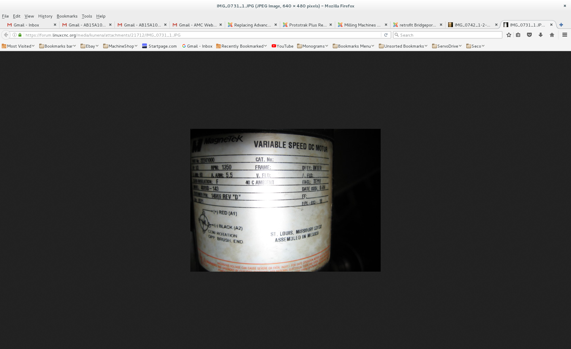

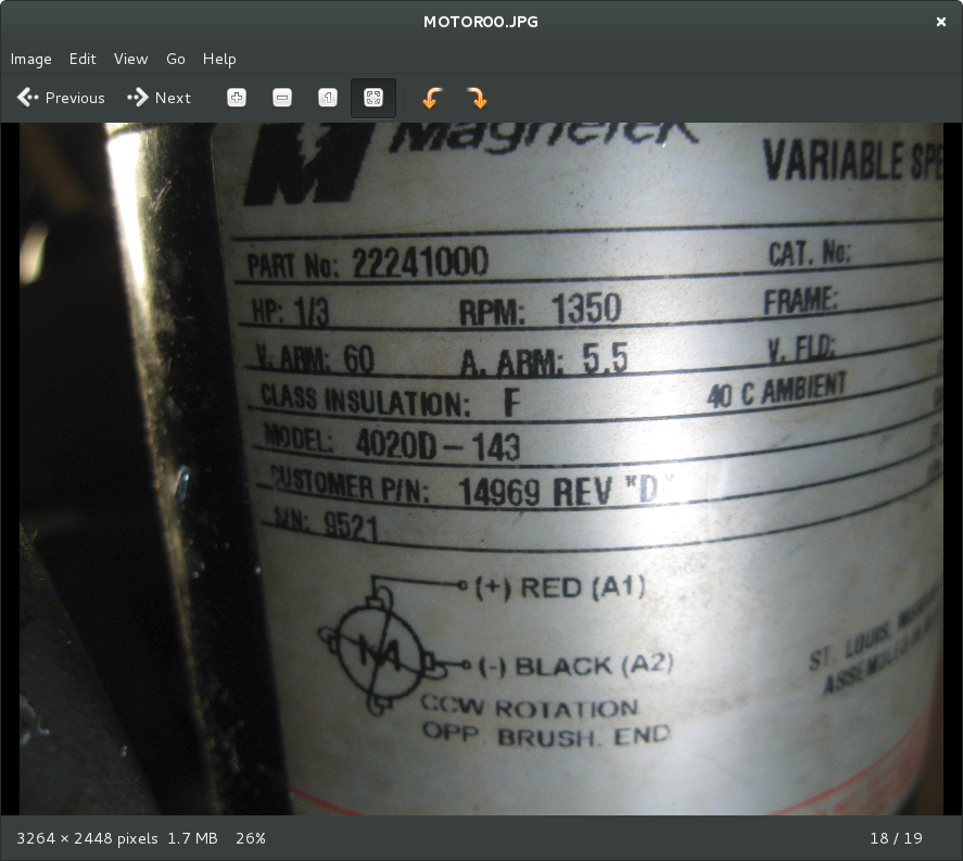

JR1050, Many thanks for you thoughts, please point me in the correct direction!! This is the motor tag, I have search many times and could not find any information like the " current limit gain scaling that is correct for the motor" or any technical data. I believe they are re branded product.
The motors have encoders built on them, going back to power supply box, so high power and encoder control cable, is this what is required for Encoder Velocity Mode? The 12a8 were set up in current mode I think. If I need to do more reading please point me in the correct direction, I offer my many thanks for all who make this forum possible. The original equipment was a Prototrak Plus, currently same motors and power supply.

Look at the original dip switch settings on the drive and compare them to the settings in the manual. Do these motors have tachs? The motors would not list a scale of any kind. Email magnatek and ask for product data for that part number. If they have tachs , they were in tach velocity mode, they could be set up for either back emf or current mode. They look like the outside of the motor is chrome plated, if so , they are probably Electrocraft.

JR1050, thanks for your help! The tag on the motors are to "look" chrome, 1 of them unless you hold just right the writing is not visible, just shinny. The motors are painted black, I will spend what ever to track down the Magnetek data, specifically "motor current ratings". Thanks
