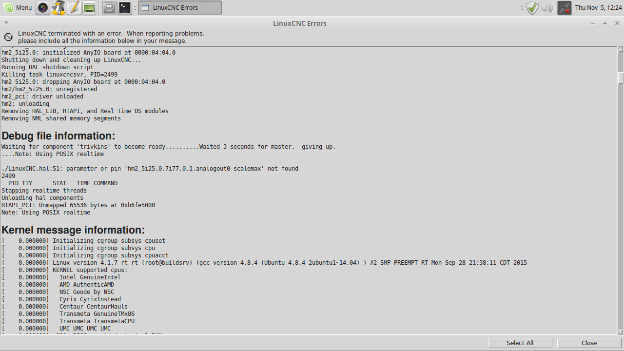

Todd, Many thanks!! As I start the CPU is running linux mint. If I start linuxcnc w/o power supply on will get debug message attached. I apply power to power supply, no motor motion; when linuxcnc is running with logo up, motor no motion; when I click on the left (F1) button at the top, no motion; when I click the right button (F2) motors will run, click right (f2) and motor will stop, motor is not locked, will turn with your hand.
