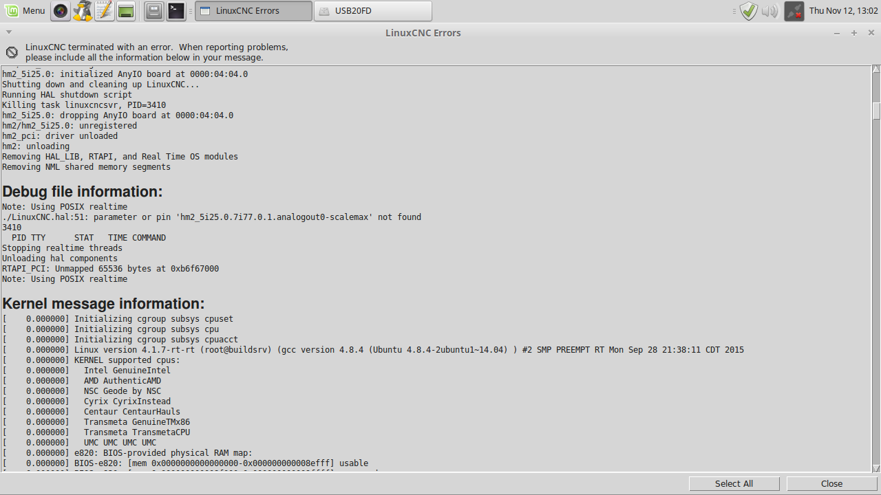

12 Nov 2020 18:20 - 12 Nov 2020 18:26 #189140
by new2linux
Replied by new2linux on topic Replacing Advanced Motion Controls "brush type 12A8 with "Axcent" amplifier
To all the forum members & moderators, Many, many thanks for the opportunity to learn and all of the continued support. I have been in contact with A-M-C's Engineers (the best support ever) and was asked to test the drive with the following settings.

It was good news that all is good with the drives. I have tested each lead from the TB3 to each encoder plug at the encoder to insure the lead is going where its suppose to be going. Now if the linux mint is running and e-stop is released and linuxcnc is started to run F1 is down, both DRO works correctly, including direction; F1 up now, worked just as before, both DRO works correctly, including direction; click F2 (is down) x axis motor oscillates until "joint 1 following error" appears, the DRO work. If you click F2 again. immediately motor oscillates again.
I will attach the current debug file pic, the .ini & .hal that I am working with.

12 Nov 2020 19:23 #189144
Replied by Todd Zuercher on topic Replacing Advanced Motion Controls "brush type 12A8 with "Axcent" amplifier
You now need to follow the steps for tuning the PID loop in Linuxcnc. The X-axis oscillates and shuts down because you have a un-tuned values for your PID for the x-axis. Sart with a very low value for P and gradually increase it until you begin to see instability, then reduce it by 10% or until the oscillation stops. Look up and follow one of the tuning tutorials out there. (This is a decent one gnipsel.com/linuxcnc/tuning/servo.html )
