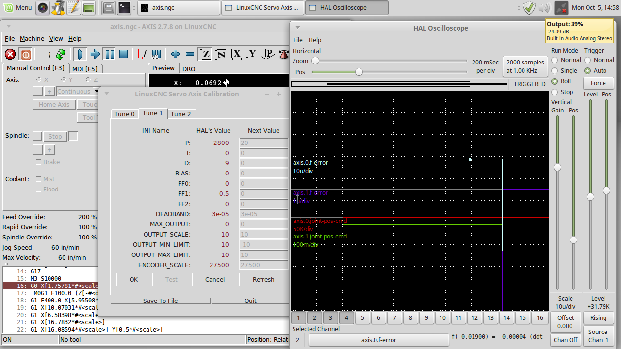

- new2linux
- Posts: 711
- Thank you received: 9
05 Oct 2020 19:01 - 05 Oct 2020 19:38 #184994
by new2linux
Replied by new2linux on topic Replacing Advanced Motion Controls "brush type 12A8 with "Axcent" amplifier
This is a better pic of what is set how. Current the machine will run 60 "/min w/o joint error. I do not believe the hal scope is complete, the 0 and 1 axes a set as per tommylight excellent tuning advise. I am not shore this is set up completely?
"On the "hal scope" press "1" at the bottom left and chose "joint.N.motor-pos-cmd" by scrolling down, press "2" and find and choose "joint.N.f-error", set it at "auto" and "roll" on the upper right corner.
Last edit: 05 Oct 2020 19:38 by new2linux. Reason: new screen shot

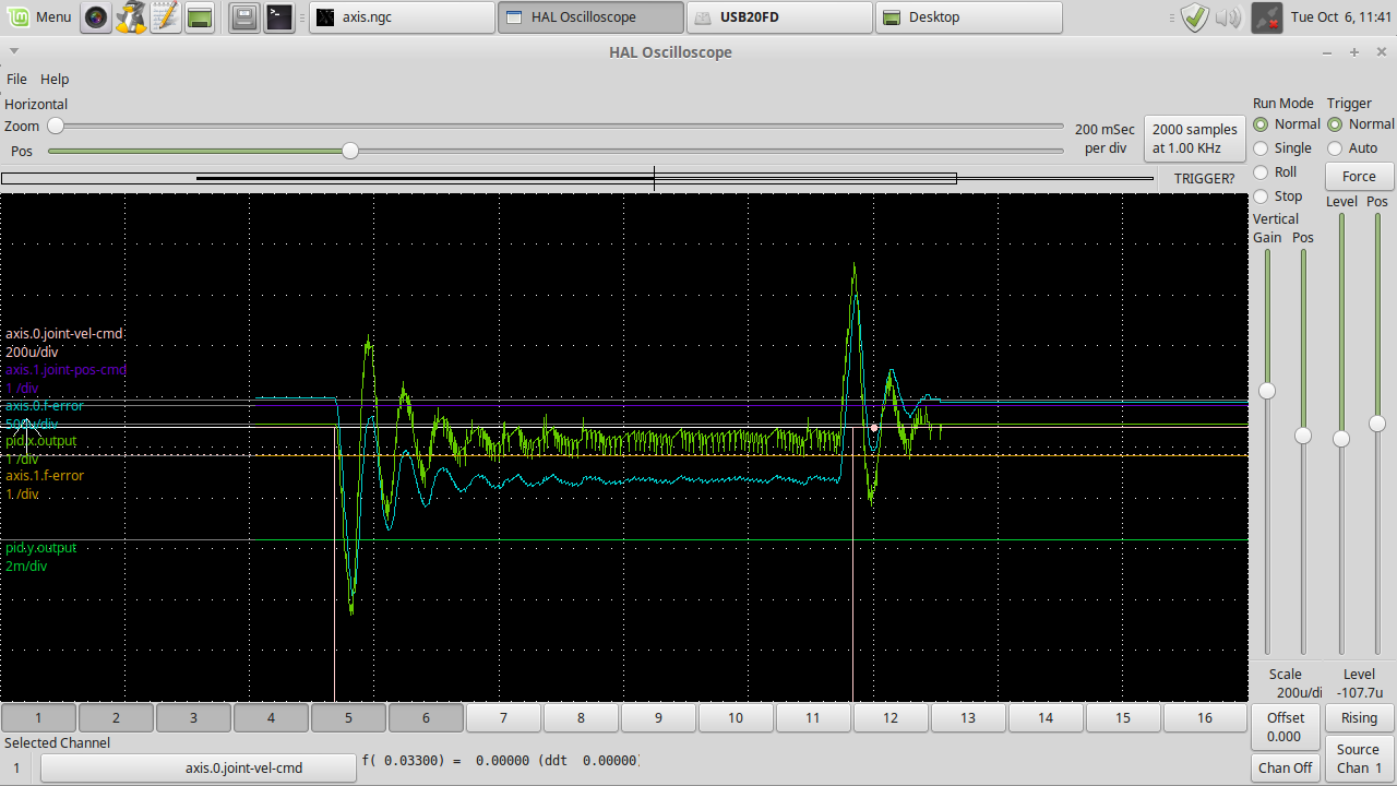

- new2linux
- Posts: 711
06 Oct 2020 15:51 - 06 Oct 2020 16:05 #185090
by new2linux
Todd, Many, many thanks for your help! I have set up the hal scope as per your reply, and included pic of it. I release that as I tune the scale will need to be changed as to get to the necessary quality of the tuning. The only way to move axes that I have found to work is the "+"&"-" like used with jog (use the mouse pointer) and the axes in question.
The scope 1 through 6 are as follows (1,2,&3=x axes 4,5,&6=y axes):
1) joint.0.joint-vel-cmd
2) f-error
3) pid.x.output
4) joint.1.joint-vel-cmd
5) f-error
6) pid.y.output
Many thanks

- Todd Zuercher
- Posts: 4793
- Thank you received: 1480
06 Oct 2020 16:28 #185092
Replied by Todd Zuercher on topic Replacing Advanced Motion Controls "brush type 12A8 with "Axcent" amplifier
The X axis should jog using the left/right arrow keys on the keyboard, Y axis should be up/down, and Z should be Page Up/Page Down.
In Halscope, work on one axis at a time, Turn off the Y axis pins, and add one for pin "hm2_5i25.0.encoder.00.velocity" (change 00 to the encoder number used for your X-axis). Reduce the gain on the joint.0.joint-vel-cmd, until you can see the cruse section on the screen. Then adjust the gain on the encoder velocity to match. You can then save these settings in Halscope (File/Save Configuration) that you can reload as needed. Save a different configuration for Halscope for each axis you need to tune.
Reduce your P until the over shoot osculations mostly go away. Once you have it smooth, then adjust the FF1 to minimize the following error during the cruse (looks like you may have a little too much FF1 in that screen shot.). Then you can use FF2 to try to smooth out the remaining following error during the acceleration and deceleration portions of the move.
Once you have the Feed Forwards tuned you might be able to add a little more P to stiffen it a bit more without adding too much overshoot.

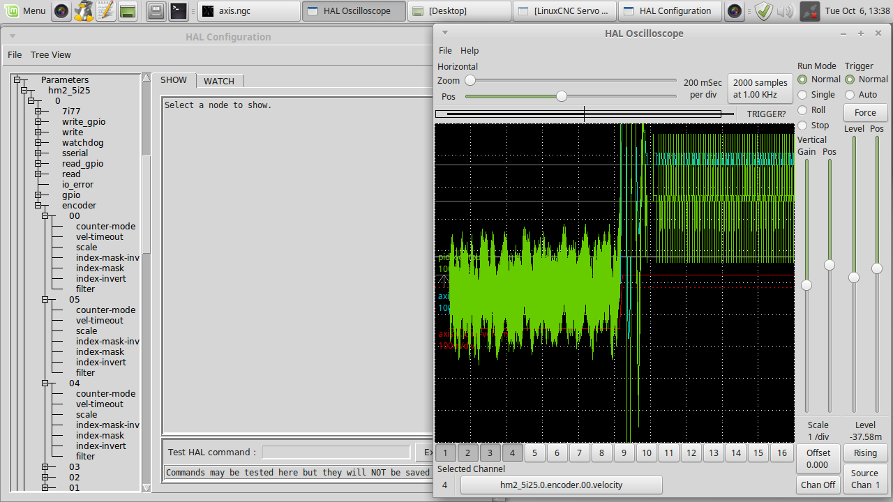

- new2linux
- Posts: 711
06 Oct 2020 17:40 - 06 Oct 2020 17:57 #185104
by new2linux
Last edit: 06 Oct 2020 17:57 by new2linux.
- Todd Zuercher
- Posts: 4793
06 Oct 2020 18:21 - 06 Oct 2020 18:22 #185108
The number of the encoder each axis is using will be dependent on where you plugged each one in to the board. It should be noted in your hal file, and you should be able to see what each is connected to in the Halshow window if you click on them.
That image above is very noisy, turn down the gain and hopefully it will be a bit easier to look at.
Last edit: 06 Oct 2020 18:22 by Todd Zuercher.

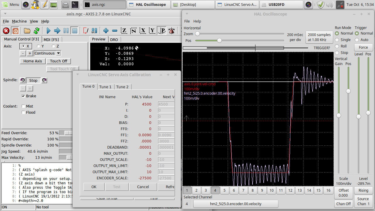

- new2linux
- Posts: 711
06 Oct 2020 19:56 #185128
by new2linux
Todd, many thanks! This pic shows the current set up using only the channel 1 (N.joint-vel-cmd)& channel 4(hm2-5i25.0.encoder.00.velocity); all others are off, this is the "x" axis only. I need to make these trace look as close as possible to each other, this at approx 40'/min, as in pic. When I start y axis, will have values in the low P (just like this), with low feed rate, work up to 40"/min.
many thanks!
From tommylight post: Example:
say the 0.5 value had a slower rise or fall of the f-error line on the scope, put 0.4 and test again. If the move of the f-error line was slower, lower it a bit more say 0.3 and test again, it it was faster, increase it a bit to 0.45 and test again.
End of example
Am I to look at the height of the line or the amount it goes above the reference line?
many thanks!
End of example
- Todd Zuercher
- Posts: 4793
06 Oct 2020 20:15 #185136
Still too much P, You're trying to get rid of those oscillations. What does it look like with P=2000?
