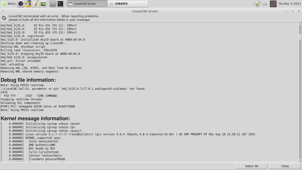

There are two essential wiring requirements that you must have working correctly before even attempting to tune or even power up the servo drives. The first is the drive enable signal. Your wiring diagram above doesn't show it being connected. It would be connecting pin#9 on the AB15A100 drive to TB5#2 on the 7i77 card then TB5#1 on the 7i77 card back to pin#11 (ground) on the drive. (Also dip switch SW1-5 should be set to OFF on the drive.) It is essential that the polarity of this connection be correct on the 7i77 card or the chip on the 7i77 can be ruined. If you have accidentally already ruined the enable output for that drive on the 7i77 card, you can use one of the other unused enable outputs (they are all switched together anyway) or set up a relay and control it with one of the regular field outputs.
The 2nd thing you must have working is the encoder feed back. And here I am very confused by what you say you have and the photos of what you did have. Your initial photos and your drawing shows that you have(had) 6 wires connected to the 7i77 encoder input orange, red, grey, green, violet, and black. But then you reference a US Digital pigtail CA-LC5-W4-NC that only has 4 wires. Did you change encoders for some reason? I'm just not sure what you actually have going on.
For the 4 wire encoder you would move the jumpers on the 7i77 for encoder0 to thier single ended setting. Jumper W19 and W21 should be set to the left side (default was to the right). But if your encoder is in fact a differential one with 6 wires you should leave the jumpers in their default positions.
Does the encoder feedback work? (When you turn the encoder does the DRO change?) Does it work if the leads are connected to pins 6 and 7 of the drive? If not does it work when they are disconnected? You might also need to connect a wire from pin #11 on the drive to TB3#1 on the 7i77.
If you were trying to start Linuxcnc with the drive powered off and Linuxcnc failed to start, the most likely reason is that something you did to prevent the drives from powering probably also removed one of the power sources from the 7i77 card. But I can't say for sure without seeing the debug message or knowing more about exactly what you did.
It is ok for the drive to be powered when Linuxcnc is not in control as long as they are not enabled. (back to that pin#9 connection on the drive) If they are not enabled they will not be powering the motor.

Edit:Attached is a pic of the debug info when 1st start up w/o power to motor, with the pin 9 & 11 connected to TB5 (positions 1 & 2). This also has 6 & 7 connected to TB5, as in earlier post. When I power up motors & restart linuxcnc, I get logo screen, the motors are in motion. As per suggestion SW1-5 is off (all SW1-1 to-6 is off). DRO does not move.
