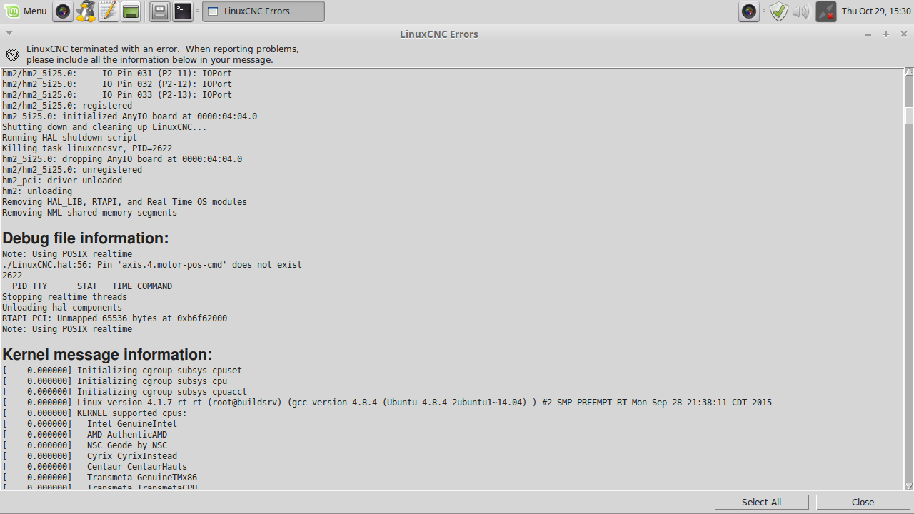

29 Oct 2020 17:43 - 29 Oct 2020 19:26 #187703 by new2linux
Many thanks, for all the help! I have edited the .ini & .hal files with the "find and replace" go from 00 to 04 & 01 to 05. The error is shown in the pic. This included the new locations TB4 & TB5 on the 7i77 card with the "jumpers" to the left. The wires under the screw on pins 1 & 4 (to provide additional input) are off for now. The LEDs on 7i77 are ok with exception of red LED that usually goes blinking (I think) after establishing connection.
Many thanks
Edit: similar error message.
Last edit: 29 Oct 2020 19:26 by new2linux. Reason: new .ini & .hal files

29 Oct 2020 20:19 #187718 by Todd Zuercher
In Linuxcnc versions 2.7 and older.
The axis numers can not be skipped and must be in order.
X axis = AXIS_0
Y axis = AXIS_1
Z axis = AXIS_2
Not sure how you ended up with the Axis numbering in your files.
