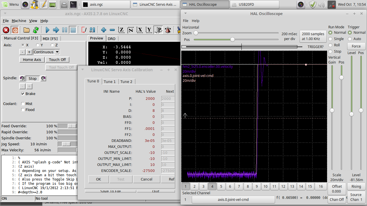

07 Oct 2020 12:33 #185237
Replied by Todd Zuercher on topic Replacing Advanced Motion Controls "brush type 12A8 with "Axcent" amplifier
Ok, now with P set to 2000, increase the FF1 until the average velocity feedback matches the commanded velocity during the cruse part of the move.
You need to dial in the feed forwards better before cranking up the P. When the P is set very high it makes it very hard to see what the feed forward terms are doing as you tune them.
The cyclic error during cruse is a little disappointing. Can you describe the mechanics of the axis? Also the drive may need better tuning. Is the drive receiving any form of feedback from the motor for calculating velocity (tach, encoder)?

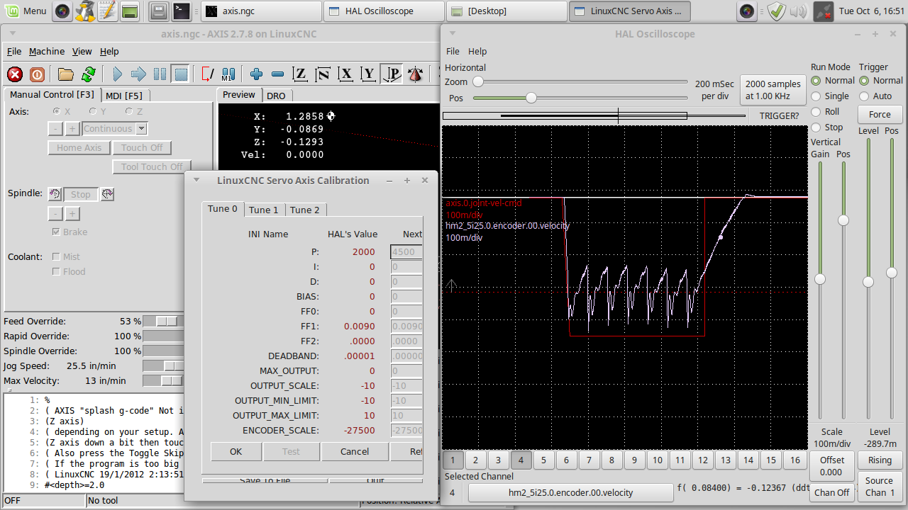

07 Oct 2020 14:57 - 07 Oct 2020 15:01 #185257
by new2linux
Replied by new2linux on topic Replacing Advanced Motion Controls "brush type 12A8 with "Axcent" amplifier
Todd, Thank you. The pic shows the setting as per prior post, need to verify is this ok. The feed is low (10"/min), if I set it higher will have joint error. This axis is the "x" axis of Bridgeport Mill. The motors have encoders (2000 count seems correct) built in. Will it help to add the other channels?

07 Oct 2020 15:43 #185263
Yes, showing the f-error and the PID output could be helpful.
Is the servo drive receiving any form of feedback from the motor?

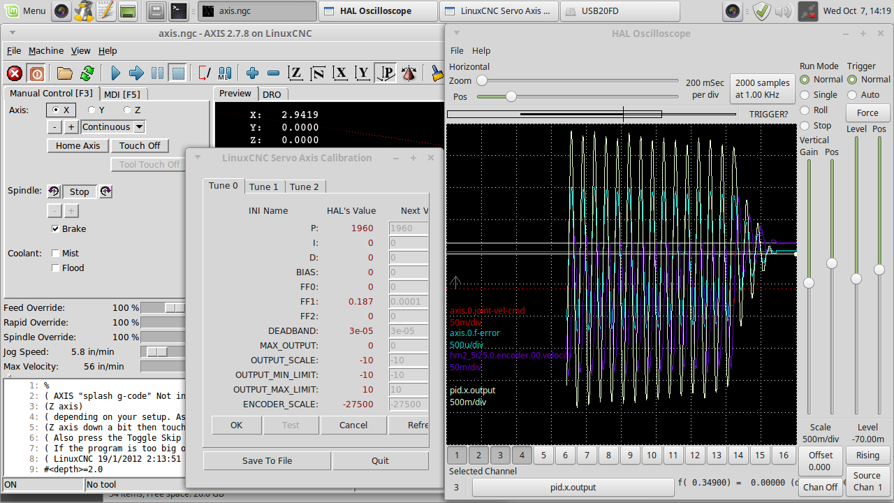

07 Oct 2020 16:34 - 07 Oct 2020 18:14 #185277
by new2linux
Todd, Many thanks. The mill is set up with encoders, the DRO works, how would I check further? The pic shows P=1960 FF1=.187; Feed 5.8"/min. There seems to be this spot in P it will work well with feed. Can't seem to get faster feed rate w/o motor jerking (lack of better term)(verizon is not working well today or yesterday, you type and then it will show up while you wait!) I did not include other channels this pic but will next time.
Edit:Please note D=8 I am reworking this now.
This is P=1960 FF1=.187; Feed 5.8"/min
