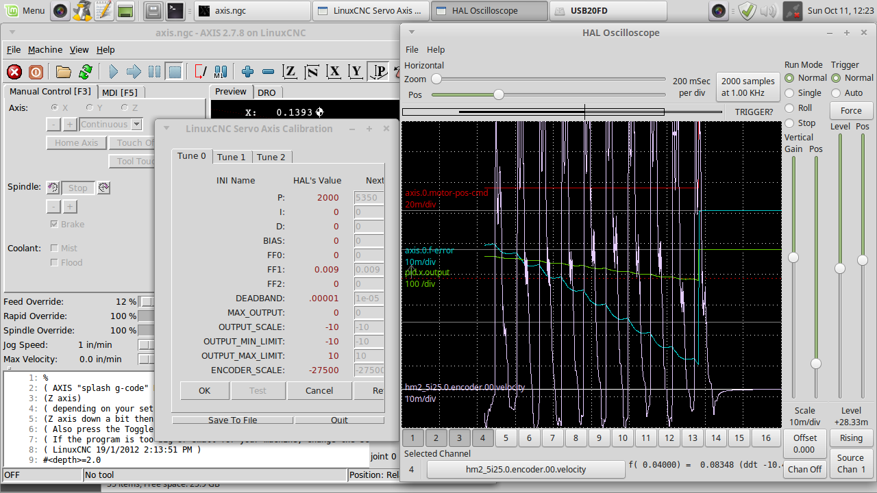

The plots show what looks like a torque mode drive, which will need P,I and D and some FF2.
It should be tunable but is a bit fussier to tune than velocity mode drives. It also may need a
shorter than normal servo thread period as Todd mentioned.
For single PID loop torque mode rough rule-of-thumb tuning:
You want to set D as high as is stable (it will get crunchy/buzzy if too high) and then
back off maybe 30% then do the same with P. Then you add FF2 until the lag during
acceleration is compensated. finally add I until it becomes unstable and then back
off about 50%

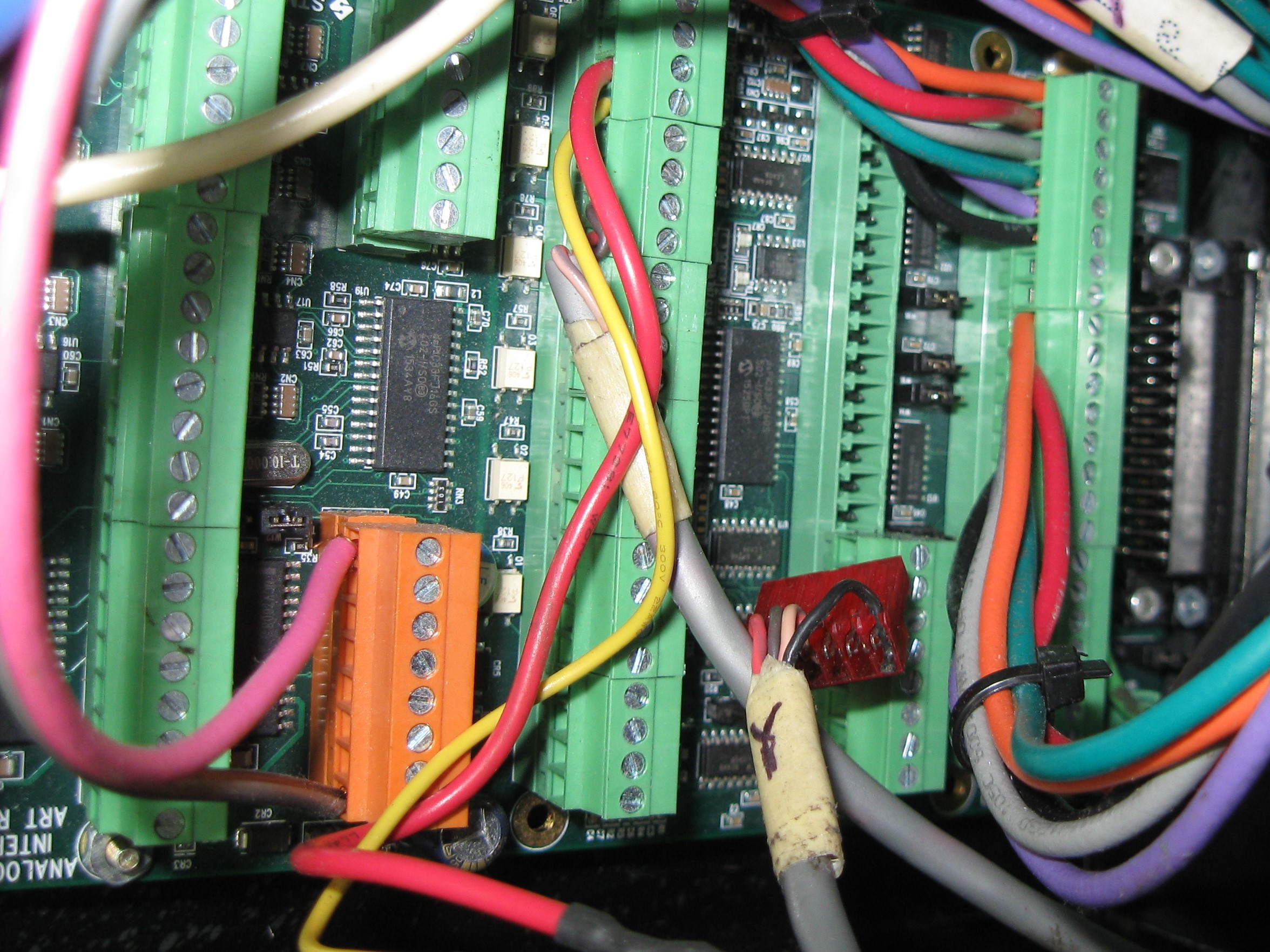

11 Oct 2020 15:00 #185720 by new2linux
This is a pic of the 7i77 card and the encoder. The encoder is the single ended type w/o differential.
So differential encoders have additional set of Complimentary or “mirror image” signals to reduce "electrical noise".
11 Oct 2020 17:32 #185732 by OT-CNC
Are you connecting the encoder back to the drive or only to the 7i77?
Something needs to feed back to the amc is what we are trying to tell you.
The prototracks I have used (90's vintage) had an encoder added to the table. Small toothed wheel that would make an indent in the cast iron table, essentially creating a rack and pinion on a small scale that would count position. That encoder (Trak senor), if it works, you could use to read into linuxcnc (hook up to the 7i77 provided it's 5v ttl encoder?) and connect the motor encoder to the the amc.

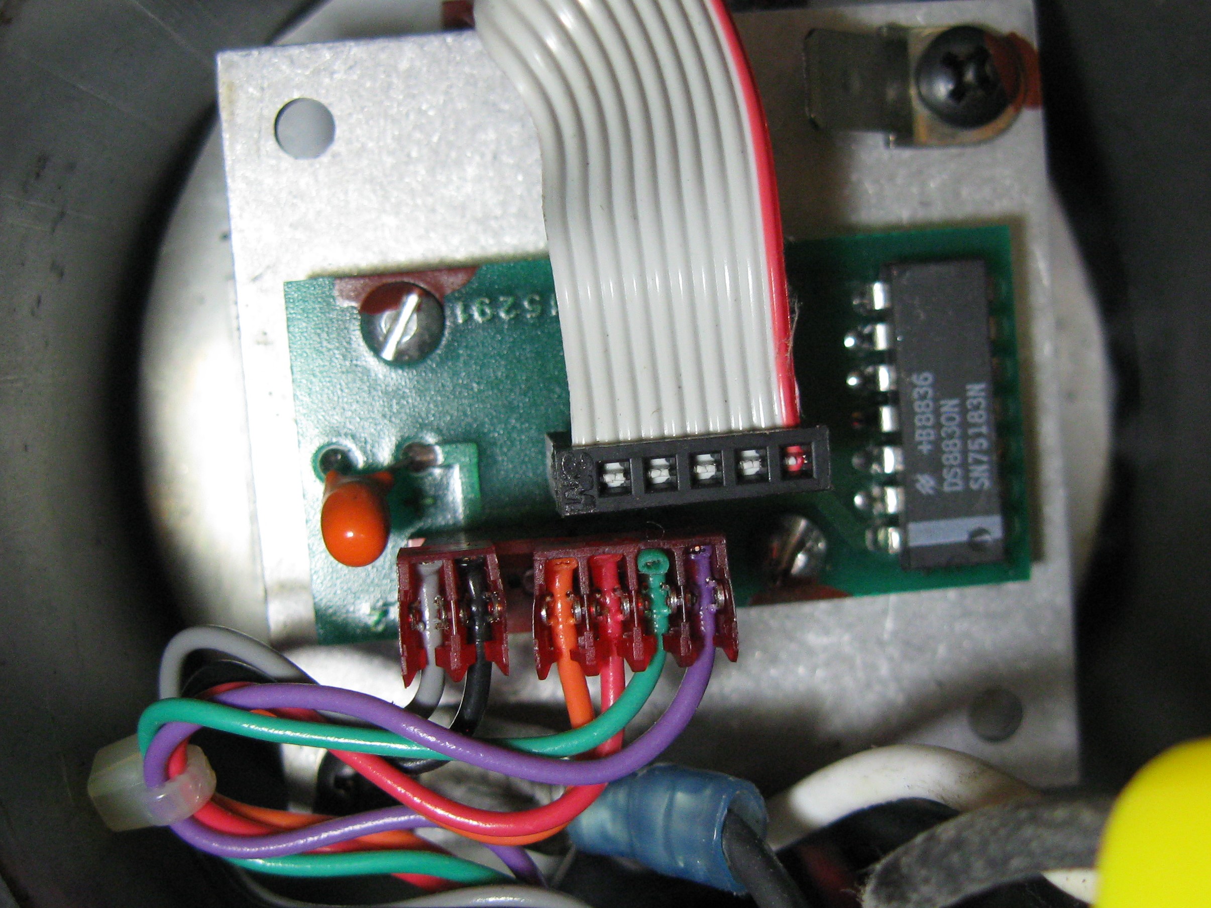

12 Oct 2020 13:58 - 12 Oct 2020 18:52 #185841 by new2linux
OT-CNC Many thanks, for your help, I am very grateful. I understand what you are saying and how the original worked. I have tried to reproduce/duplicate my instillation up to this is a prior screen shot, earlier in this very same post, dated: (06 Oct 2020 19:56 Post #185128) and I am able to reproduce something close with the "y axis" but the "x axis" I believe has other issues. The pic shows what I was able to demonstrate over the weekend (spent a lot of time on just the "x axis" at set up, & testing, hoping for it to be the set up) there is a part "goofed up" because tuning was impossible and if you hold the hand wheel for the "x axis" while the motor is energized it has vibration you can feel in your hand and never becomes firm against rotation.
I believe something is "goofed up" and I need to get the part ordered, if the part is the encoder can I replace with something that makes sense.
This is "Y axis"
This is "x axis"

Edit: I swapped the motor and encoder from the "x" axis to the "y" axis and the "x" axis motor would not work with the setting that the "y" axis had moved under power. It is my belief that the encoder on the "x" axis has the issue. I was unable to tune the motor.

12 Oct 2020 23:24 #185895 by OT-CNC
Before buying a new encoder, I would load each encoder channel into halscope and compare it to the one that works to see if it indeed is faulty. Assuming they are still wired to the 7i77.
If your machine has handwheels you can move the table without powering up the motors and look for a clean square wave coming from the encoder.
If you are asking how to connect the encoder to your new drives, you should be able to just connect A and B and Ground if they get power from an external 5v (7i77). Someone correct me if I'm giving the wrong info please.
