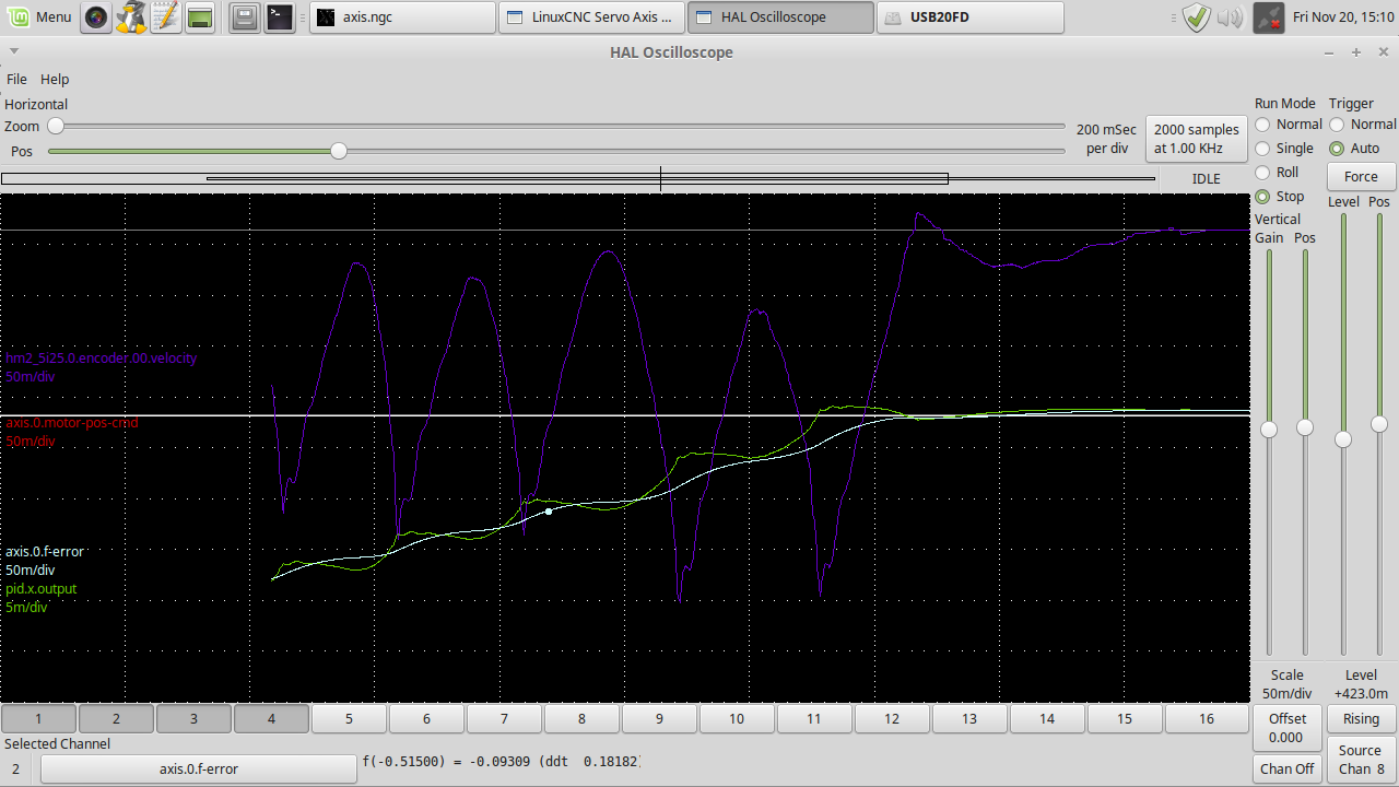

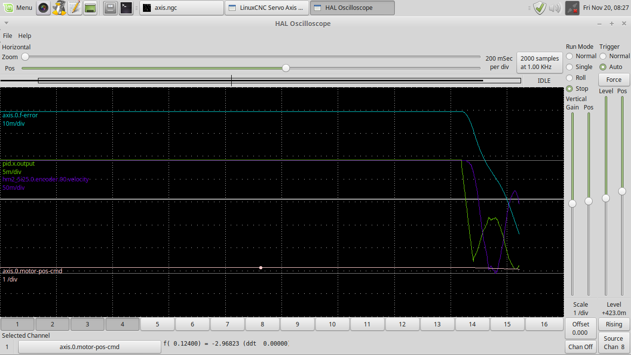

Yeesh, that's a mess. Is that P setting P=111 or P=0.111?
You triggered off of the velocity feedback not the velocity command. For Linuxcnc ver 2.7 the x-axis would be hal pin "axis.0.joint-vel-cmd". The plot of it should produce a nice semitropical trapezoid for a short move.
But regardless, It looks to me that something is backwards. Either the output scale or the direction of the servo amp or something. Because the encoder velocity seems to be doing the opposite of the PID output, when the PID output is negative, the encoder velocity goes positive.
Is there a jumper of dip switch that changes the feedback direction? try flipping that.

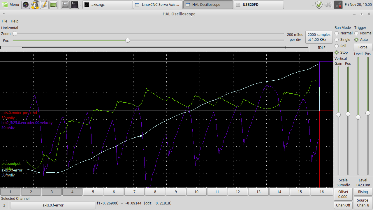

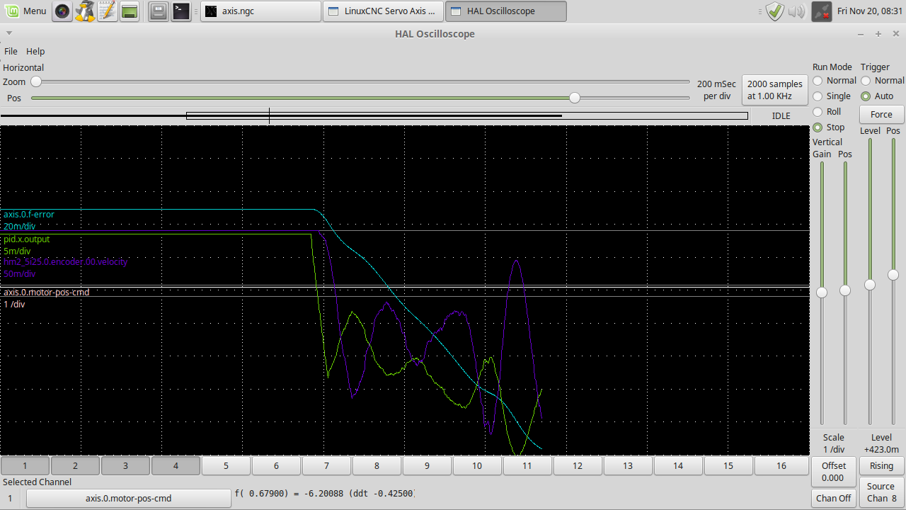

Todd, Many, many thanks!! P= 0.111; I will reset trigger just after sending this reply. You asked about a way to change "jumper of dip switch that changes the feedback direction" this is on the driver I should be investigating?
many thanks!
Edit: Attached are the pic of same settings. P;I, etc (look careful at trace settings!, I had to tweak scale between pics). In the .ini file, the f-errors are still wide open. One of the pics is the beginning of a move, the other is at the end of different move of table, but same settings.
Many thanks!
many thanks!
Many thanks!
Last edit: 20 Nov 2020 13:28 by new2linux. Reason: Pic

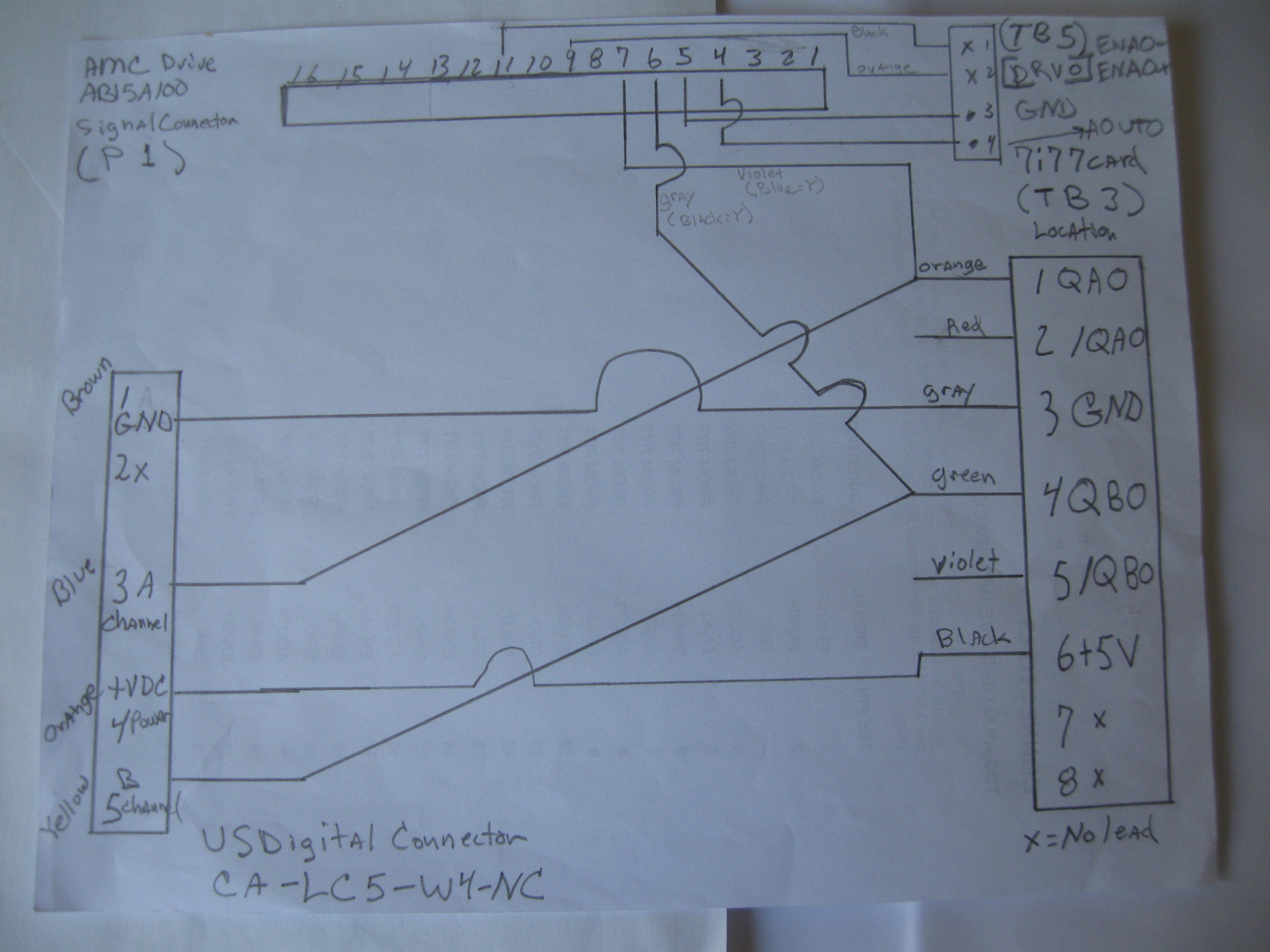

Todd, Many thanks. Attached are a few pics of the tuning with (SW1-6-OFF). This may do what you have asked about, I am not completely shore.
Pic sw1-6off1 is P 0.111; I 0.0; D .01; FF1 .001; FF2 .0001; DEADBAND .000001
Pic sw1-6 is P 0.107; I .01; D .001; FF1 .01; FF2 .001555; DEADBAND .0155
I have asked AMC about your question: Is there a dip switch that changes the feedback direction? SW1-6 goes to off.
this was the response: The fact that the drive is moving the motors in the correct direction for a given command, and that they are not running away means that the encoders are working correctly with the drive.
That makes me wonder if the encoder signal is reversed at the controller side, but I don't know anything about the Linux controller so I don't know how it connects.
Many thanks!

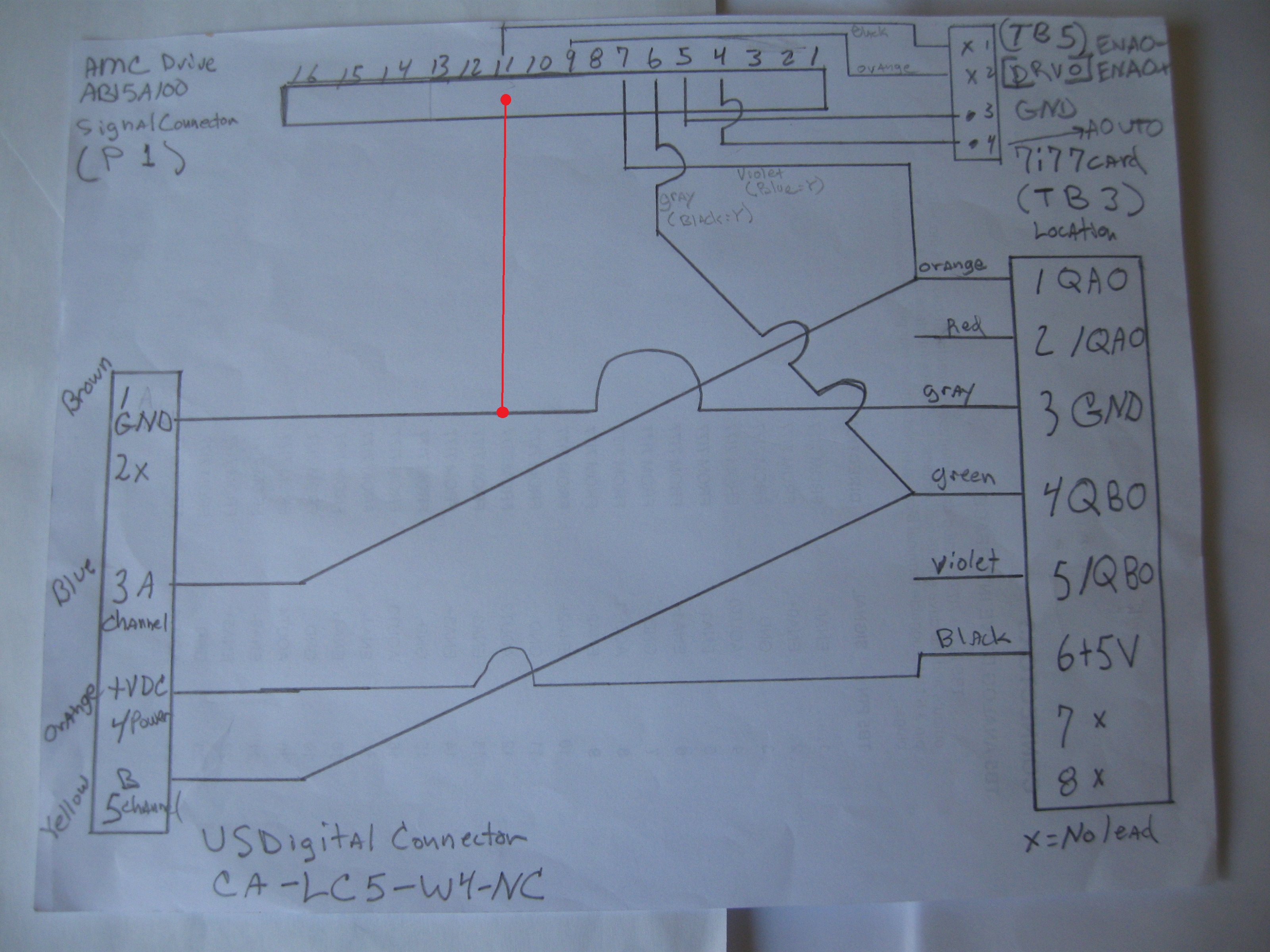

Edit: Referring to the NEW diagram attached, showing GND attached from TB3 (location 3 GND) to the drive pin 11? The diagram is not clear on the AMC (P1) connection, the pins used are pin 4 (+Ref IN); pin 5 (-Ref IN); pin 6 (Encoder B IN); pin 7 (Encoder A IN); pin 9 (INHIBIT/ENABLE); & pin 11 GND.
Edit: The "FERROR & MIN_ERROR" still has wide tolerance.

I have tried the new diagram, now no motion at all. If you try "jog" the velocity in DRO shows correctly the feed rate, but no motion. The yellow "shows the tool movement on DRO screen" does show motion, but table does not move.
Edit: SW1-6 OFF or ON = no effect
Edit: After conversation with AMC the diagram recommended is attached (I worked with this for a while) and after continuity checking for my piece of mind all checked ok, with this 1 question. The shield around the leads going to encoder are grounded to case of encoder on that end, but in the electrical control box (do not connect to 7i77 card), they stop after connecting to GND inside el cabinet. Should they go under screw 3 (GND) on TB3? see attached diagram.
many thanks
many thanks

The cable shield should only be connected at one end. (normally to a frame ground or central ground bolt at the control cabinet.) And should not be connected to any of the ground wires or terminals of the control wiring.
The above wiring diagram looks correct to me with the possible exception of there may need to be a ground reference connection between the drive and encoder/7i77.

Todd, Many thanks!! As per your suggestion I have made the changes as to add lead from under screw at TB3 contact 3; to TB5 contact 1. If SW1-6 is OFF; red LED on drives; green blink on 7i77; F1 down or up DRO works; F2 down x motor osculates and y axis motor "runs away".
If SW1-6 is ON; red LED on drives, except green while in "runs away"; green blink on 7i77; F1 down or up DRO works; F2 down "x" motor no motion (does not resist motion, ether) and y axis motor "runs away".
I have contact with AMC what should I be asking? Many thanks!
