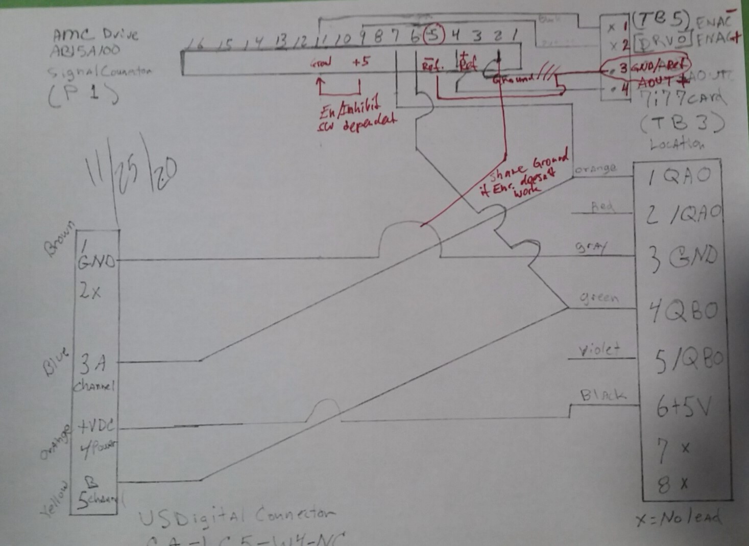

03 Dec 2020 19:13 #190975 by OT-CNC
I have been off the forum for a while and lost track of this.
Looking over your pdf, you have the analog drive connection wrong.
You need to connect the 7i77 TB5 pin3 ground (neg ref) to the AMC signal connector pin 5 -ref input. (circled in red on my attachment)
If the encoder isn't reading try connecting encoder ground with pin 2 on the AMC.
Last, I'm not entirely sure on the enable in case that is not working for you. Double check with PCW as reversing can damage your 7i77.
I marked in red what you could do with a switch pin9 to ground to enable or disable the drive (logic is dip switch dependant).
I'm going off your earlier posted AMC manual not sure if anything changed since.
Hope this helps
07 Dec 2020 20:28 - 08 Dec 2020 13:38 #191354 by new2linux
OT-CNC, Many, many thanks!! I am ever so grateful for your help, but I have sent back and asked for return of the new AB15A100s. I have a set of AB15A100 (these were from ebay, have no history, so I thought it was me when could not tune, so that is when I ordered the new AB15A100s from A-M-C that I just returned) that I would consider (the ebay ones) if you feel up for it. As if that was all that is going on, I have on the way a set of 25A8Ds with A-M-C power supply from ebay (should be here 12/13) for backup.
I am very grateful for all the wonderful people on the forum and the expertise that is so spot on. I do not want to wear out my welcome and one reason I went back to proven solution, the 12a8s, for my application.

08 Dec 2020 19:54 #191441 by OT-CNC
Edit01: Attached is diagram as I understand it, option 02 in dotted or option 01 (OT-CNC, if possible please read, what I think you have written, to see if I have it correct) pin 9 to pin 11. It will be option 1 or 2; not both. I am willing to try this just want to verify the diagram. 1st I will try this with ebay drives, to test as per earlier (AMC suggested a way to test drive w/o controller, that will turn motors both direction by POT 4) described in earlier post. If any success here and I will report back, if this fails, the 25A8Ds are on the way. Thanks!!
Yes. Not both. If I read the docs correctly, the logic is switch dependent meaning you can turn the drive off when connecting pin 9 to 11 or turn it on. You could mount an estop there for your initial testing before you connect to mesa in case you get a runaway. I assume you have the motor pulleys removed and you're not driving the table at initial setup.
