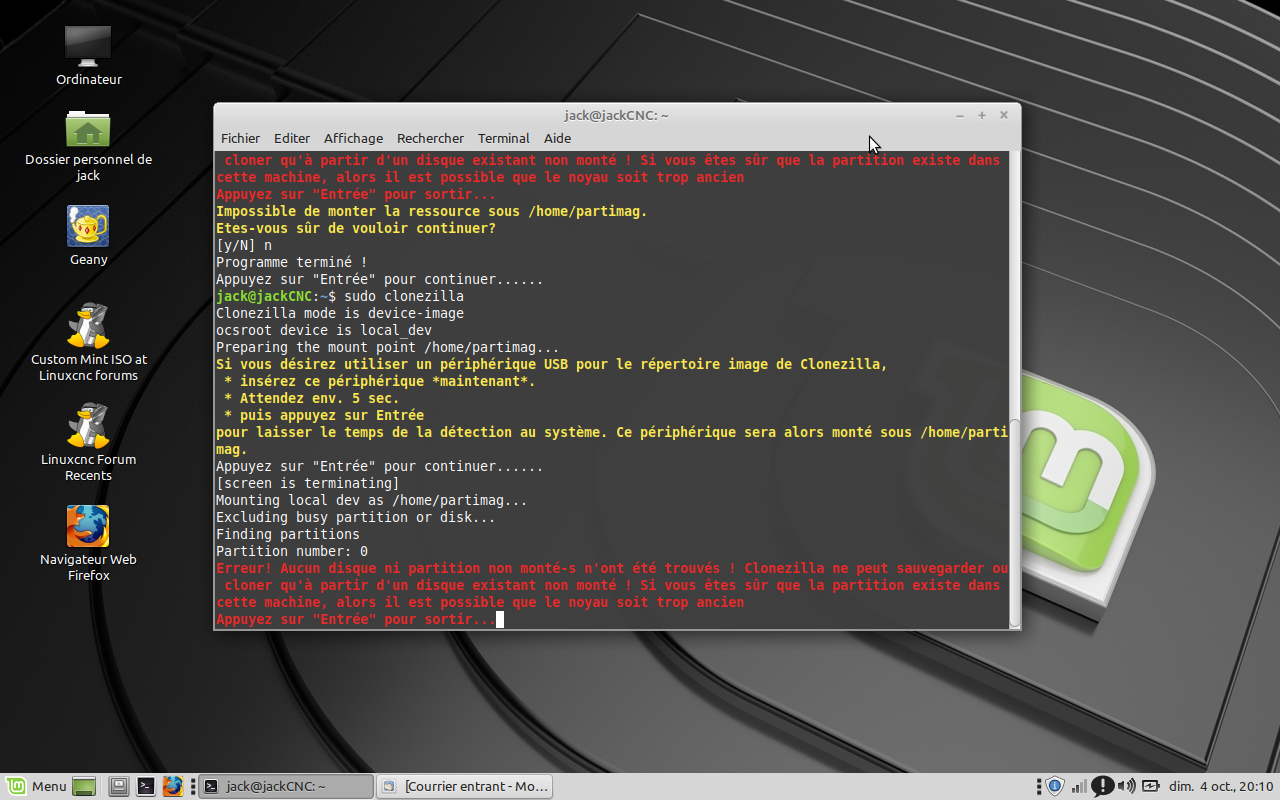

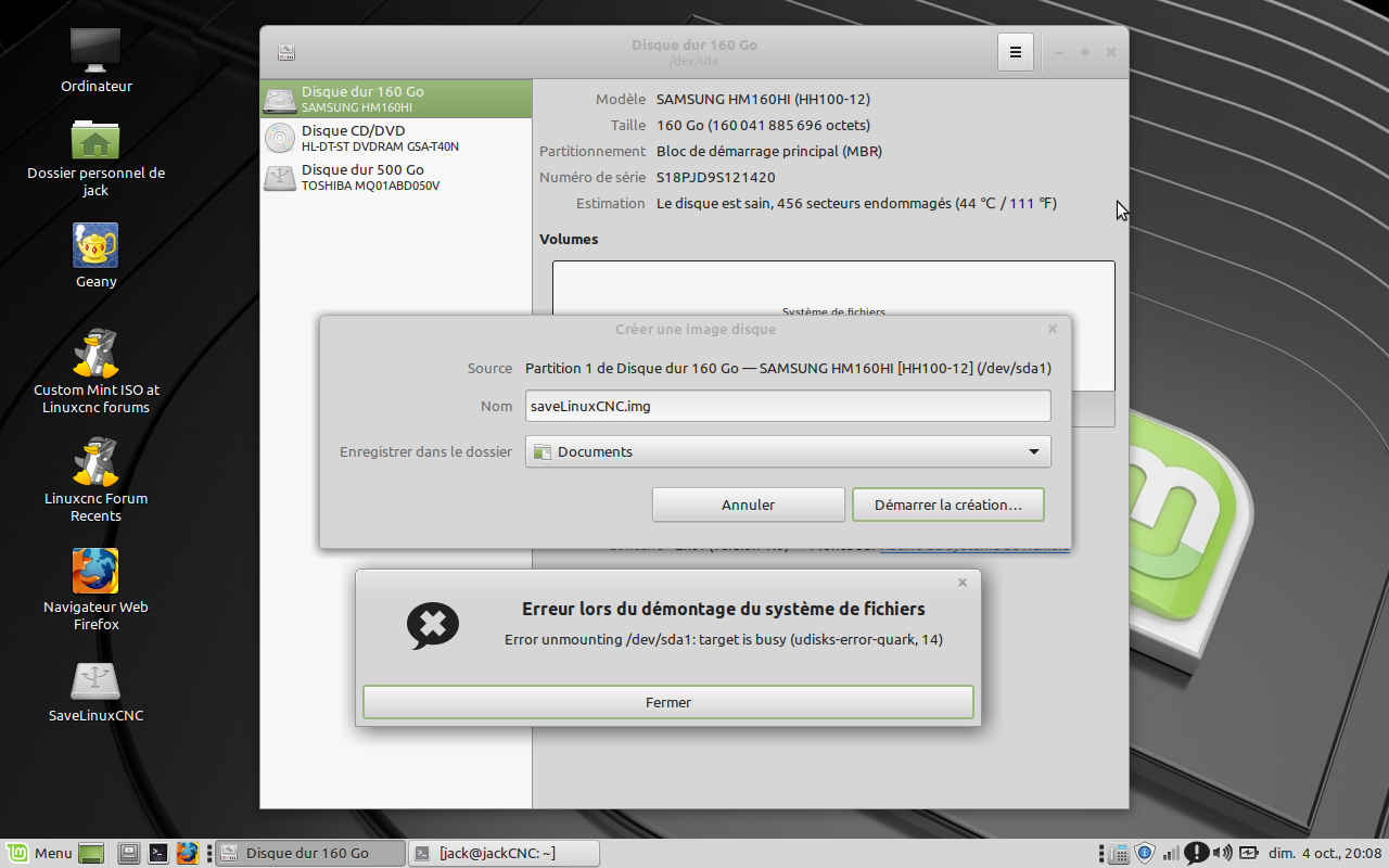

04 Oct 2020 18:24 #184861 by JackRay
Replied by JackRay on topic 5Axis Kinetic from 2.8 on 2.7x
Hello ,
So I try to save my system. I tried to install Systemback but I couldn't. could not find the packets, and file.sh does not install on linuxMint ... I tried Clonezilla, and the disk utility that came with LinuxMint, and still the same thing. it tells me that my source disk is busy.
I do not know how to do. Do you have a solution?
Thanks for your help
