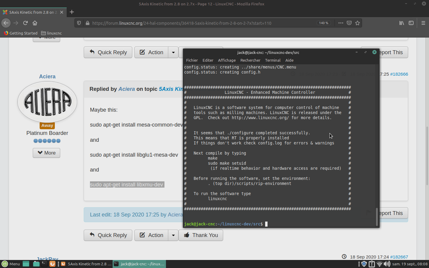

18 Sep 2020 17:23 - 18 Sep 2020 17:25 #182666
Replied by Aciera on topic 5Axis Kinetic from 2.8 on 2.7x
Maybe this:
sudo apt-get install mesa-common-dev
and
sudo apt-get install libglu1-mesa-dev
and
sudo apt-get install libxmu-dev
and
and

18 Sep 2020 17:24 #182667
by JackRay
Replied by JackRay on topic 5Axis Kinetic from 2.8 on 2.7x
and what?
- JackRay
- Posts: 226
- Thank you received: 14

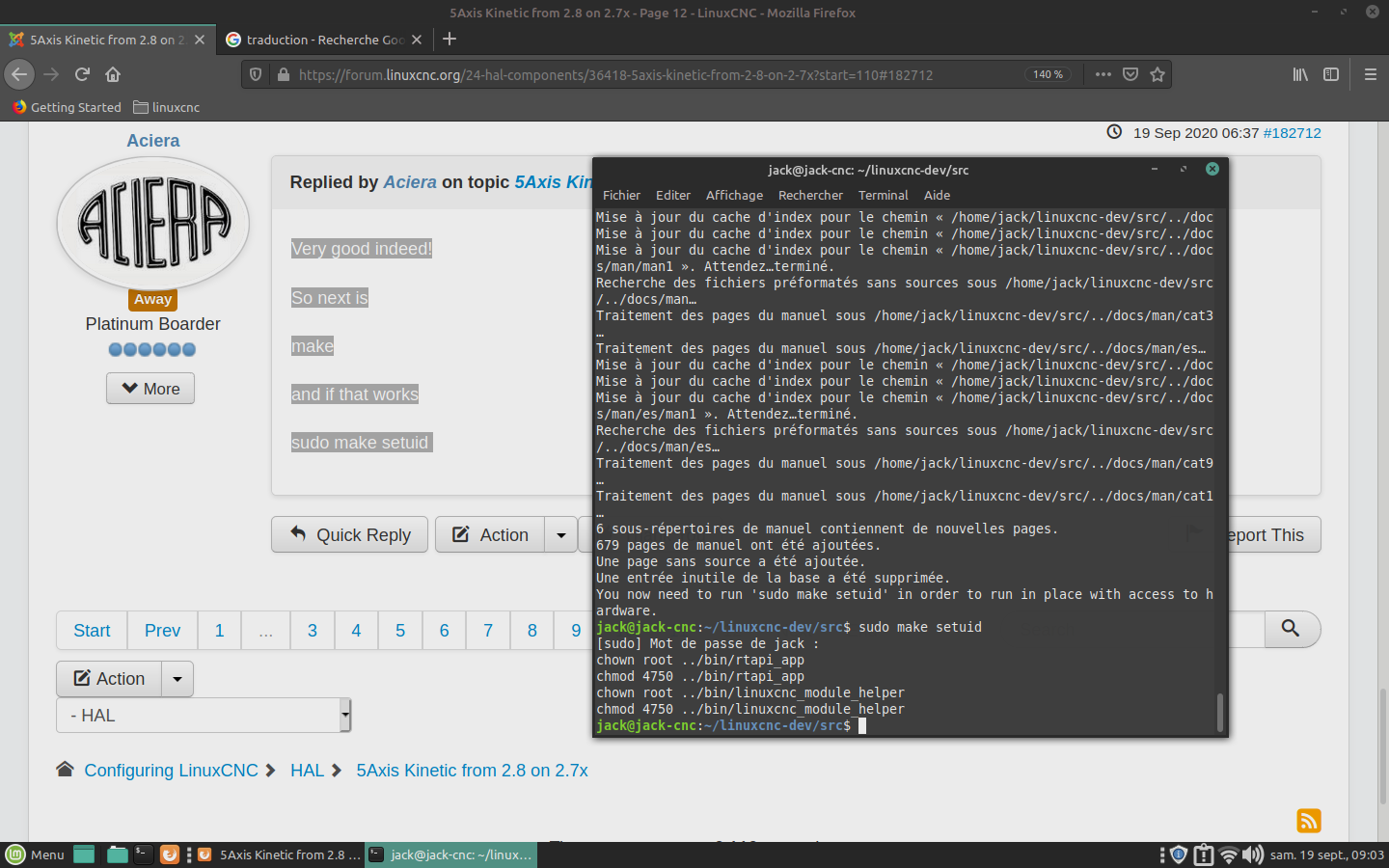

19 Sep 2020 06:10 #182710
by JackRay
- Posts: 4818
- Thank you received: 2176
19 Sep 2020 06:37 #182712
Very good indeed!
So next is
make
and if that works
sudo make setuid
So next is
make
and if that works
sudo make setuid

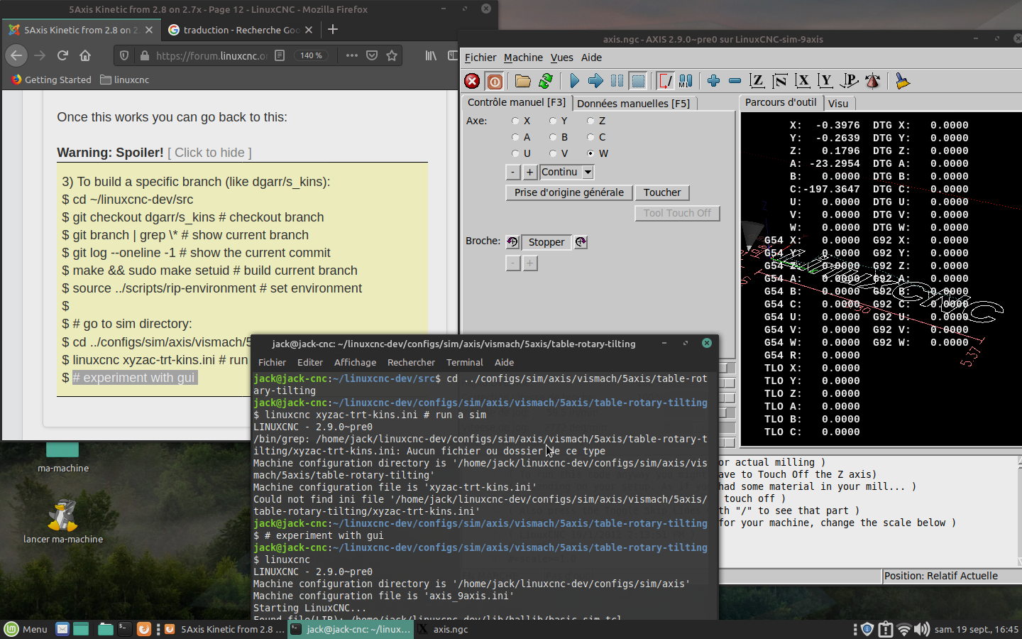

19 Sep 2020 11:40 #182733
If all went well you should be able to start your RIP install:
source ../scripts/rip-environment
cd ..
linuxcnc
Once this works you can go back to this:
cd ..
linuxcnc
Warning: Spoiler!
3) To build a specific branch (like dgarr/s_kins):
$ cd ~/linuxcnc-dev/src
$ git checkout dgarr/s_kins # checkout branch
$ git branch | grep \* # show current branch
$ git log --oneline -1 # show the current commit
$ make && sudo make setuid # build current branch
$ source ../scripts/rip-environment # set environment
$ # go to sim directory:
$ cd ../configs/sim/axis/vismach/5axis/table-rotary-tilting
$ linuxcnc xyzac-trt-kins.ini # run a sim
$ # experiment with gui
