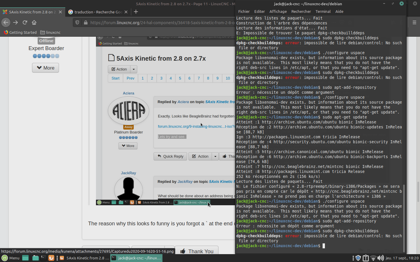

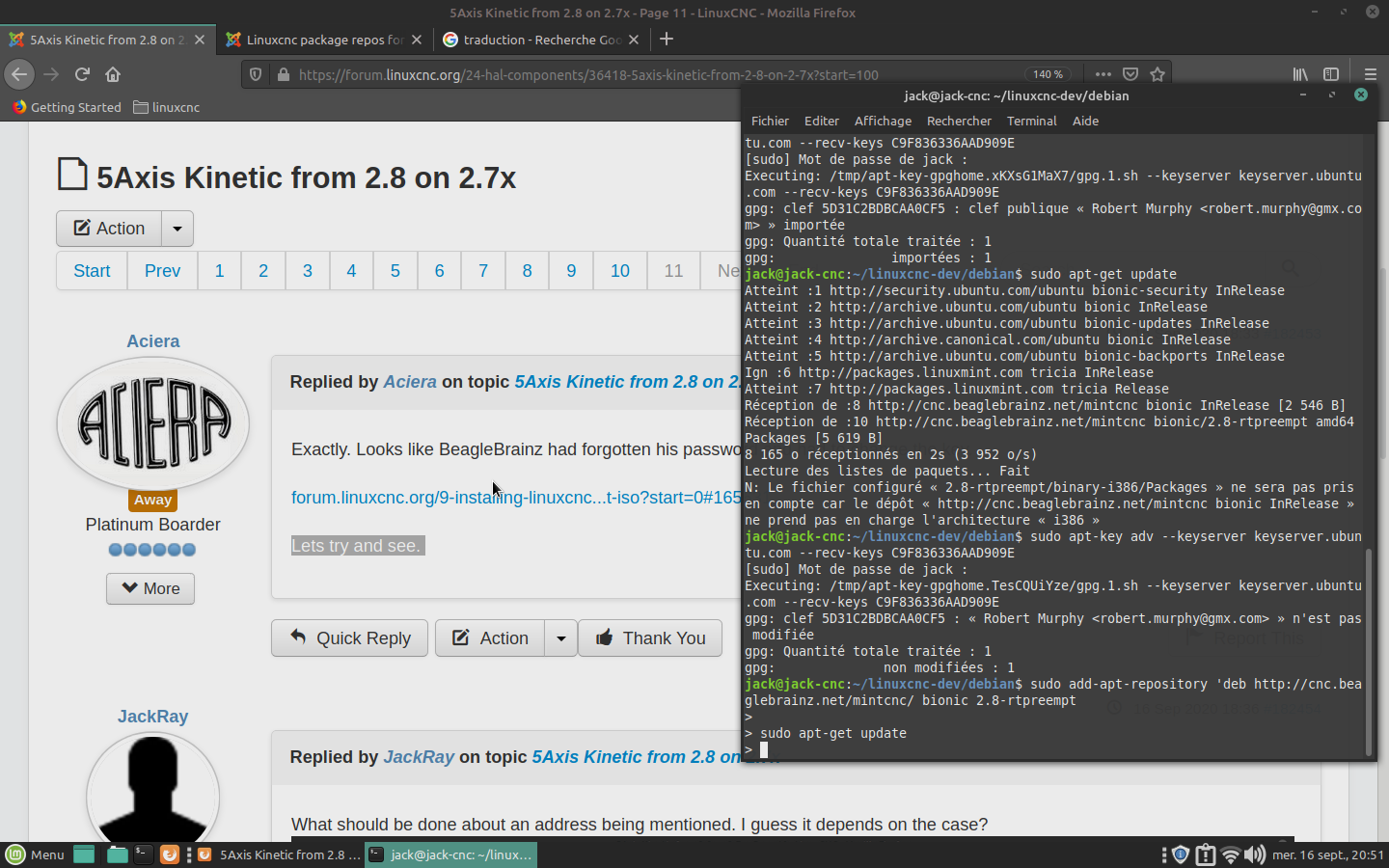

Replied by Aciera on topic 5Axis Kinetic from 2.8 on 2.7x
Exactly. Looks like BeagleBrainz had forgotten his password and had to change the key.
forum.linuxcnc.org/9-installing-linuxcnc...t-iso?start=0#165631
Lets try and see.
Lets try and see.

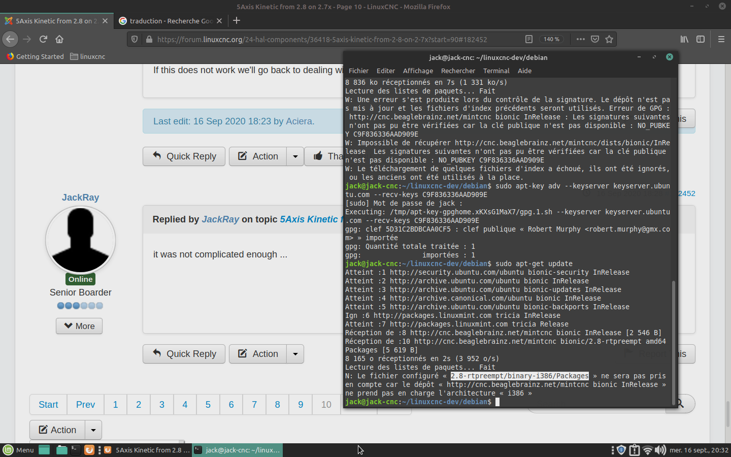

16 Sep 2020 20:52 #182473
Replied by tommylight on topic 5Axis Kinetic from 2.8 on 2.7x
Last line should be
sudo apt-add-repository

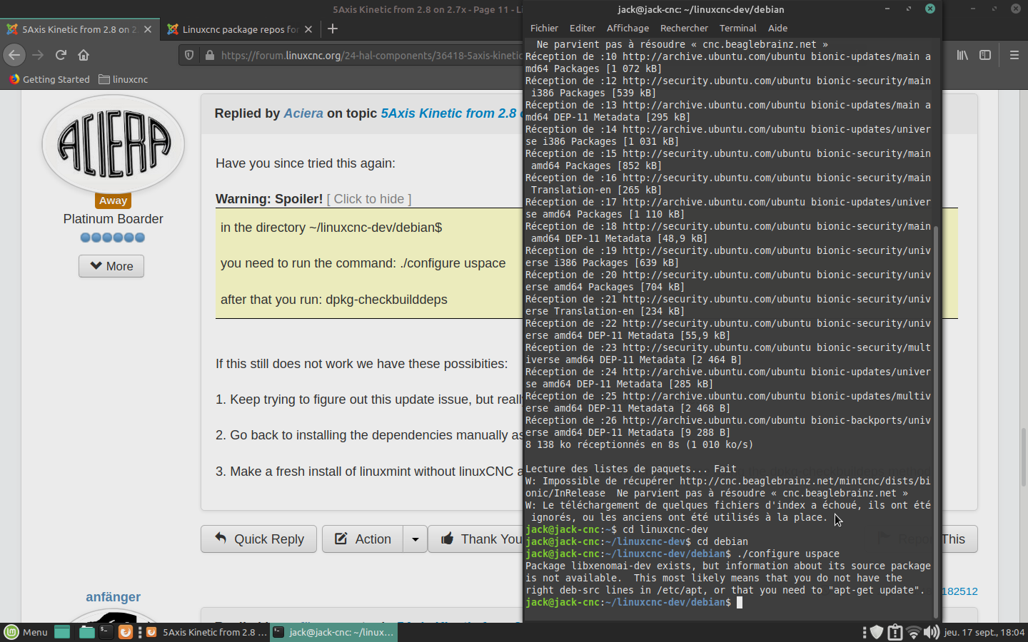

17 Sep 2020 05:34 #182506
Have you since tried this again:
If this still does not work we have these possibities:
1. Keep trying to figure out this update issue, but really I'm running out of ideas here.
2. Go back to installing the dependencies manually as we were before.
3. Make a fresh install of linuxmint without linuxCNC and install LinuxCNC from source using the dpkg-checkbuildeps method.
Warning: Spoiler!
in the directory ~/linuxcnc-dev/debian$
you need to run the command: ./configure uspace
after that you run: dpkg-checkbuilddeps

The reason why this looks fo funny is you forgot a ` at the end of the repository so the Command wasn‘t executed.
Replied by anfänger on topic 5Axis Kinetic from 2.8 on 2.7x
I do not understand what is happening. the path has disappeared, the update does not change ???

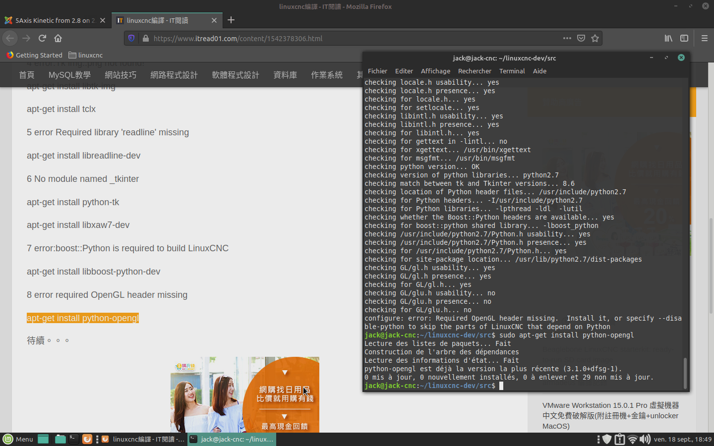

18 Sep 2020 05:33 - 18 Sep 2020 05:45 #182611
Ok, lets just get back to the route we were on before.
So go back to
> cd linuxcnc-dev/src
> ./autogen.sh
> ./configure --with-realtime=uspace
If you get the error: error: required OpenGL header missing
Try:
apt-get install python-opengl
[edit]
Found a short list of possible errors and the packages to install:
www.itread01.com/content/1542378306.html
So go back to
> cd linuxcnc-dev/src
> ./autogen.sh
Try:
[edit]
