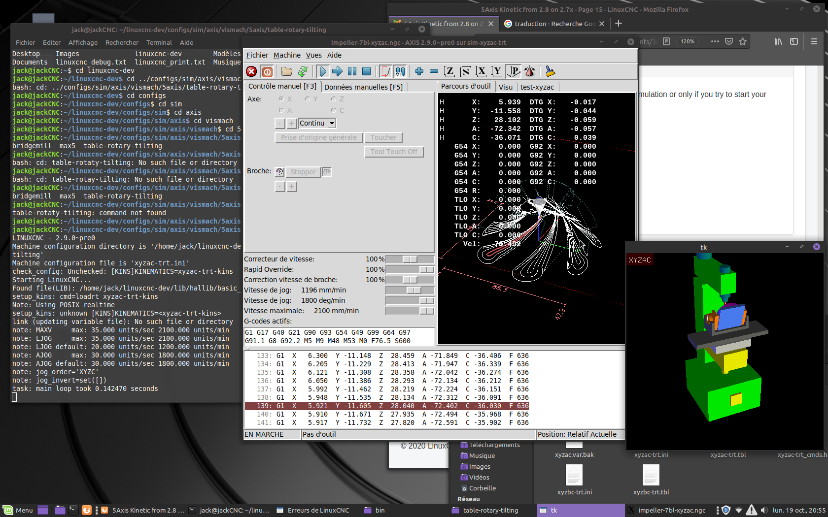

i tried your suggestion, as you can see it works, but i still can't start my configuration ...

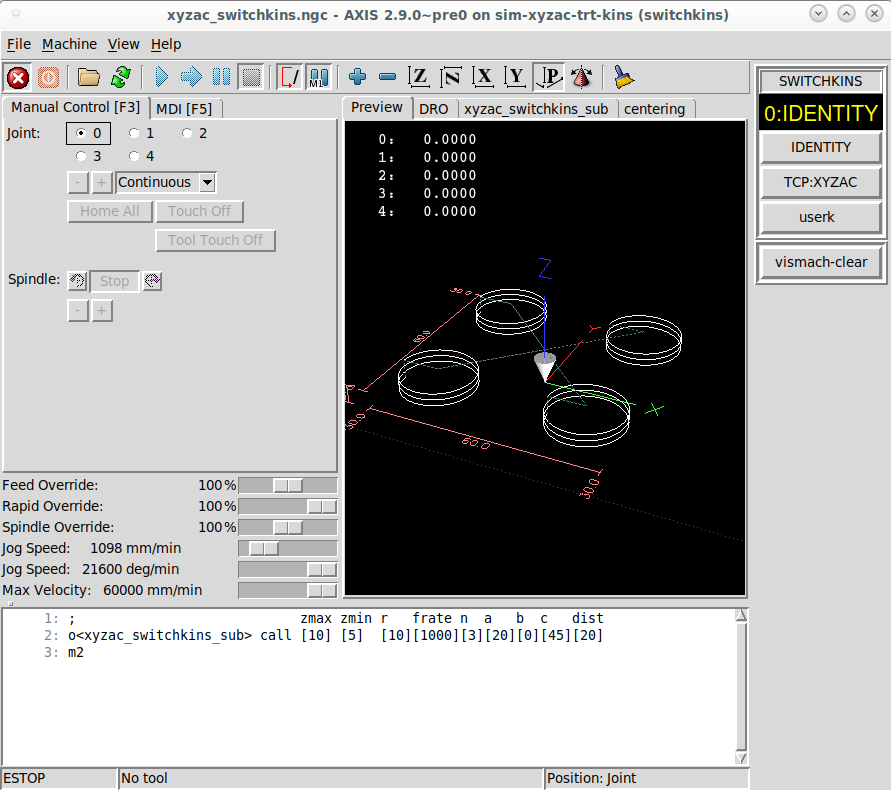

Actually I still have doubts that you are indeed running switch-kins-branch as there is no reference to it in the terminal output.
Have you tried to switch kinematics in the simulation?
If you can use M428 and M429 to switch betwee identity and 5axis-trt-kins in the simulation then you know you have it setup correctly.

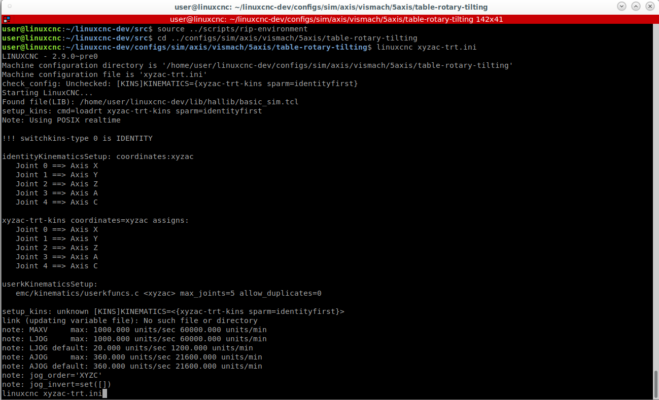

So, it seems that you have not actually built the switchkins-branch because I just built the switchkins-branch and when I do:
user@linuxcnc:~/linuxcnc-dev/configs/sim/axis/vismach/5axis/table-rotary-tilting$ linuxcnc xyzac-trt.ini
I get this:
I suggest you do this and try again:
I get this:
3) To build a specific branch (like dgarr/s_kins):
$ cd ~/linuxcnc-dev/src
$ git checkout dgarr/s_kins # checkout branch
$ git branch | grep \* # show current branch
$ git log --oneline -1 # show the current commit
$ make && sudo make setuid # build current branch
$ source ../scripts/rip-environment # set environment
$ # go to sim directory:
$ cd ../configs/sim/axis/vismach/5axis/table-rotary-tilting
$ linuxcnc xyzac-trt.ini # run a sim
$ # experiment with guiAttachments:

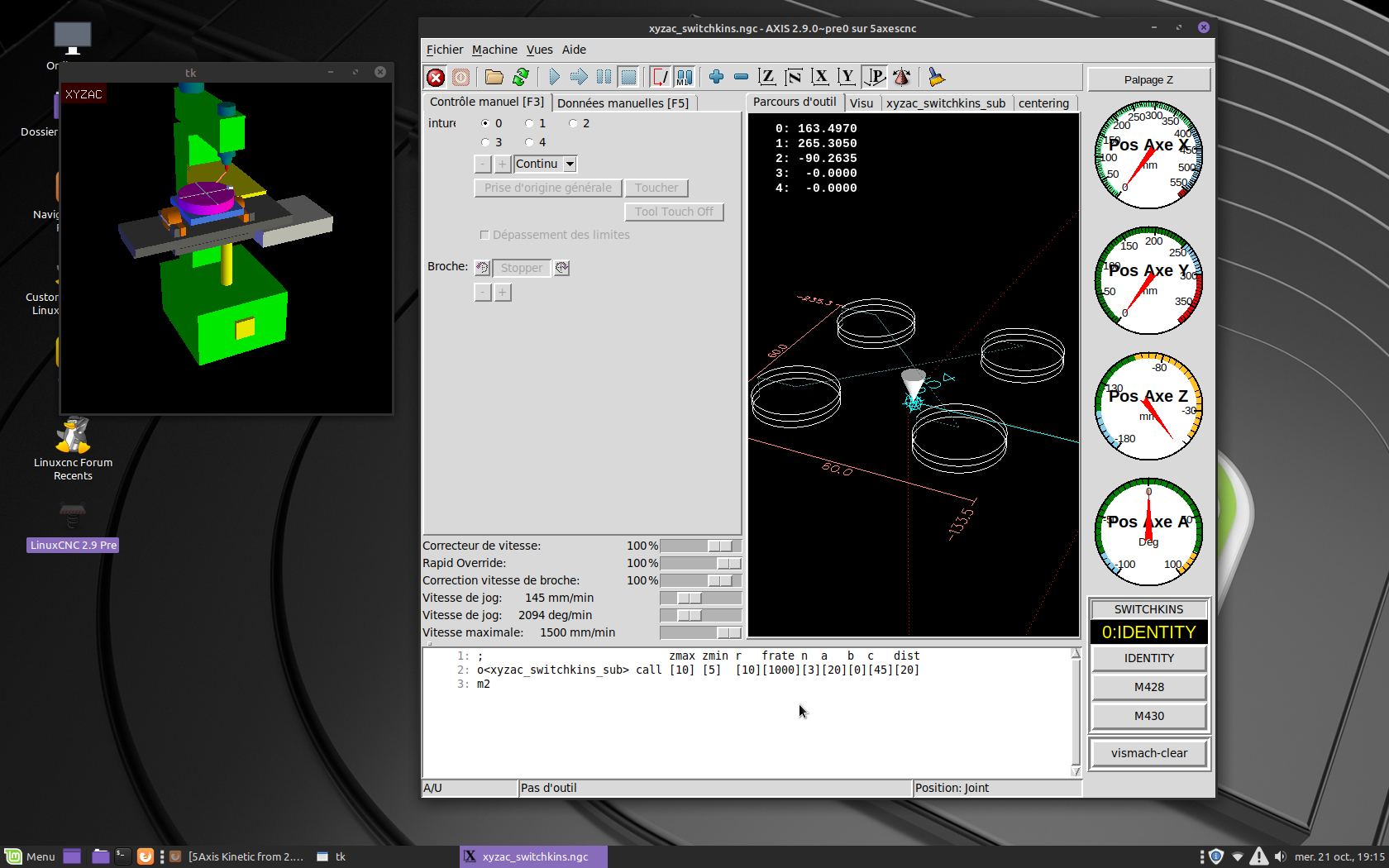

Hello
it works great, thanks a lot for your help. I didn't understand anything, but it works very well now. Thank you again for your help .
