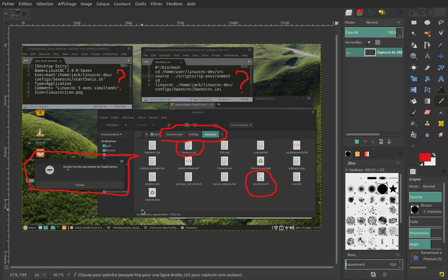

Replied by Aciera on topic 5Axis Kinetic from 2.8 on 2.7x
Remember you now work with a Run in Place installation. So when you create the launcher on your desktop you need to set the environment just like you do when using a terminal.
I have a start-script.sh in my config folder (5-Vertikal-XYZAB-Switch) that sets the environment and starts my machine (Vertikal-XYZAB-Switch.ini):
Then the icon on the desktop calls the script:
Warning: Spoiler!
#!/bin/bash
cd /home/user/linuxcnc-dev/src
source ../scripts/rip-environment
cd ..
linuxcnc ./configs/5-Vertikal-XYZAB-Switch/Vertikal-XYZAB-Switch.ini
cd ..
Warning: Spoiler!
[Desktop Entry]
Name=Vertikal-XYZAB-Switch
Exec=bash '/home/user/linuxcnc-dev/configs/5-Vertikal-XYZAB-Switch/start-script.sh'
Type=Application
Comment=
Icon=/home/user/linuxcnc/pics_icons/Images/Vertikal-XYZAB.ico
Type=Application

In your start5axis.sh try
linuxcnc ./config/5axescnc/5axescnc.ini
The dot at the beginning is telling it to look for the file in the folder it is currently in. So in your case it looks for a directory called "home" in ~/linuxcnc-dev/ which does not exist.
resources.esri.com/help/9.3/ArcGISDeskto...tive_unc_and_url.htm

20 Sep 2020 11:03 #182874
by JackRay
Replied by JackRay on topic 5Axis Kinetic from 2.8 on 2.7x
OK thanks a lot ,
So now I can set up my switchkins in my .ini / .hal files.
I will try to find the documentation, we have done so much between ...
Would you please have documentation concerning the calculation of the "Offest" axes in order to determine the pivot point manually. The documentation I have is not reliable.
Thank you
