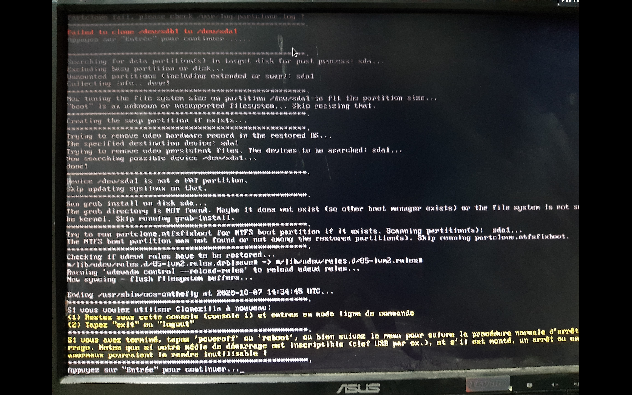

07 Oct 2020 16:19 #185273
by JackRay
Replied by JackRay on topic 5Axis Kinetic from 2.8 on 2.7x
Hello,
I am doing exactly the same as you, and it works on my laptop PC but not on the CNC machine PC. I have this message.
When do you think ?
Thank you
When do you think ?
Thank you

07 Oct 2020 16:34 #185276
by JackRay
- Posts: 21962
- Thank you received: 7478
07 Oct 2020 16:46 #185281
Replied by tommylight on topic 5Axis Kinetic from 2.8 on 2.7x
You are trying to clone one partition to another on the SAME drive !
Please read the instructions on using Clonezilla.

13 Oct 2020 17:25 #186005
by JackRay
Hello ,
No, I made a block-by-block copy. I think I have a problem with my hard drive. This solution works well as long as keeps the same PC. Unable to install image on another PC. it does not work .
I have a question, has anyone in the community tried to make an image (bootable .iso file from version 2.9pre like it was done on version 2.8?
Thank you
Thank you

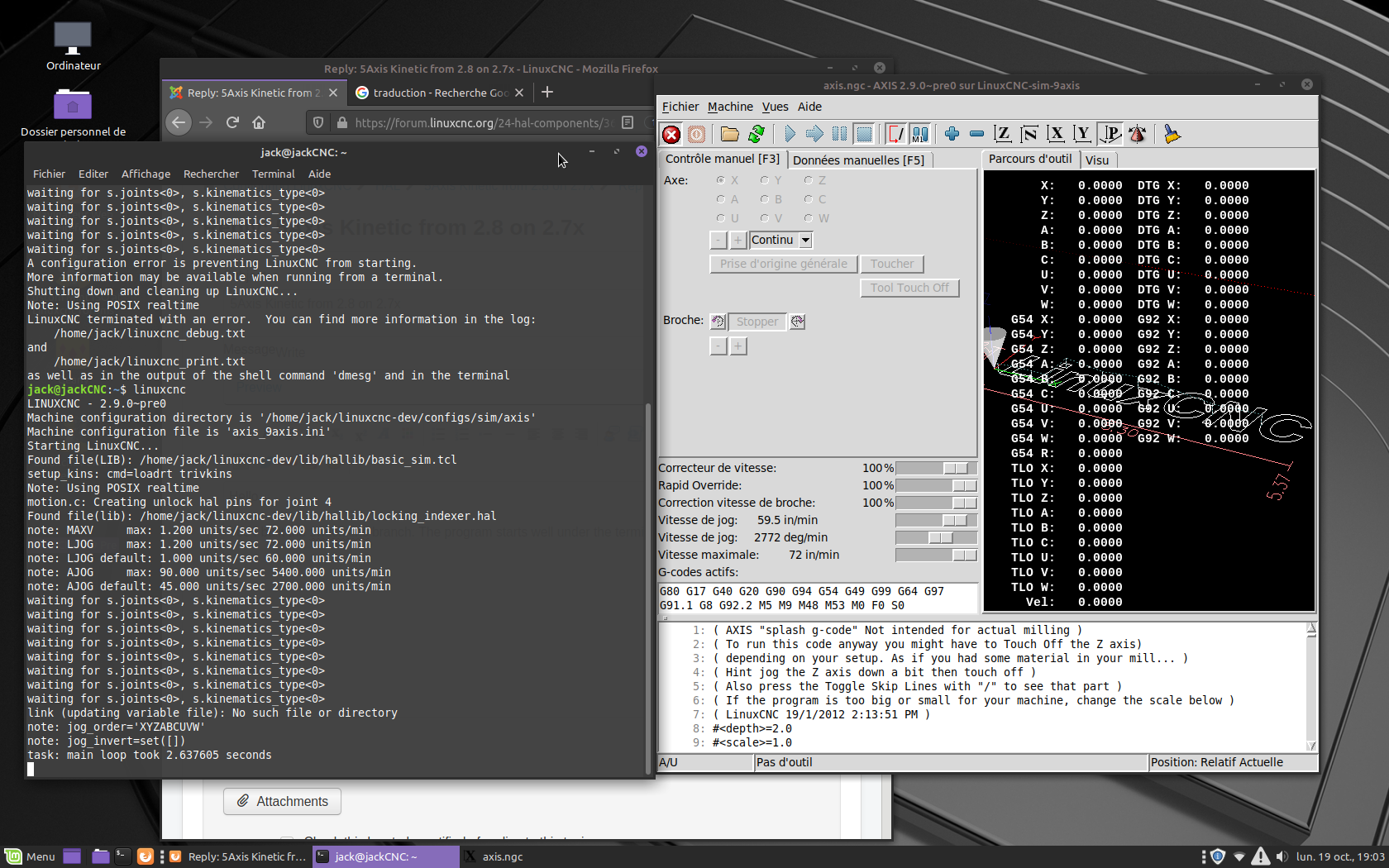

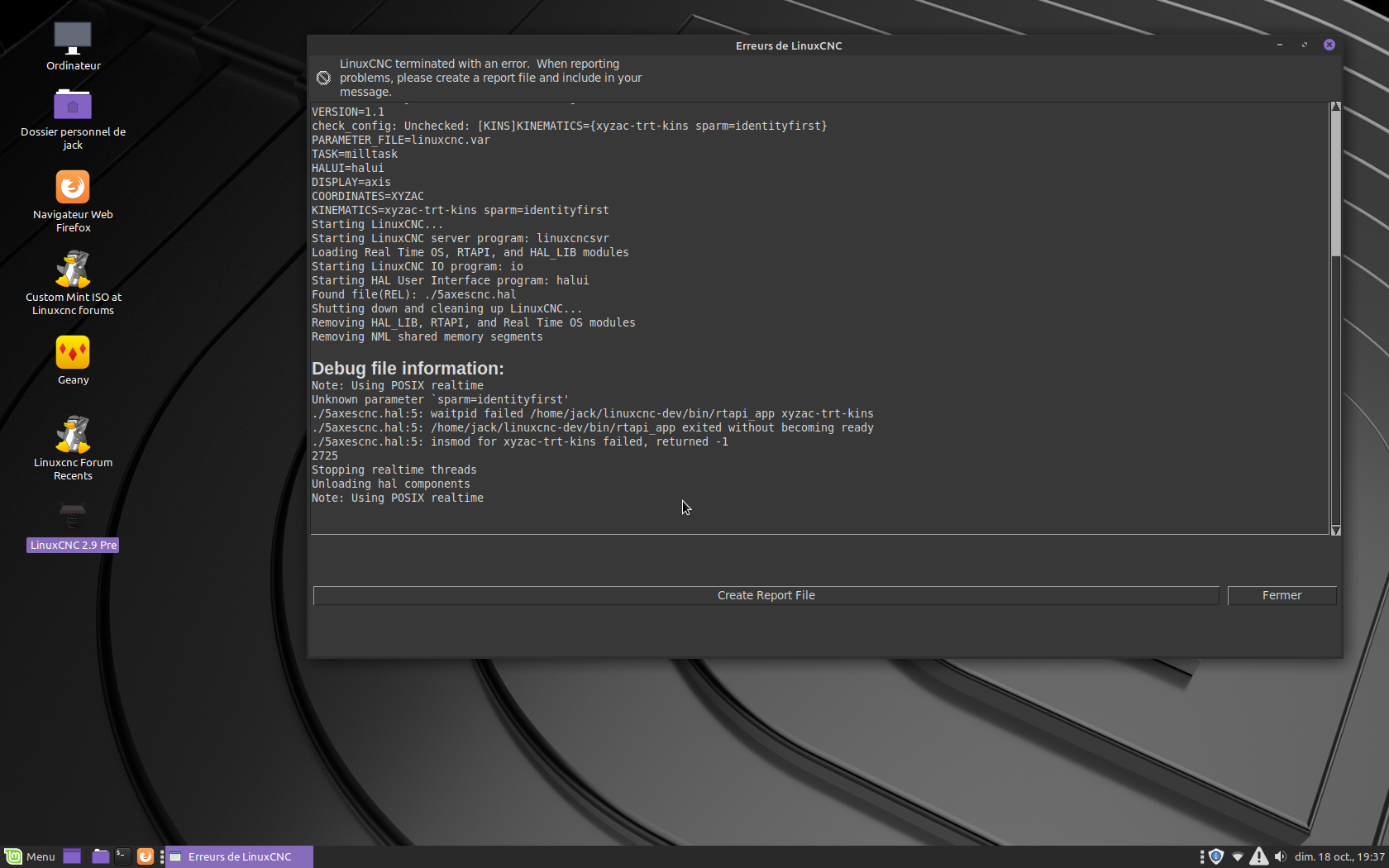

18 Oct 2020 17:42 #186479
by JackRay
- Posts: 4818
- Thank you received: 2176
18 Oct 2020 17:56 #186481
Replied by Aciera on topic 5Axis Kinetic from 2.8 on 2.7x
It tells you "Unknown parameter 'sparm=identityfirst'".
Have you built the switchkins-branch?
Note that sparm=identityfirst is used in the switchkins-branch to get linuxcnc to start the config using the indentitiy kinematics.
If you are already using the switchkins-branch. Then maybe delete sparm=identityfirst and try again.

19 Oct 2020 17:04 #186593
by JackRay
- Posts: 4818
19 Oct 2020 17:23 - 19 Oct 2020 17:40 #186595
So do you get the error when you try to start the 5axis-trt-kins simulation or only if you try to start your own machines config?
Have you set the environment correctly?
$ cd ~/linuxcnc-dev/src
$ source ../scripts/rip-environment
Do that and run the simulation
$ cd ../configs/sim/axis/vismach/5axis/table-rotary-tilting
$ linuxcnc xyzac-trt.ini
