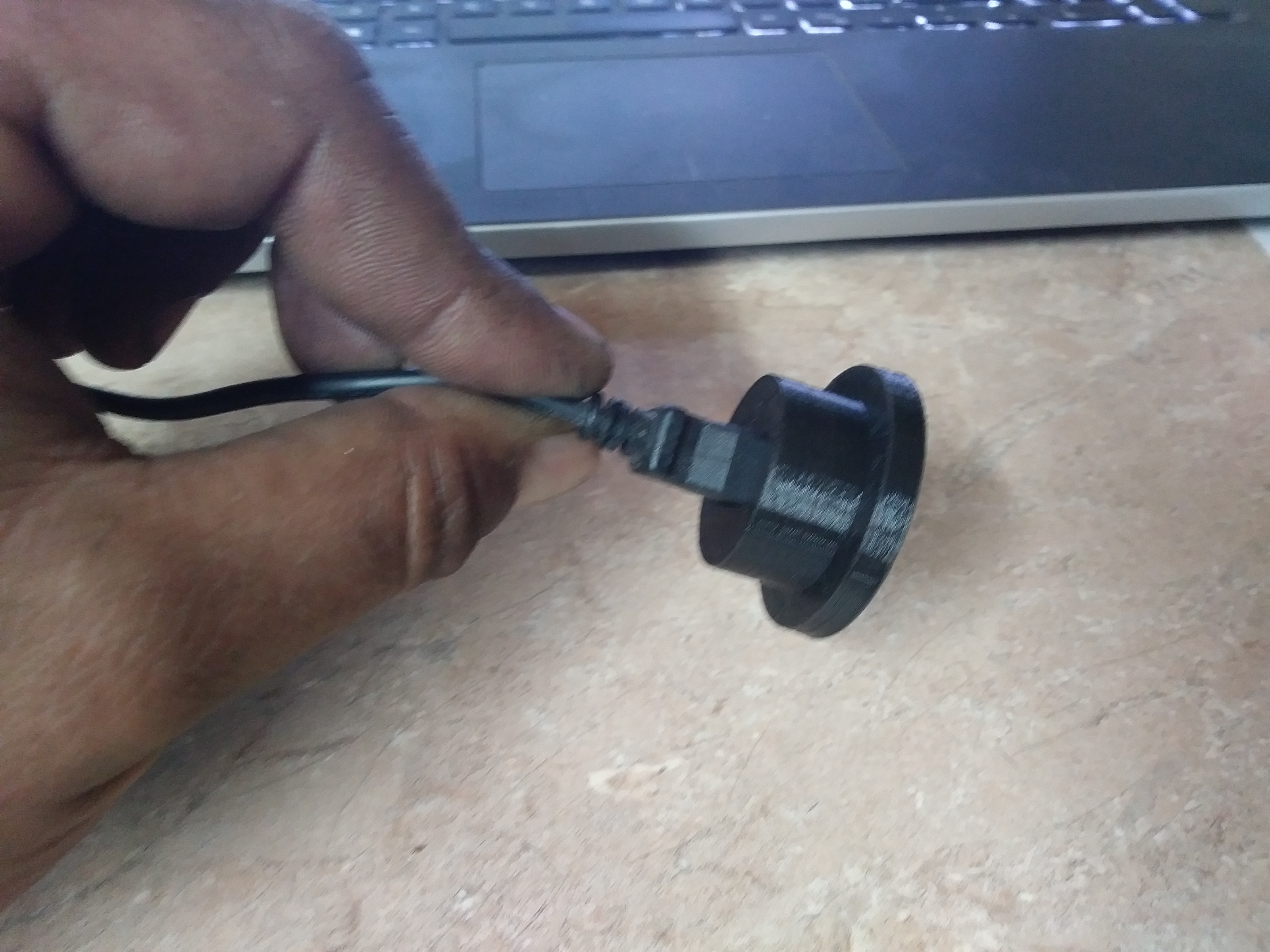

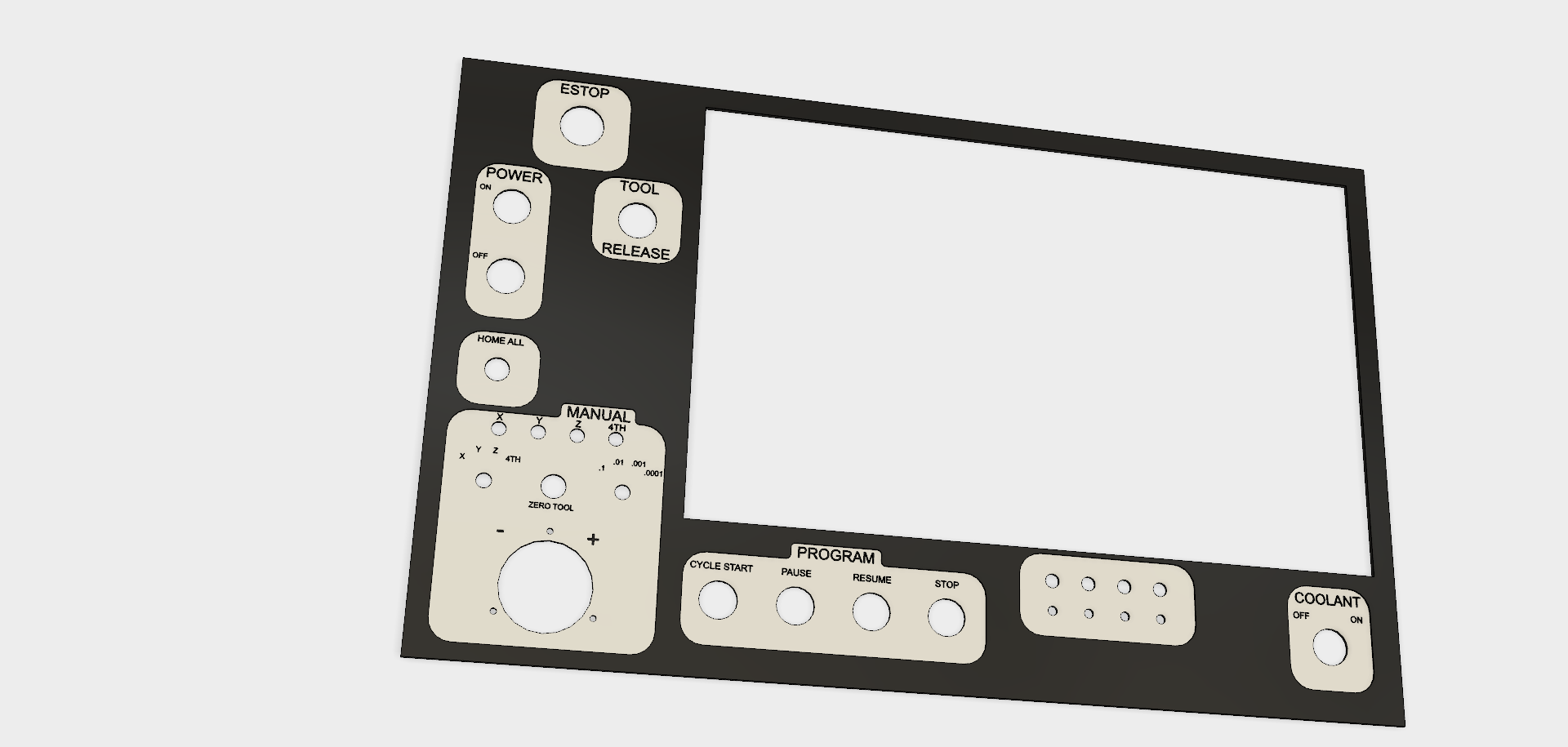

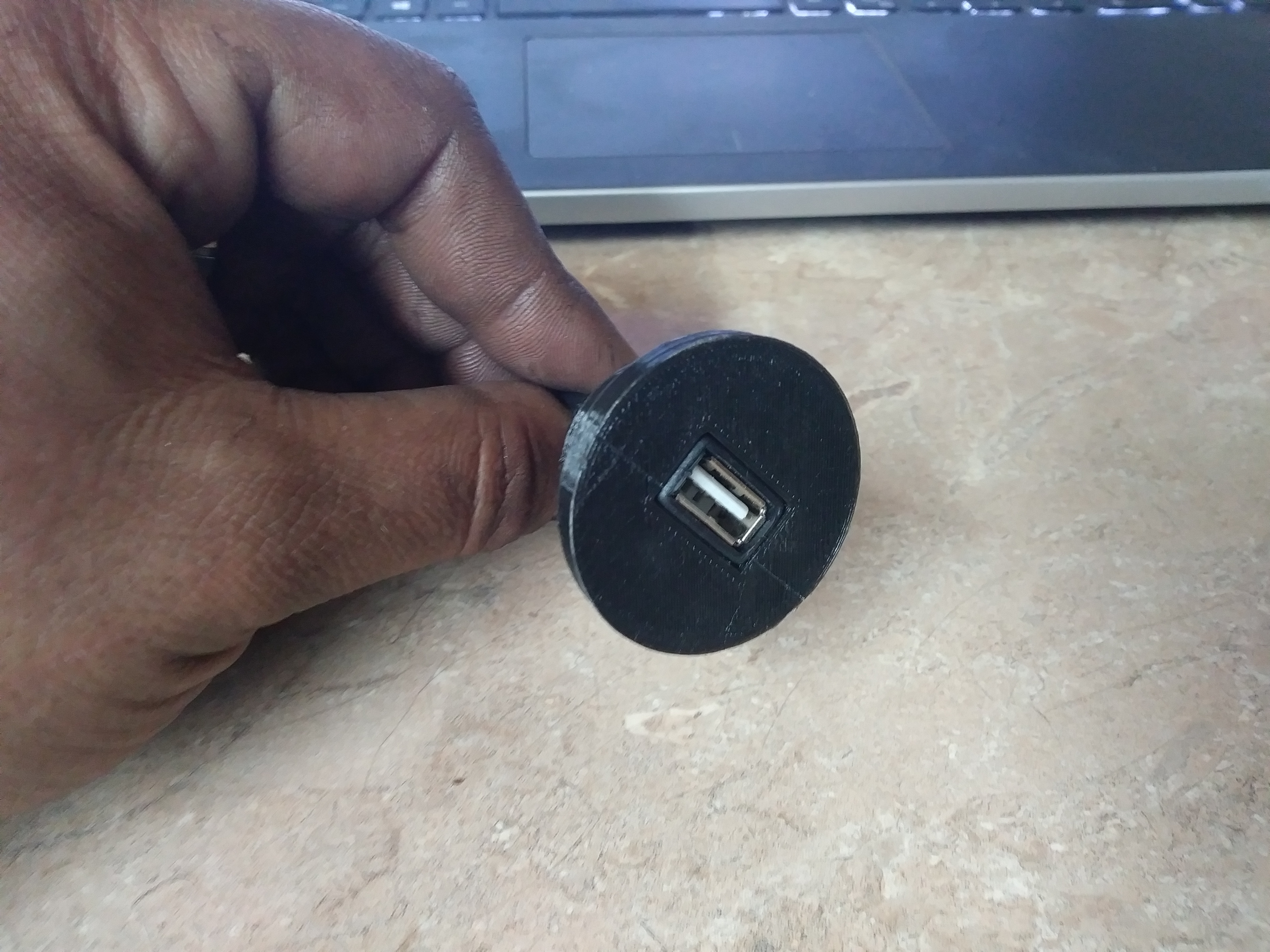

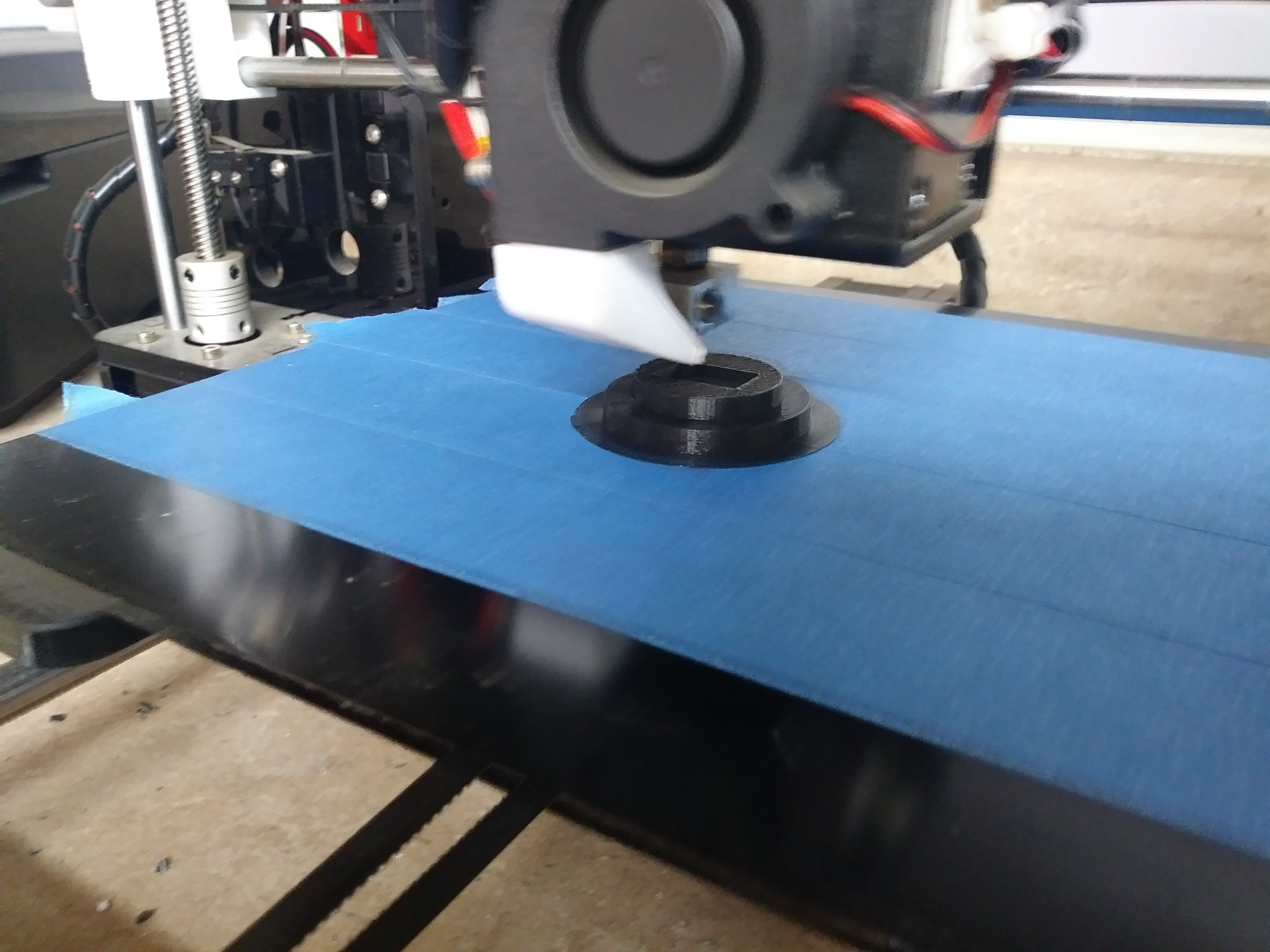

Working on getting the control panel done. Used all the old switches and LED from the old controls. I did find a used Fanuc 5v jog wheel so decided to buy it and put it on here instead of the 24v one that came with the mill. Little bit more progress I guess as I 3d print out a USB mount for a panel mounted usb port.
Using everything I have sitting around to put this control panel together.

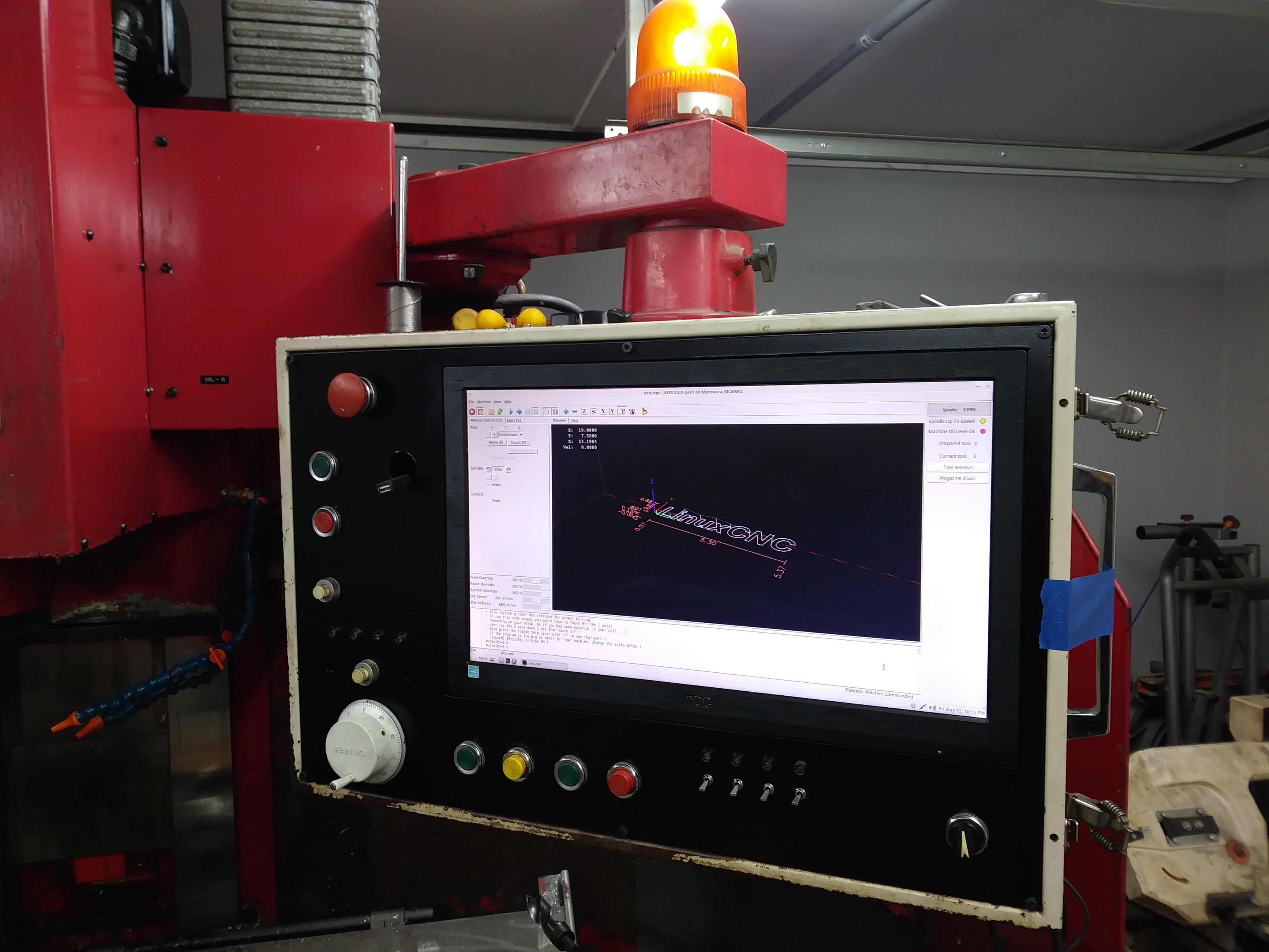

Made a little more progress on the mill. Had a few things go on that were giving me tons of grief, but the users on the IRC channel helped walk me through them. Turns out that they were just small things such as bad ground, signal names changes (happened at some point during different versions of lcnc) and basic things like that. I am pretty close to finishing the mill now.
This for some reason has be all sorts of excited.....
