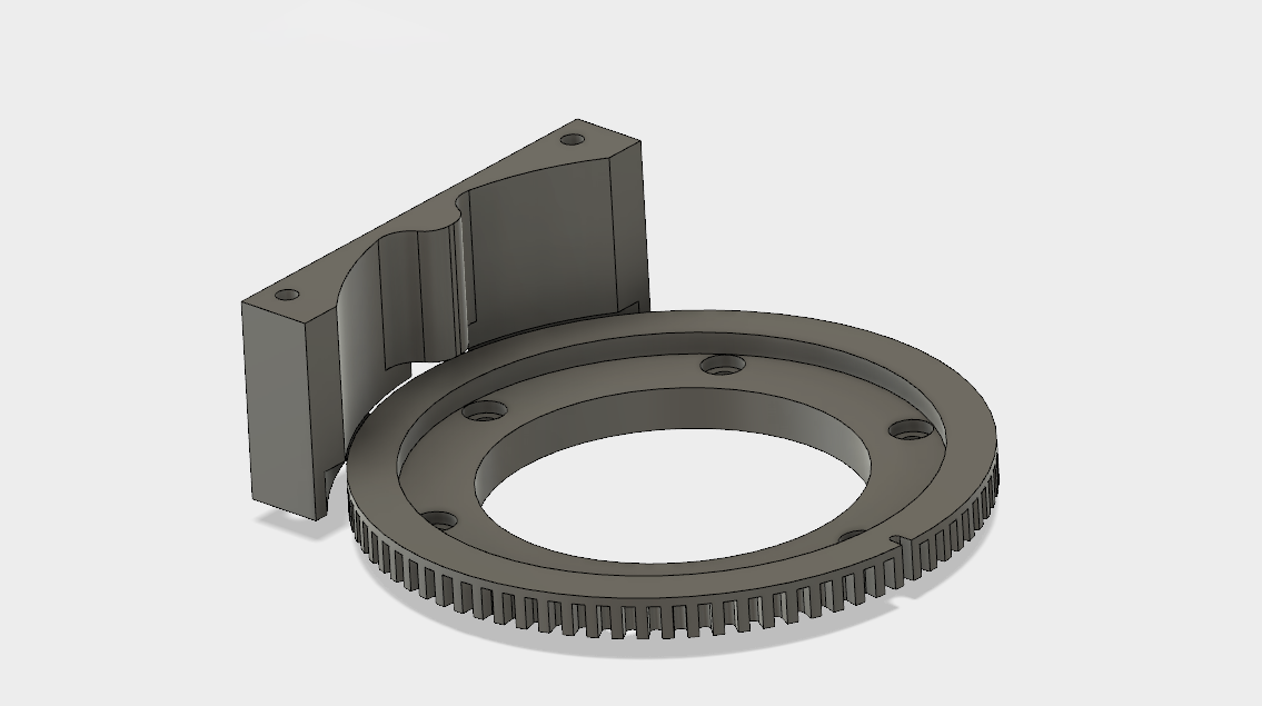

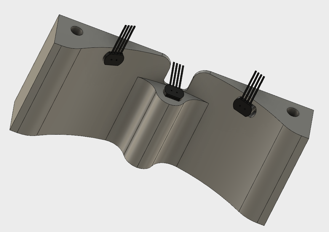

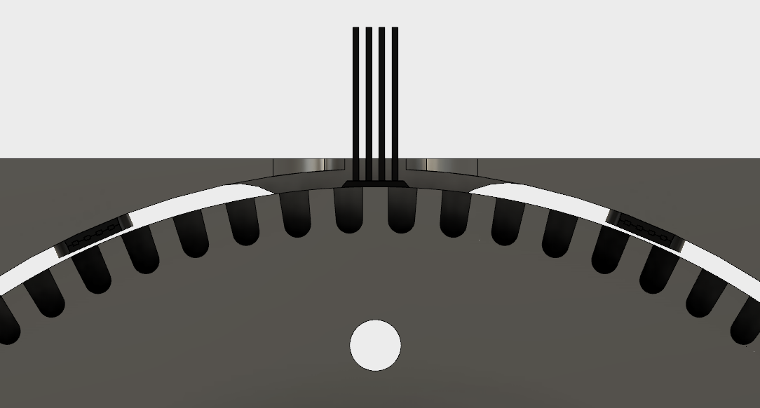

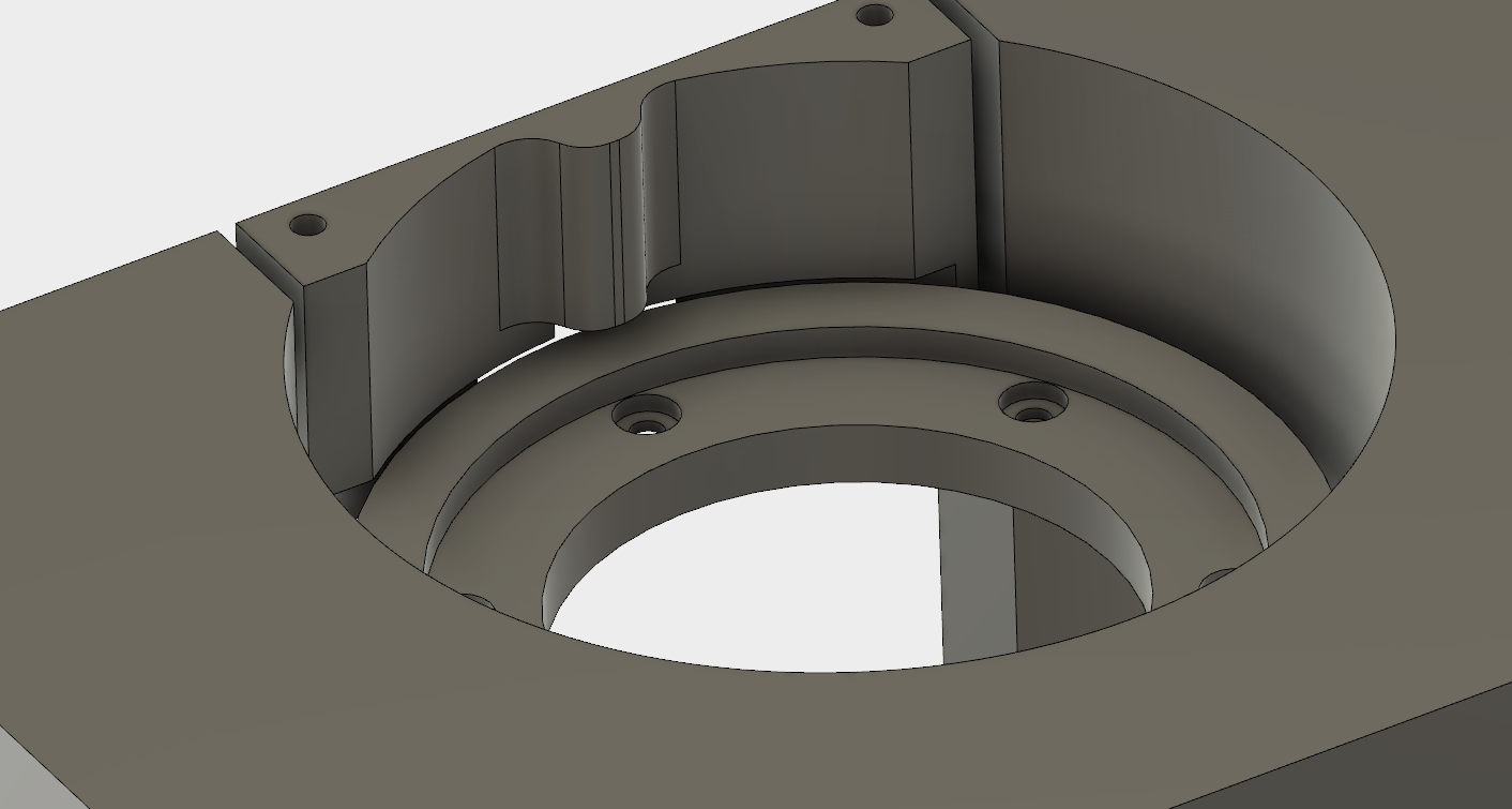

10 Mar 2017 18:39 #89359
by chopper79
Replied by chopper79 on topic 1982 Matsuura MC-500v Retrofit
Have a basic idea on how I want to mount my sensors. Need to model a few more thing fist and then I will make the mount and see how it fits. The mount is the left piece with the two holes. This will allow me to mount one sensor on top to pick up my index mark and the other two sensors will have more then enough adjustment are for me to dial it in.
This is just a concept at the moment.

10 Mar 2017 19:27 #89364
Replied by andypugh on topic 1982 Matsuura MC-500v Retrofit
Looks like it will work. But it seems significantly more elaborate than necessary. Is it visible? If not, then some simple bits of bent metal would be perfectly adequate.

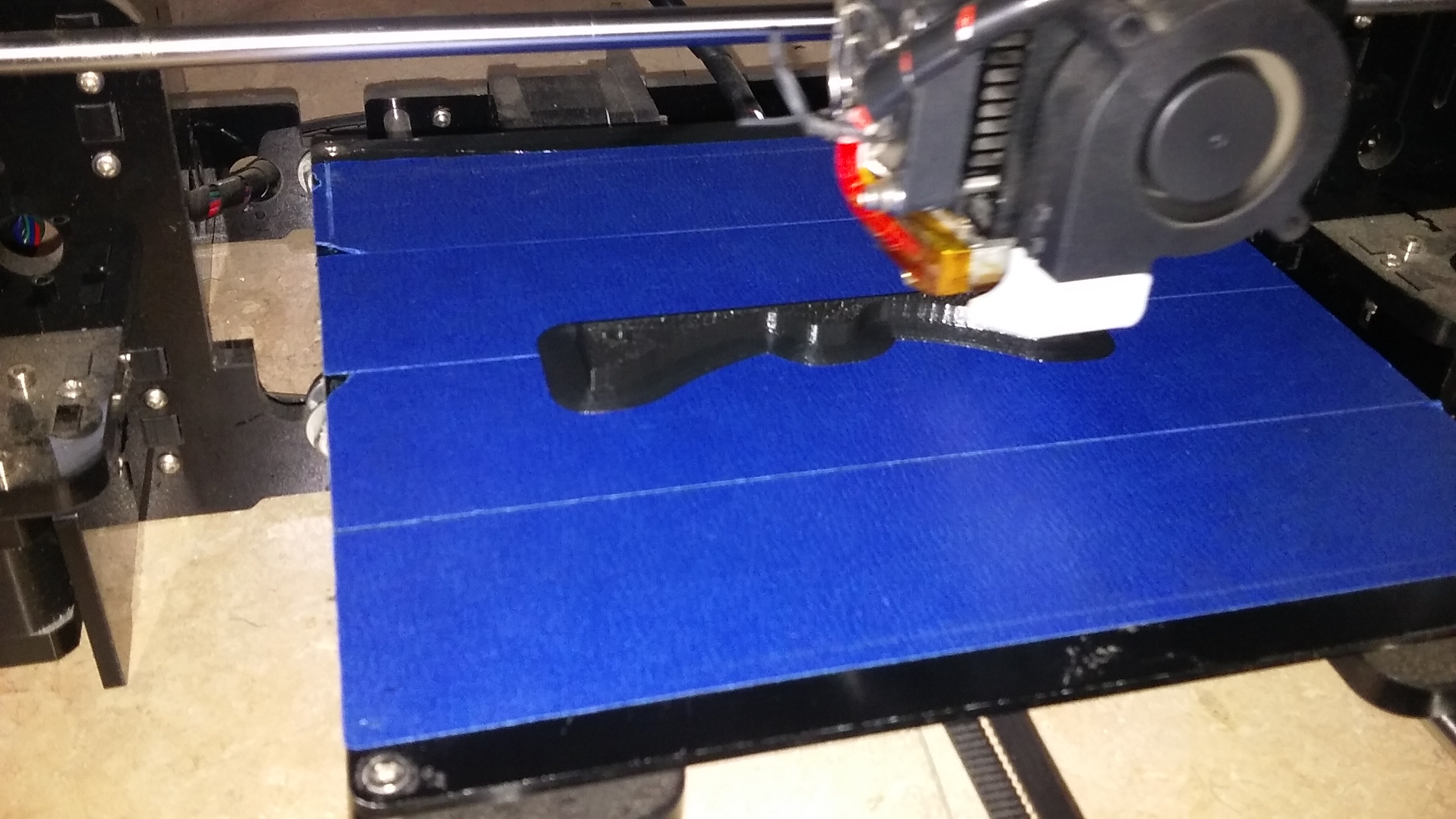

11 Mar 2017 00:07 - 11 Mar 2017 00:09 #89386
by chopper79
Before I make this from a block of aluminum I figured I would 3D print the part first to check fitment and such. This right here is one of the main reasons I have a 3D printer. It is cheaper to prototype in plastic then metal. The other reasons are to make little trinkets with my kids.
Heck I may just use the 3D printer to make this sensor mount for the real one. Use some additive manufacturing for the subtractive manufacturing machine.

11 Mar 2017 00:40 #89389
It will be non-conductive, which is an advantage.
If I had a 3D printer (and I am often surprised that I don't) then I think I would seriously consider making bolt-on mounts for the sensors that way, at the very least.

11 Mar 2017 00:49 #89390
by chopper79
I just may use the 3D print for the bracket. Most of the time I use it for prototyping so I can make adjustments if needed before any chips fly. I agree that making brackets like this and others is a great use of this type of technology as well. I will post results when the print is finished.
If the bracket works well then I will post the files for it also just in case anyone else wants to make one for their Matsuura Mc-500v2
