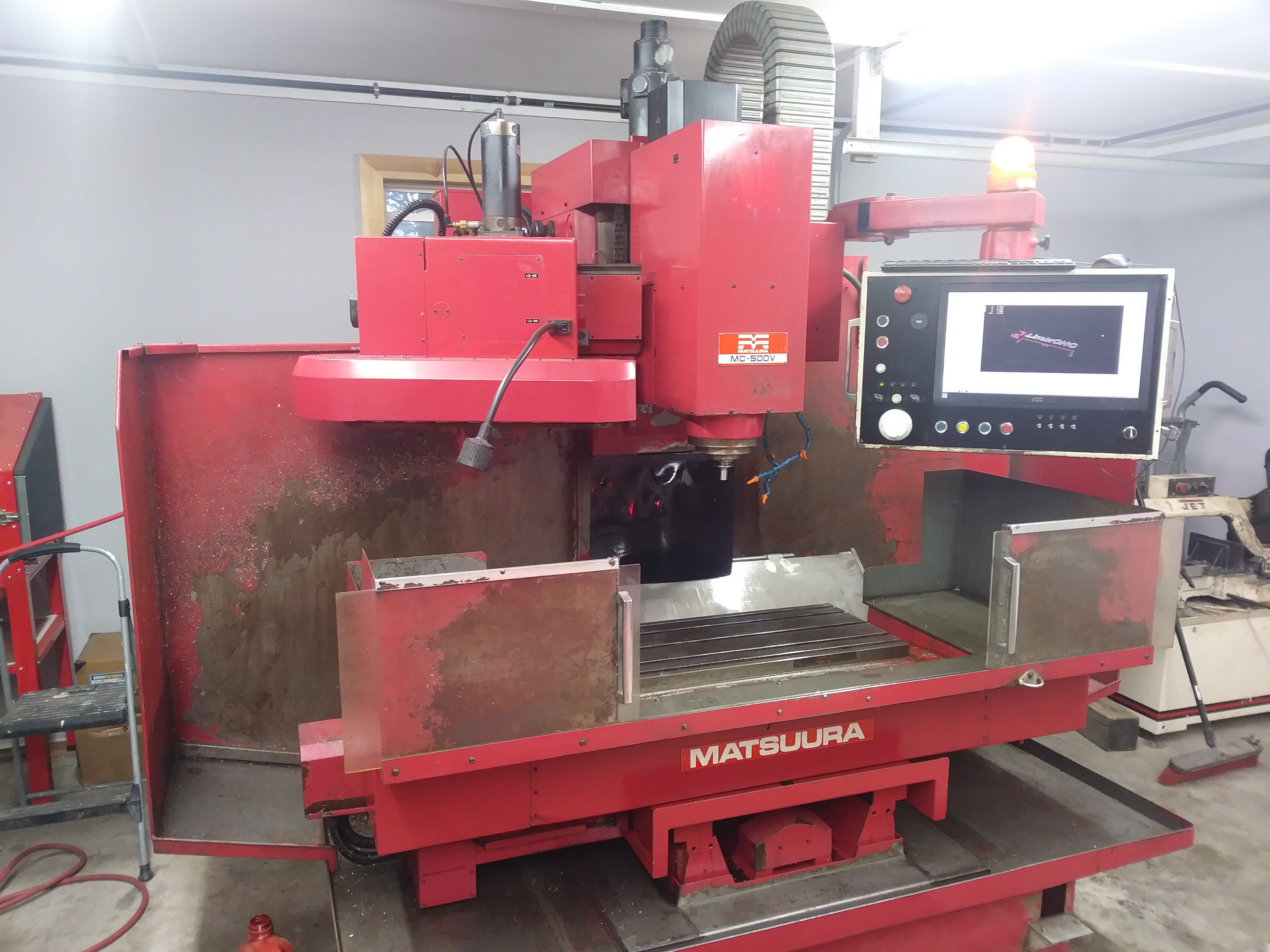

I have had a good time with this project. The previous mills I have done were not this involved. Well worth it just on the experience end of things. Getting really close to being complete and hope to be done in the next couple weeks at most. I am really excited to let this mill eat some material.

Just a short video of the mill going through its paces. Just doing it in air right now. Making sure all things are functioning.

Hello again chopper, I've been reading your whole thread because I'm probably going to retrofit a MC 500V, many thanks for all your effort on this, it is very useful and valuable for me.
now,
I'm want to ask you specifically how did you apply voltage to the analog line?
I'm guessing you connected an external variable power supply (+/- 10V) ? or did you use a potentiometer?
IF you used a power supply did you connect the ( - power supply signal ) to the (- common servodrive)? how did you connect it?.
many thanks for your repply
Replied by kt600v on topic 1982 Matsuura MC-500v Retrofit
Grounded (pin1) and then applied voltage to the analog line and I can move my z axis both directions with my bench top supply.
