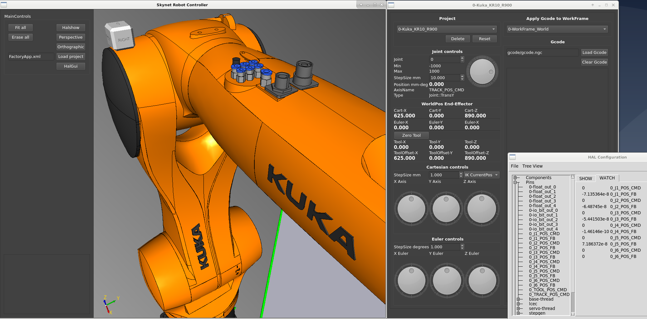

A little update.
After i did making the iso. Finally the stepcolors are detailed. This is nice !
To save pc memory it now only load's the stepfile surfaces.
To get a more realistic machine movement,
I just experimented with updating the screen preview based on the "Position Feedback Value's"
from the Hal stepgenerator. My motors are connected and the output is nice.
Video that show's updating the machine movements on feedback position.
video
This is a example halfile used by above video.
I am thinking to integrate a stand alone motion planner now. This can be a hard job to do.

Thanks for the video.
Is that still going through LinuxCNC or are the motors handled by your code?

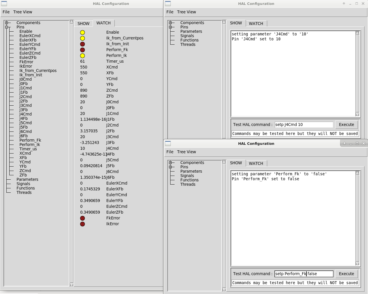

Hi Arciera,
The motors are handled by trough hal.
I haven't done much, as I'm trying to reverse engineer my robots teach in pendant to see if I could some how use that together with linuxCNC.
Interesting !
I had some problems to solve. The Qt program was not able to rotate the motors trough my wishes. It was doing a quite good
job. But i was not satisfied ! The solution is to bring the Ik and Fk outside of the QT app as stand alone c++ component.
In the meantime i made a linuxcnc kinematics component for Ik and Fk based on KDL kinematics.
The problem in this case is that realtime code is in C and the KDL library is in C++. So downgrading KDL to c is an option.
But that would be silly to do.
So i made a tiny C++ program that act's as a realtime component. The output is very promising. When performing IK and FK the
cyclus time is < 100 us. In the QT program the position command update time was 10 times a second. So a very big improvement.
So if the Stepgen was updated 10 times a second you will hear the motors change speed 10 times a second. If the update is for example 1000 times a second, you will hear a perfect motor speed increase and decrease sound.
You could use this code too. The code is written as basic as possible to be more readable for users.
Later on adding the xml config file input etc. is easy to do. For now the kdl chain setup is written in the code.
Users can choose to do "Perform_IK" or "Perform_FK"
You see the chrono timer is doing a cycle of 61 nanoseconds. This is really fast.
I will add a sort of synchronisation pin to stay in line with the servo-threat and avoid making waste calculations.
SourceCode

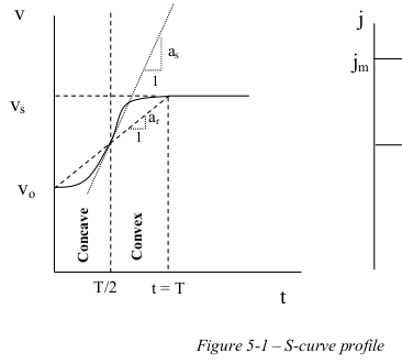

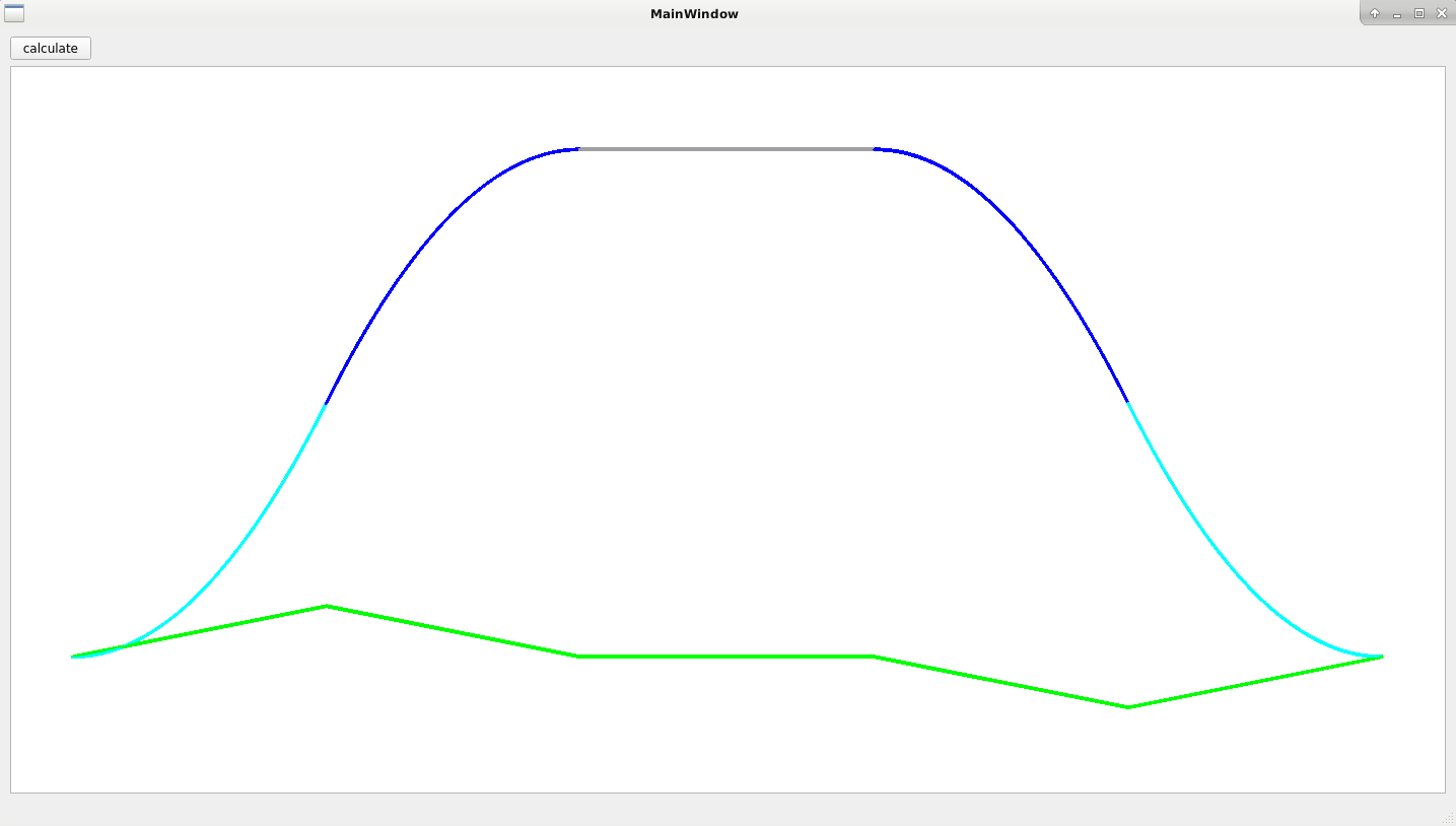

I succeeded to implement a tiny test motion planner that run's trough 3 points. The result is a smooth motor acceleration, deacceleration.
This test motion planner has a lineair acceleration curve. So i am not satisfied with this type and have written a
S curve acceleration / deacceleration type.
The source for the S-curve is at my github channel
No i have to put everything together in new motion planner. This will be a c++ hal component motion planner.
So far so good, have a nice day !

Oke i have written the S-curve code in C comp style, and did a graph plot with Qt to show what is happening.
- Cyan is concave period
- Blue is convex period
- Gray is at speed period
- Green is acceleration
- startpoint x0 y0 z0, endpoint x600 y200 z0
- MaxVel = 20 mm/sec
- Acceleration = 1 mm/sec^2
- Output graph :
From S-curve document : doc
Ok. This looks oke to me.
Now i can try to expand the s-curve code to work with motioncommands.
QT source code with graph view : SourceCode
