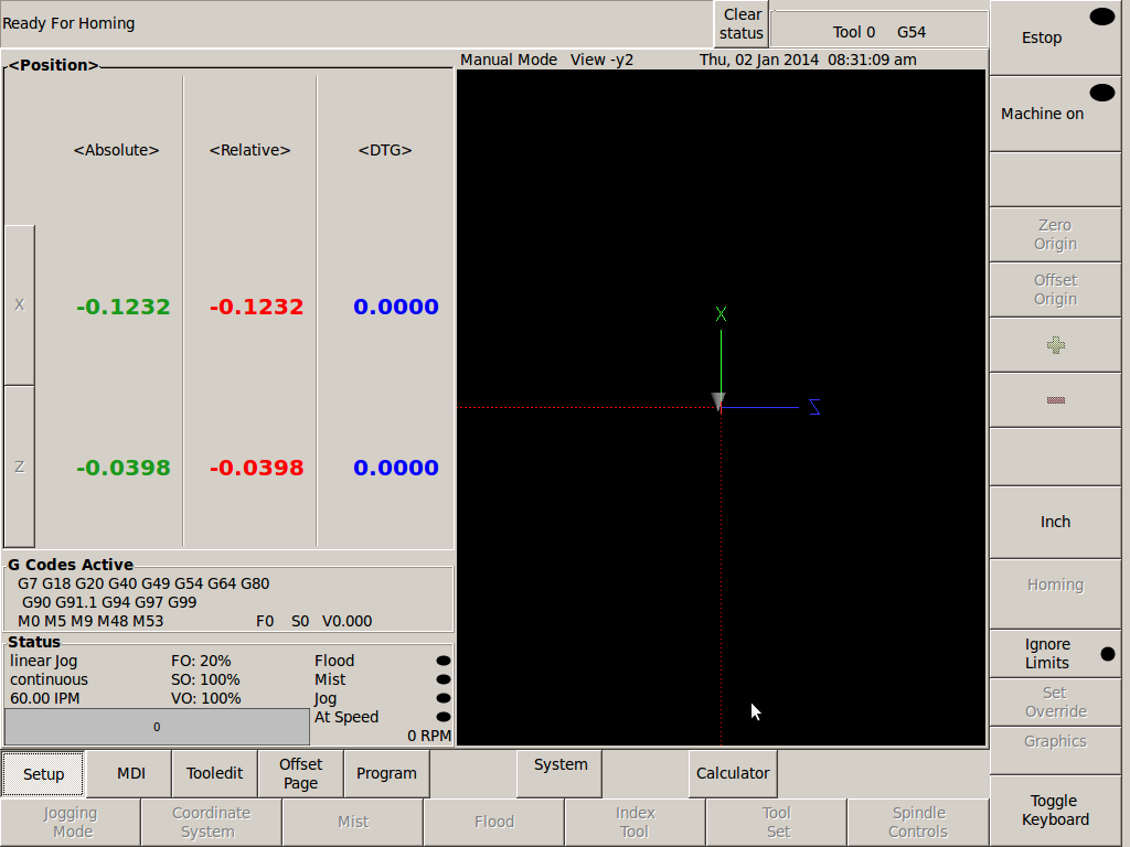

The widget 'dro_x1' s missing from the glade file
dro_x1 is the HAL_DRO widget for displaying the absolute X axis
Maybe you deleted it?
01 Jan 2014 07:08 #42253 by LAIR82
It only says that when I select expand in glade on the 3 items you said to click on to expand the left side to fill in the gap at the bottom where the onscreen keyboard would be.
I moved a fresh copy of the file into my config, tried again and it says the same thing.

Are you using a RIP compiled from sources? If so:
When you edit the GLADE file, you must start GLADE from the terminal after . scripts/rip_environment (in the linuxcnc directory)
That tells GLADE about the special widgets. The DRO widgets won't even show up other wise.
Could be the trouble.
Chris M
02 Jan 2014 21:24 #42283 by LAIR82
Chris M
Its funny how things work as they should when following the proper procedures.
Worked fine, and back to what I was wanting it to look like.
Rick
