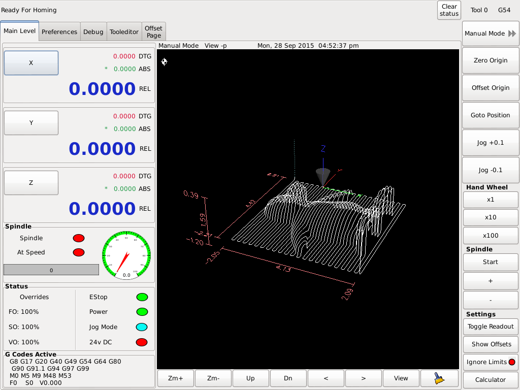

Thanks Chris. My customized screen will be targeted for a Bridgeport Interact with a touch screen so the appeal will be narrow. But I will be happy to make it to anyone that may be interested.
I figured out the hard way how custom python handlers work last night. I think I at last understand the process, now the actual work begins.
There are a number of buttons that I would like to remove. To do that the references in gscreen need to be overridden. It ends up being messy to do overrides so I am planning to leave the buttons in, but not make them visible. Am I on the right track?

Yes making widgets not visible is an easy way to customise the screen.
Which 'skin' are you basing it on?
Chris M
Replied by cmorley on topic Gscreen - a GTK / Glade / Python based screen

I am working from the default skin, does it have a name? Essentially I am creating a new skin. Mostly I want to simplify by removing all of the buttons that I will not be using. For example I will have external start, stop, estop and power buttons (the machine originals) so those should be removed from the GUI. Also for homing I just want a single button to home the machine. I'll post a screen shot when I get it working.

29 Sep 2015 06:18 #63169
by csbrady
Replied by csbrady on topic Gscreen - a GTK / Glade / Python based screen
Here are screen shots for my new gscreen skin.
Here are the criteria I came up with for the project:
1) Only show buttons that will get used for my implementation
2) All of the buttons needed for a particular mode are displayed, no paging through buttons.
3) All of the buttons are big enough to work well with a touch screen. They are a little small, but big enough for my 15" screen.
On power up the the Mode button is the Home button and it switches to Mode as soon when the machine is homed. I added jog + & - 0.1 buttons to make it easy to subtract / add the 0.1" offset from a 0.2" edge finder. It's really nice to be able to customize the interface for the way I work.
Most of the buttons work and I just need to work out how to tie this into HAL. Still learning ...
hey that looks user friendly!
The gscreen samples all suffer from being development driven and not use driven.
I experimented with all kinds of methodologies, so I can see right away your screen is narrowed to what is needed, rather then a bunch of choices.
you got a name for it
Chris M
Chris M
