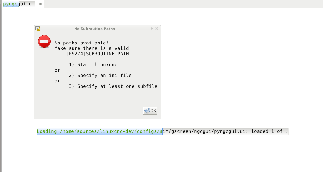

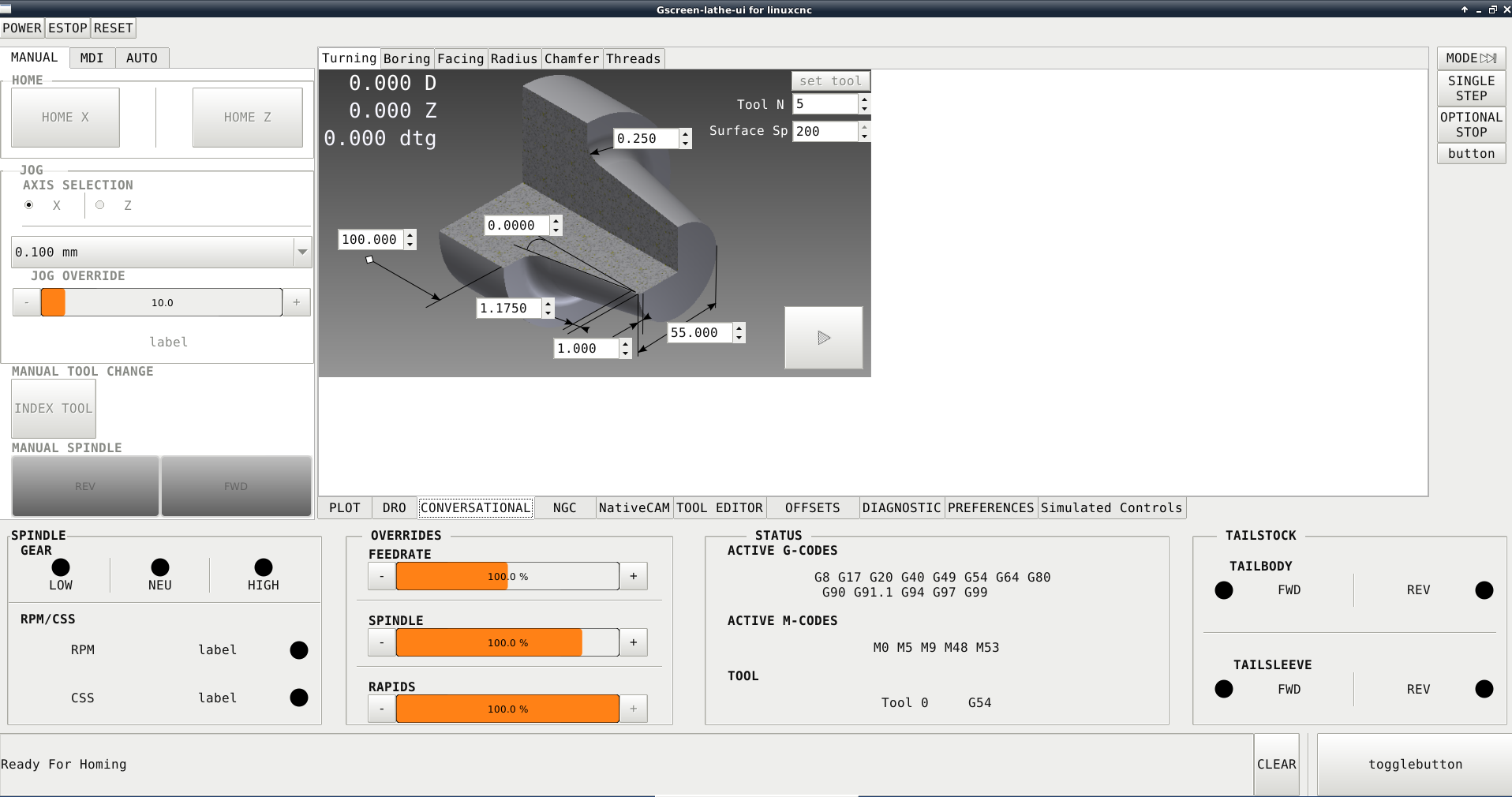

Well, here's another kick at the cat for a custom gscreen skin. It's pretty similar to gaxis, meant specifically for a CNC Lathe that has a Hydraulic
  • 10 station turret
  • programable tailstock
  • 3 speed gearbox
and will have the following physical buttons
  • program start/pause
  • MPG
  • Joystick
  • tailstock/tailseeve fwd/rev
using a rip 2.8 wheezy, glade 3.8.0
I am trying to use the KISS method, i.e. use glade auto connect signal handling and vcp widgets/actions wherever possible.
At this point my most pressing issue's are (not in order)
1) I want to embed Ngcgui, (and potientally NativeCAM if it can be done) I don't get any errors when it starts up but I can't see the tab,
2) pyNCG and gremlin plus crash glade everytime
3) **** setting up gscreen to jog with MPG or Joystick
4) setting/updating labels and having them react to hal pin changes for CSS and RPM
Threre are still many other issues but I don't want to get too far ahead of myself. Any help would be apreciated,
Dan

1) I assume you mean embedded in a tab - AFAIK both can be embedded.
There is a sample config that works for me in configs/sim/gscreen/ngcgui - does it work for you?

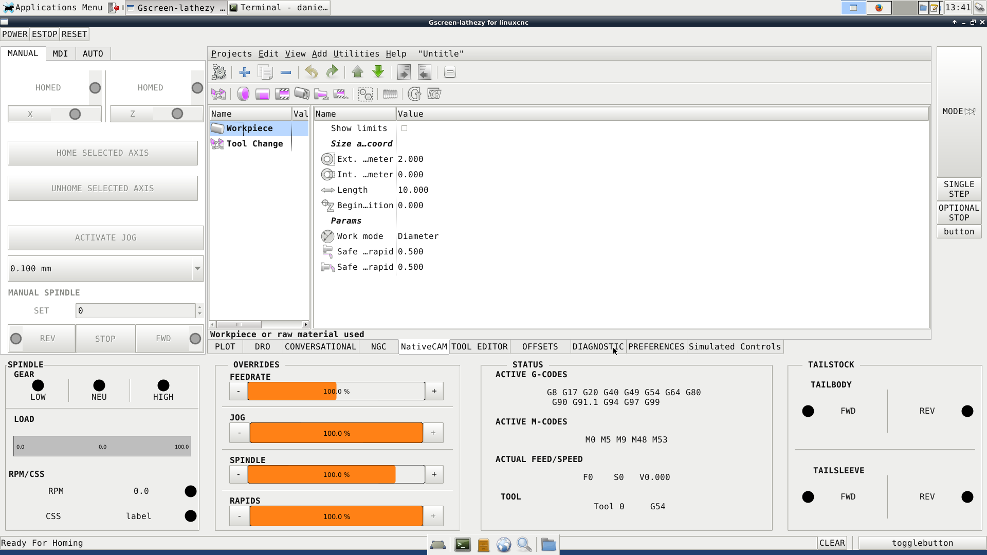

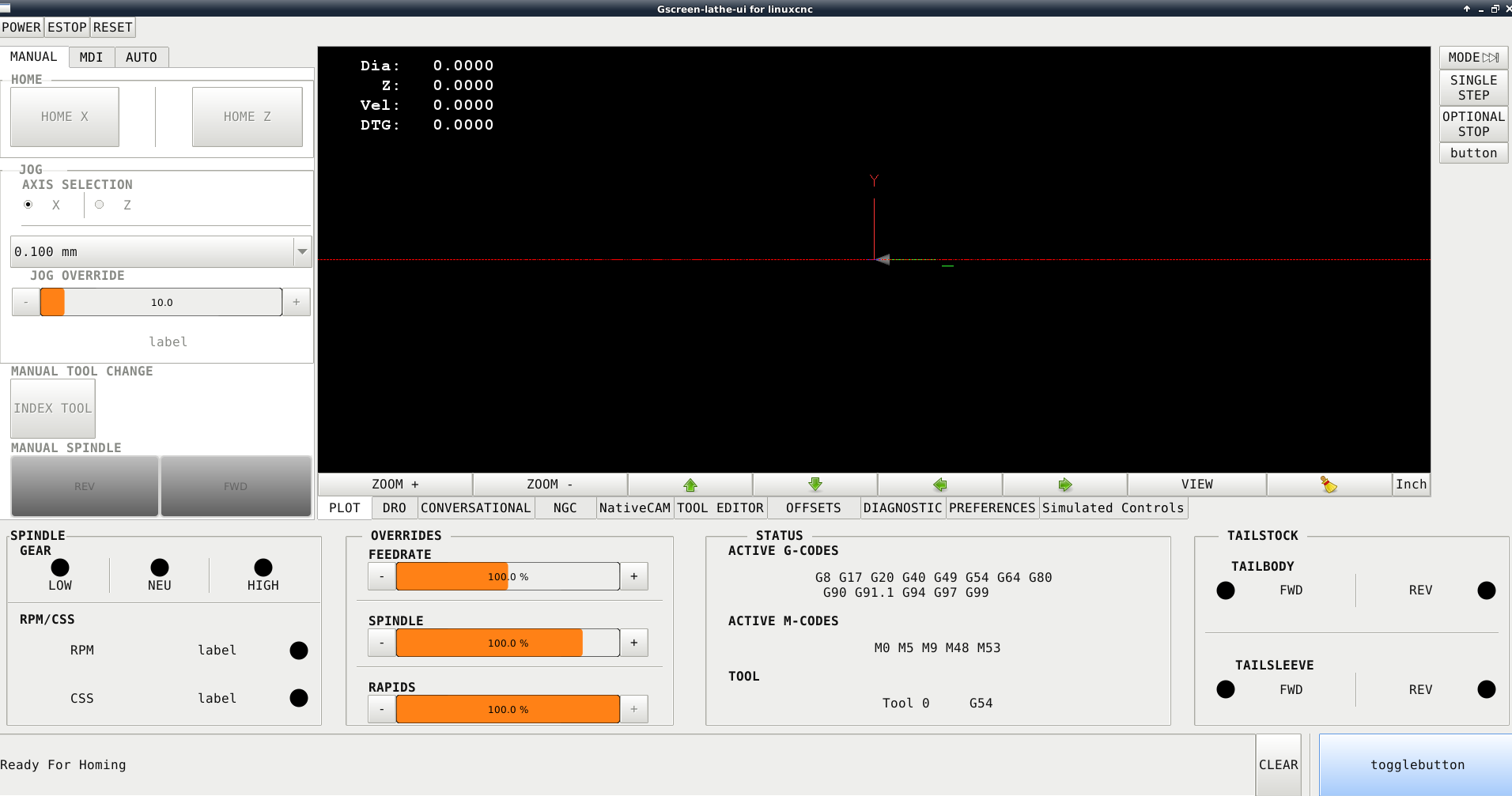

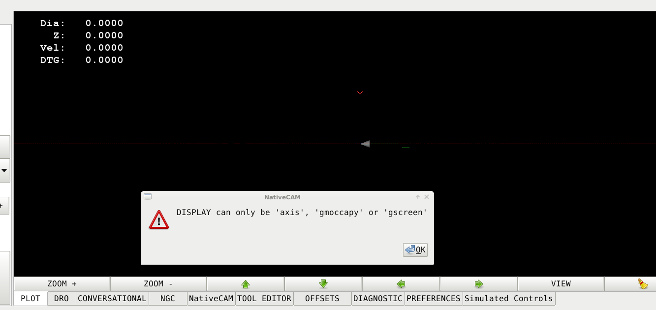

18 Dec 2018 17:15 - 18 Dec 2018 17:16 #122578 by sqmathlete
Replied by sqmathlete on topic Gscreen - a GTK / Glade / Python based screen
Hi Chris,
I had to do a bit of messing around to get my version of glade to update with the new label widgets but, I have it working now. Thanks :)
Also, NativeCAM is embedded in a tab, and I have managed to figure out a few leds as you can see. However, I am a little unclear about how to access the status, command, and error channel if the info that I want access to is not in gscreens data class. For example the joint dictionary or how to tell if the interpreter is idle before one of my buttons does something? As well as how to update everything when the screen starts up and the operator hasn't pushed a button or anything.
I have posted my files, the commenting is pretty verbose, feel free to add to it. You might need to comment out the embed pyngcgui and cycles tabs in the ini.file since I have all of the ngc files in my config folder. I started with the sim-fanucy lathe config since it already had a remapped tool change that was the same as the original fanuc controller. T202, calls tool 2, applies offset 2, and applies wear offset 100002. T2 calls tool2 , and applies offset 2. Will probably have to make a few changes in the .ngc files to accommodate that behavior. Will deal with that later though.
