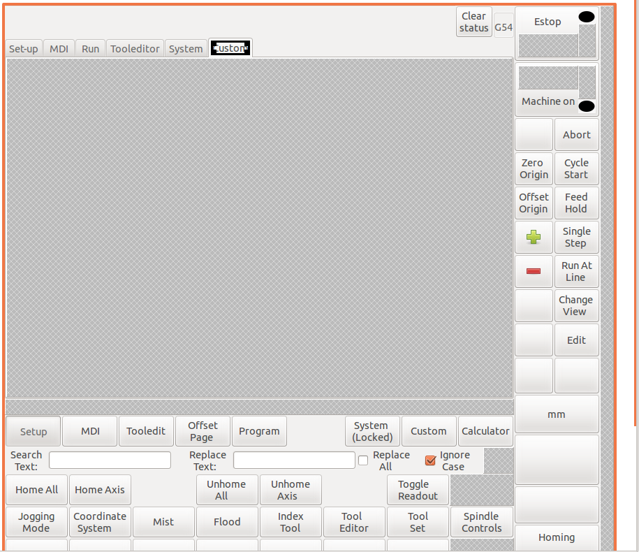

HI Chris,
I have a question , I'm trying to add and extra page to the mode buttons in gscreen industrial "Custom" so I've added extra a new page to "notebook_main"
also a Custom_button
and I've added the following lines in the handleralso I've add "Custom_button"to to toggle mode listalso in
till now every thing looks fine BUT, when I'm trying to add an external tab in the iniall the axis DRO's are shown
but if I change the location to "vcp_box"or other places I have the exact number of axis, where should I look for hiding all extra axis?
Thank you
best regards
Masoun

- Posts: 7360
- Thank you received: 2173
24 Nov 2017 00:12 #102281
Replied by cmorley on topic Gscreen - a GTK / Glade / Python based screen
Could you post your glade and handler files please.
I will look at the problem then.
It's been awhile since working on gscreen so not sure how quick it will be.
Chris M
Chris M

Here is my edited handler file
appreciate your help
Masoun

- Posts: 7360
25 Nov 2017 09:02 #102327
Ok the problem is industrial relies on the extra axes widgets being hidden by default. it then shows the one defined in the INI file.
But when you add a tab to that particular tab widget it resets those hidden widgets to now show.
So we must hide them again.
in the handler file ( under the def initialize_widgets(self): method) look for :
change it to:
Should fix the problem
Chris M
self.widgets["dro_%s1"%i].show()
self.widgets["dro_%s2"%i].show()
self.widgets["dro_%s3"%i].show()
self.widgets["axis_%s"%i].show()
self.widgets["home_%s"%i].show()change it to:
for i in ('x','y','z','a','b','c','u','v','w'):
if i in self.data.axis_list:
else:
self.widgets["dro_%s1"%i].hide()
self.widgets["dro_%s2"%i].hide()
self.widgets["dro_%s3"%i].hide()
self.widgets["axis_%s"%i].hide()
self.widgets["home_%s"%i].hide()Should fix the problem
Chris M

25 Nov 2017 09:35 #102329
by Big_Mas74
Replied by Big_Mas74 on topic Gscreen - a GTK / Glade / Python based screen
Perfect worked like a charm
Masoun

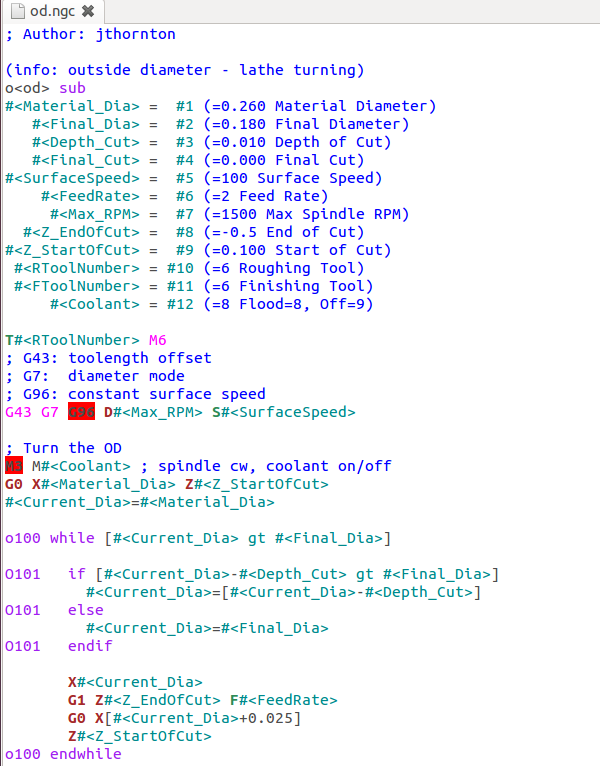

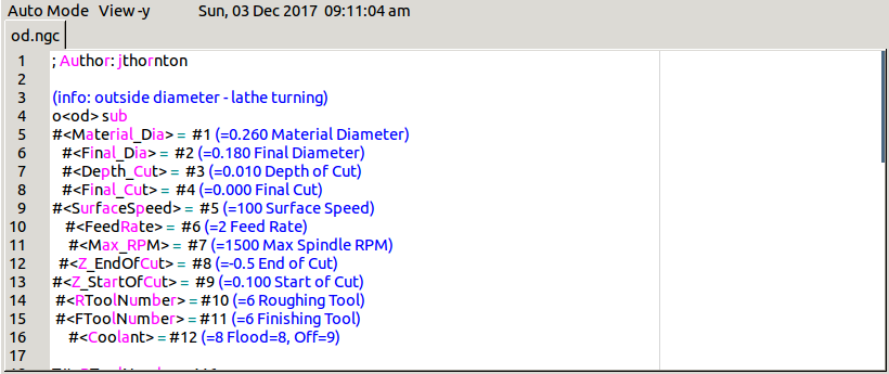

Hi Chris,
I have a question, regarding the EDITOR in ini file, currently there is no editor specified in it and the screen uses gedit by default ( I presume ), now the problem is the language syntax customisation in it looks deferent if I opened the same file from gedit directly, for example here how looks within linuxcnc
file opened within linuxcnc, while here:
how it looks when open by gedit externally
the gedit version is 3.4.1 and I've installed gcode.lang and/or ngc.lang language to it.
Is this screen limitation or can I do something?
Masoun
