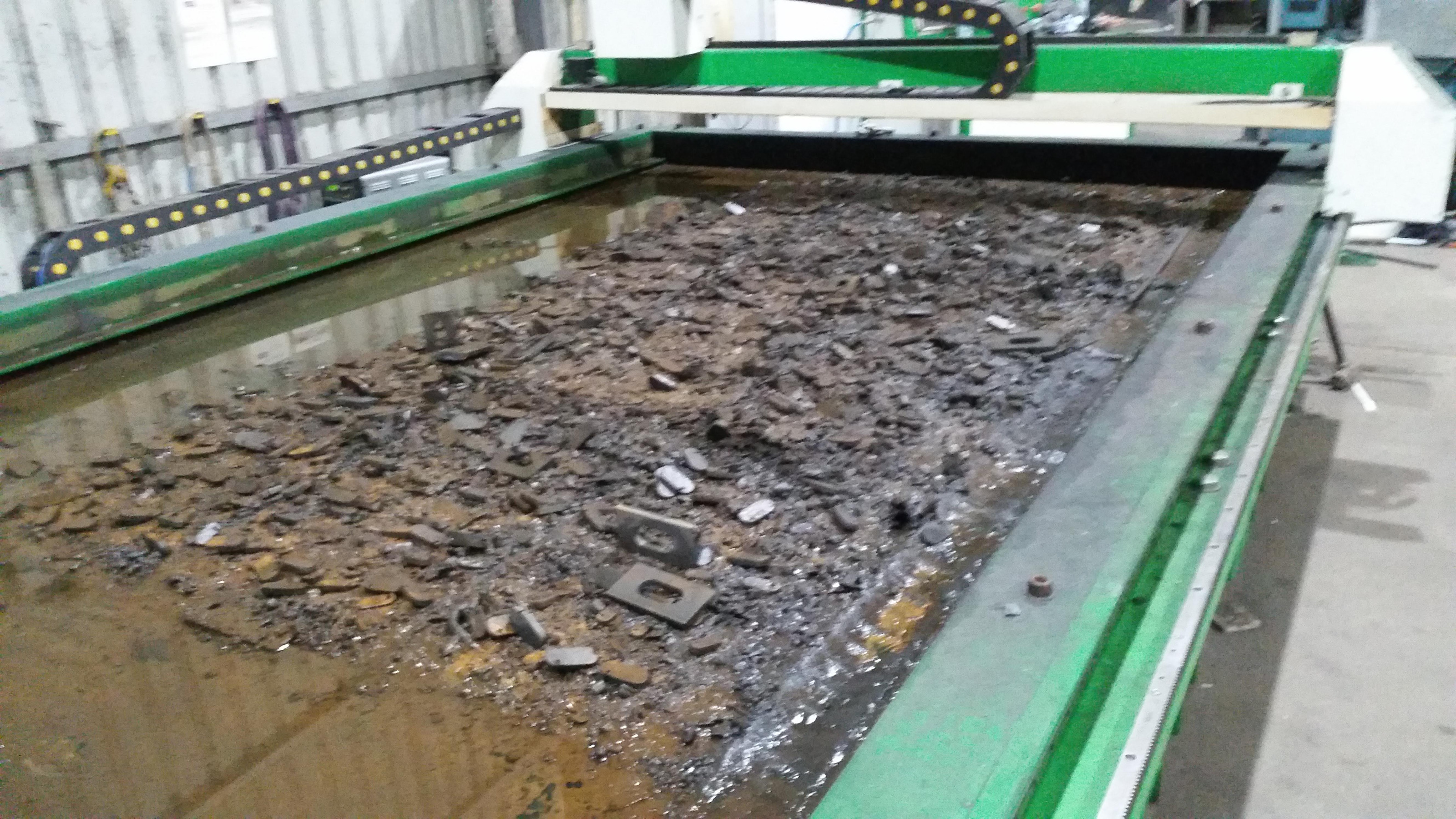

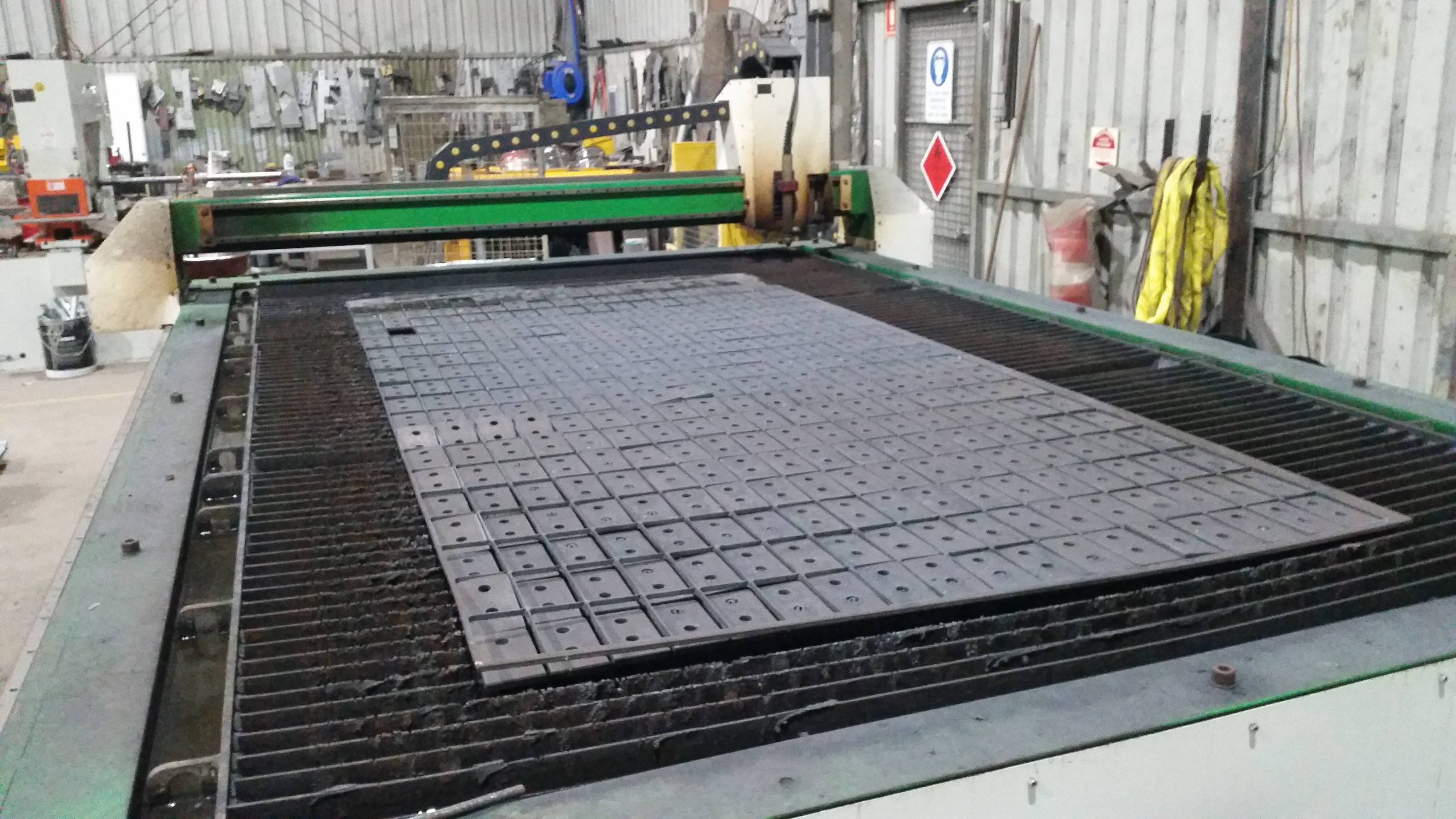

Time for some more pictures,
The ugly side of owning a water table, Cleaning it out,
351 cleats in just over 4 hours, 100% yield, Nothing better than being able to walk away from the machine while it cuts and know that it wont break down. Cut all cleats with no operator intervention. Just a testament to how good PlasmaC really is!

10 Aug 2019 07:57 #141848
Great work. So how does that error rate compare with previous pre-plasmac experience?
Replied by rodw on topic Another plasma component...
