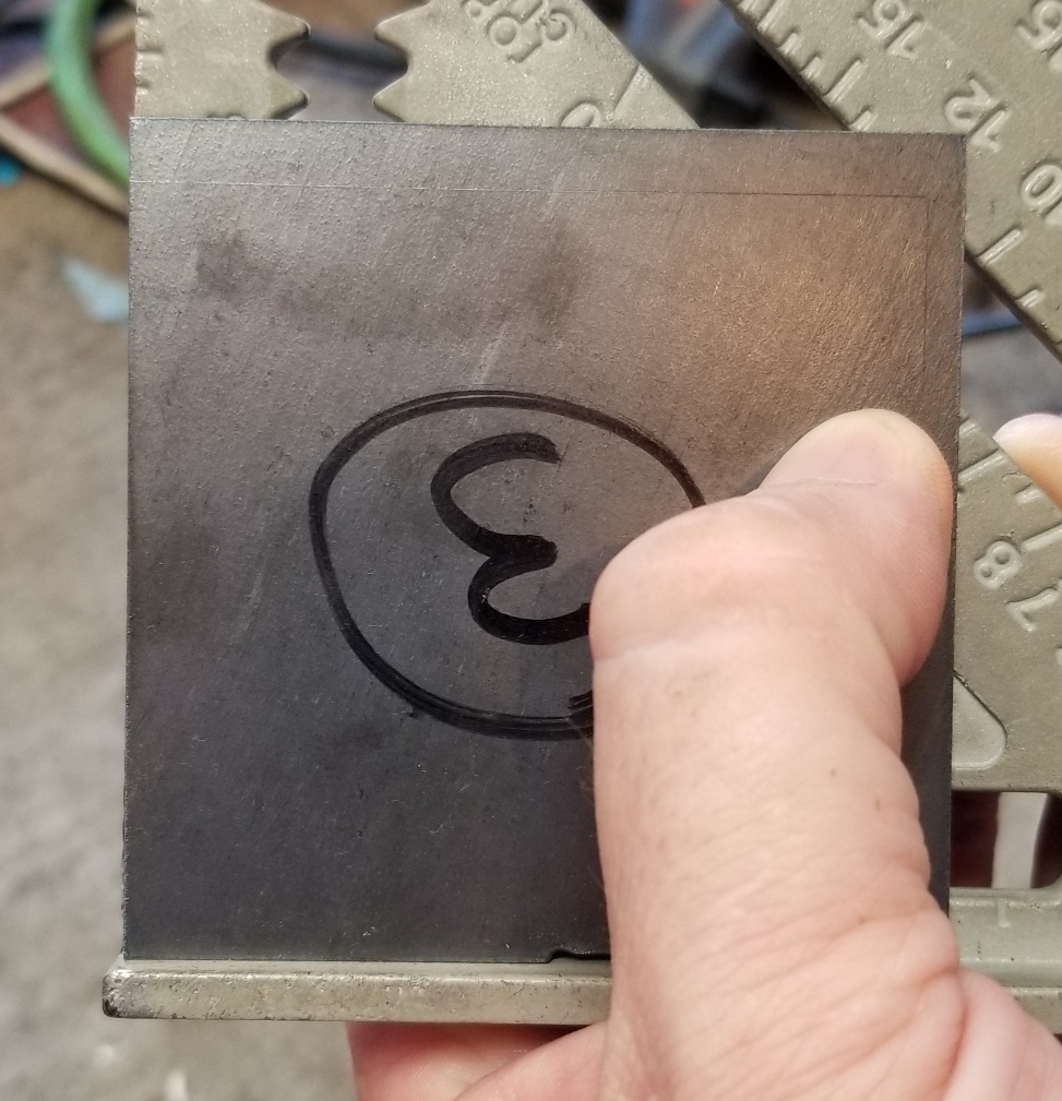

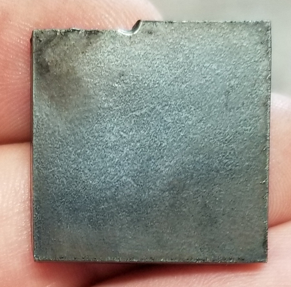

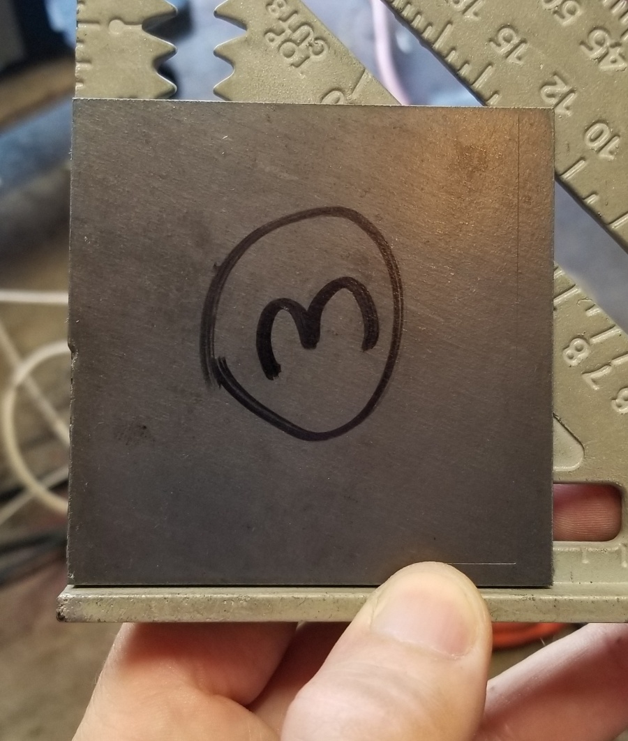

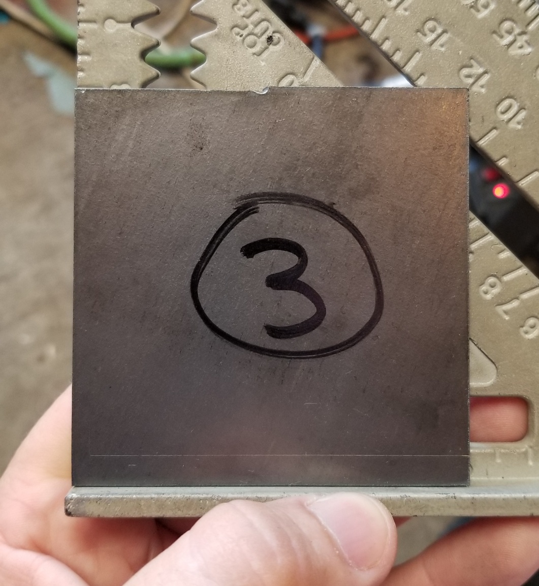

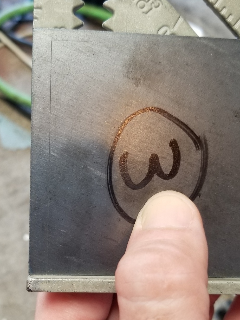

Phil, I made the adjustments on the float setup and that eliminated the choppy cuts at the corners. The step where the lead in/out is is still there. Attaching some photos. On the side where the step is, you can see that each side of that step on the X axis is square/perpendicular to the Y axis.
Replied by dvn4life1972 on topic My Newb Plasma Table Attempted Build
Hard to tell from the pics but are any of the corners of the "square" actually square?
Is the notch on the X axis or the Y axis?
Can you post the code you cut with, it looks ok when I do it here but...
EDIT: To me it looks like your X and Y axes are not perpendicular.
Last edit: 02 Jun 2020 15:30 by dvn4life1972. Reason: Added gcode file

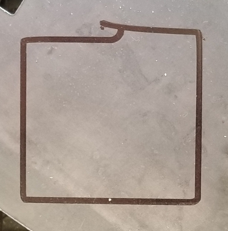

02 Jun 2020 16:57 #169821
by dvn4life1972
- Posts: 22002
- Thank you received: 7488
02 Jun 2020 17:00 #169822
Replied by tommylight on topic My Newb Plasma Table Attempted Build
Check the DRO while cutting, is the axis causing that divot on the same position at the beginning and at the end of that cut ?

02 Jun 2020 18:07 #169846
by dvn4life1972
Just did this and the DRO shows at the beginning (after lead in on X axis) -.205 on the Y, then turns onto the Y axis cut down to 3.205, then back on X for 3.205, then up the Y for 3.205, then the Y axis position shows -.205 when coming back to where the divot/step is. So basically the DRO is not reflecting what the machine is actually doing there.

02 Jun 2020 18:09 #169847
by dvn4life1972
Just tried this and it does the same thing with the plasma powered down completely. The proportions are a bit off because of the probing, but it's doing the same thing without any opportunity for interference from the plasma for sure.
I have no glue of plasma but i would guess that your driver catches some extra pulses as emf when you start. I would have a look into grounding.
What hapens when you fix a pen and run the same code without an arc
Just my 5c
Mike

02 Jun 2020 18:12 #169849
Replied by rodw on topic My Newb Plasma Table Attempted Build
i would write my own square in gcode. Its likely a bug in the shape gcodegenerated
