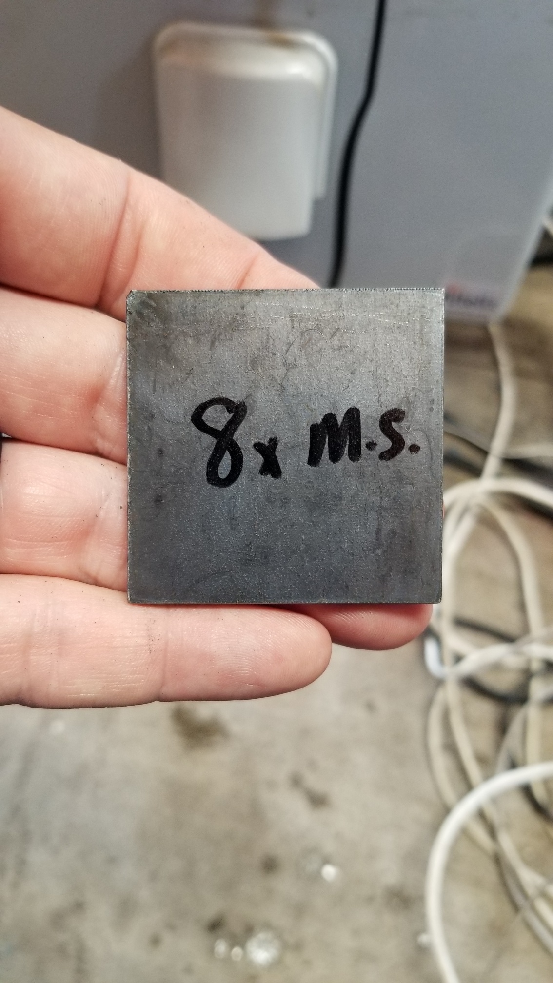

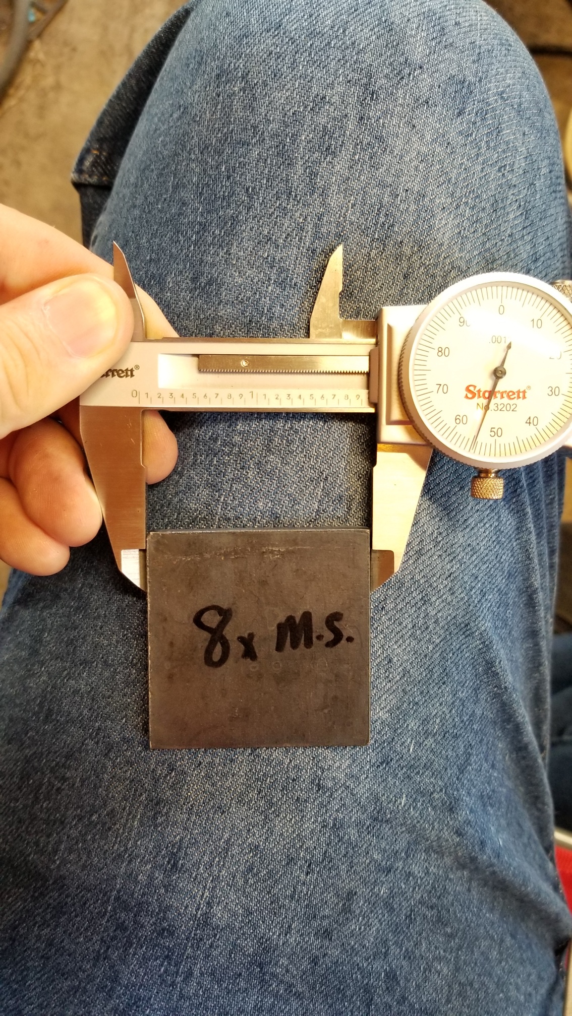

- dvn4life1972
- Posts: 401
- Thank you received: 173
03 Jun 2020 21:31 #170016
by dvn4life1972
Replied by dvn4life1972 on topic My Newb Plasma Table Attempted Build
Okay now we're getting somewhere. I also changed microstepping back to 8x...it's smoothest there far as I can tell. Then I ran your gcode for the 2in square and this is what I got.
Last night when I was just trying measurements running a set distance forward on Y and then back, I couldn't get it to miss any steps...was using a simple few lines of gcode I put in.
- Posts: 21959
- Thank you received: 7478
03 Jun 2020 21:41 #170018
Replied by tommylight on topic My Newb Plasma Table Attempted Build
Is it square ?
Well, we have been chasing our tails for two days now, but all is good, we do have a square.
And BTW, how come your hands are so clean and you are working with a plasma ???
The following user(s) said Thank You: dvn4life1972
- dvn4life1972
- Posts: 401
03 Jun 2020 21:57 #170022
by dvn4life1972
It's square. Also about the correct size (kerf width is .41).
I have washed my hands 3 times today so the wife doesn't kill me for coming in the house and making palm-art. I need to use the wizard to make another square piece and see if it still cuts properly.
