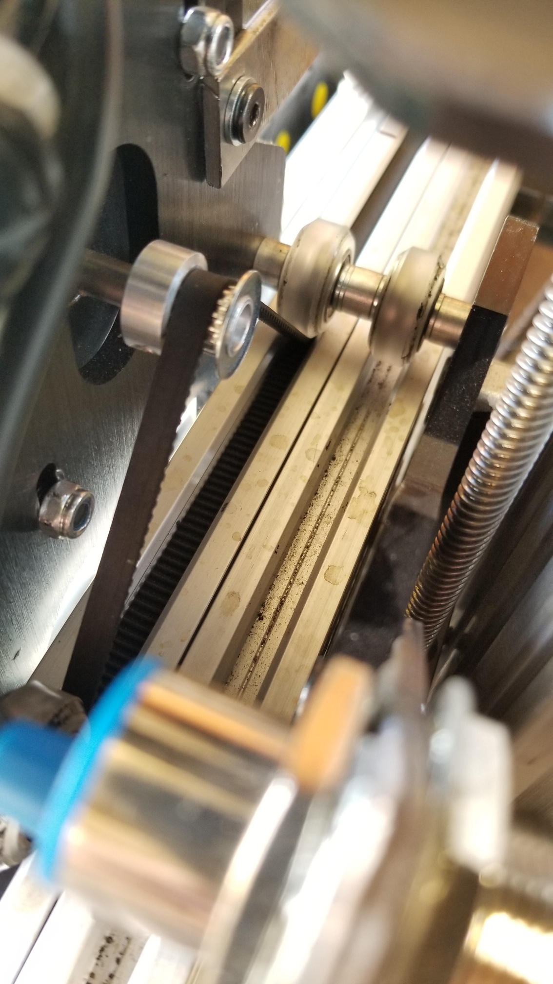

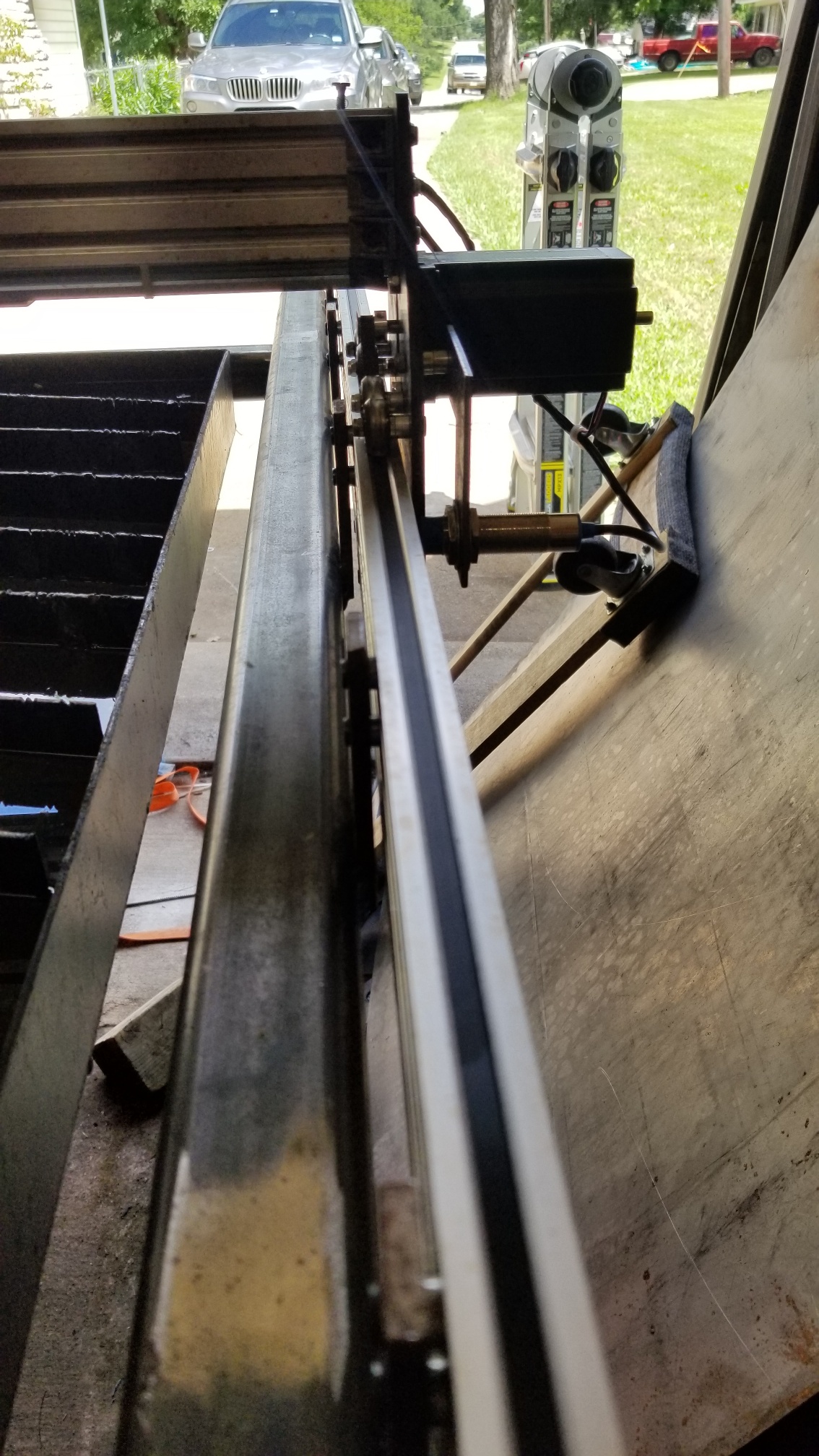

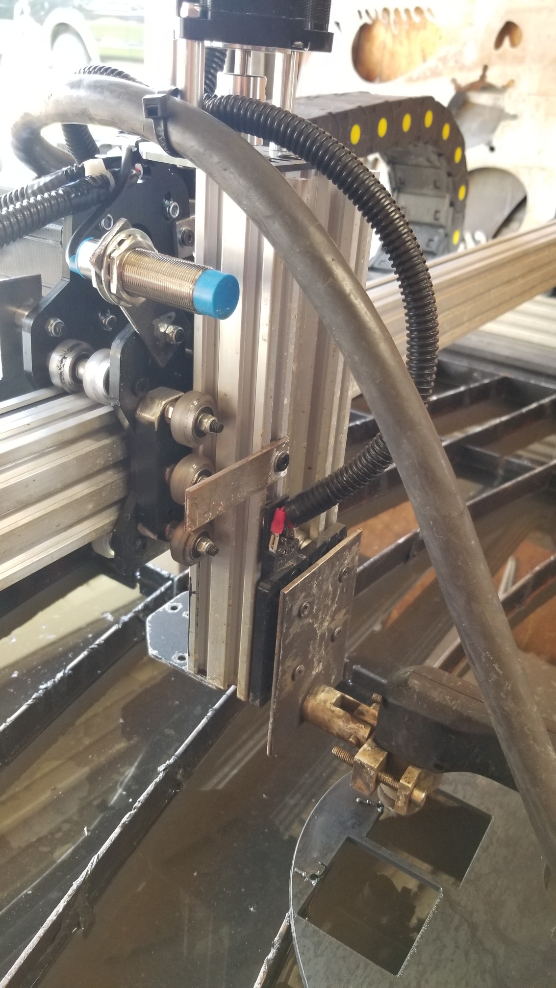

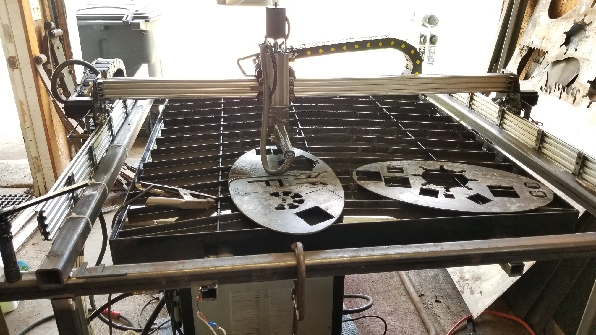

This has just become a challenge !
Can you post some pictures of the machine and some close-ups of the moving parts, please ?

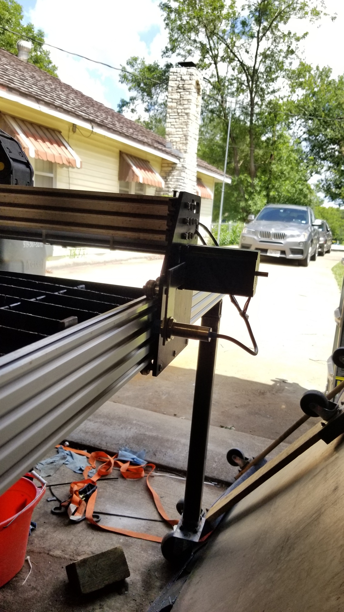

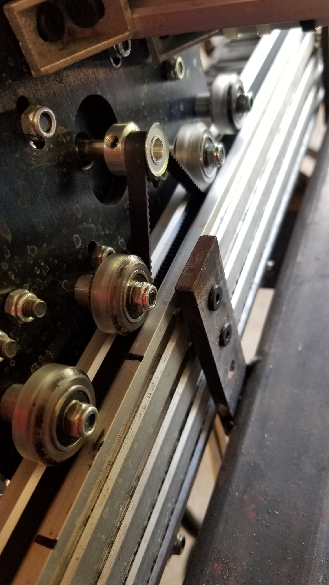

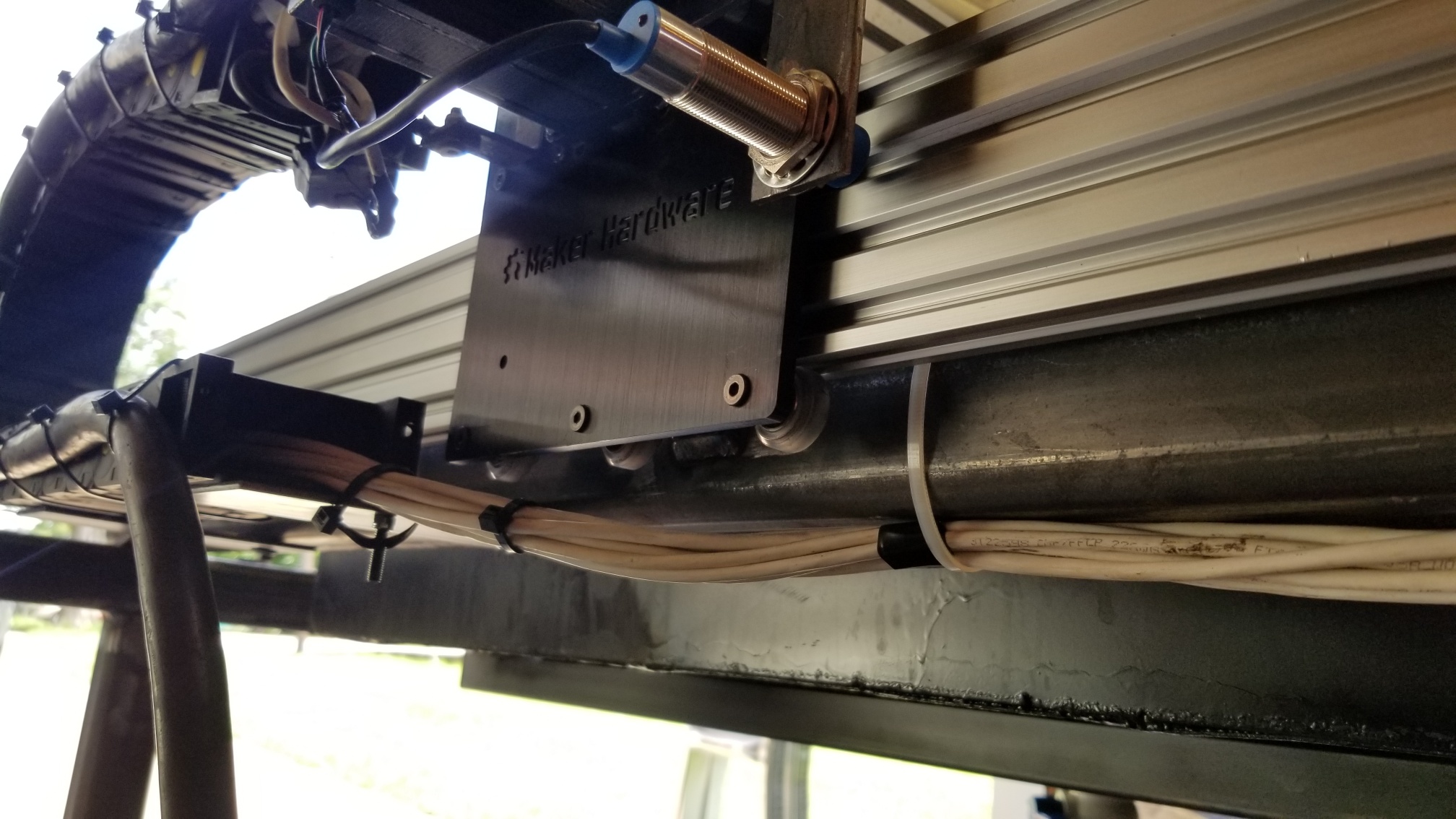

03 Jun 2020 20:12 #169995
by dvn4life1972
If this has only just now become a challenge, I'd hate to see the ones you've had before!
Please don't mind my mess. I hate showing this thing being a rookie and all, all of you guys have some really nice builds.
Making 2 posts due to the limitation on # of pics.
Replied by dvn4life1972 on topic My Newb Plasma Table Attempted Build

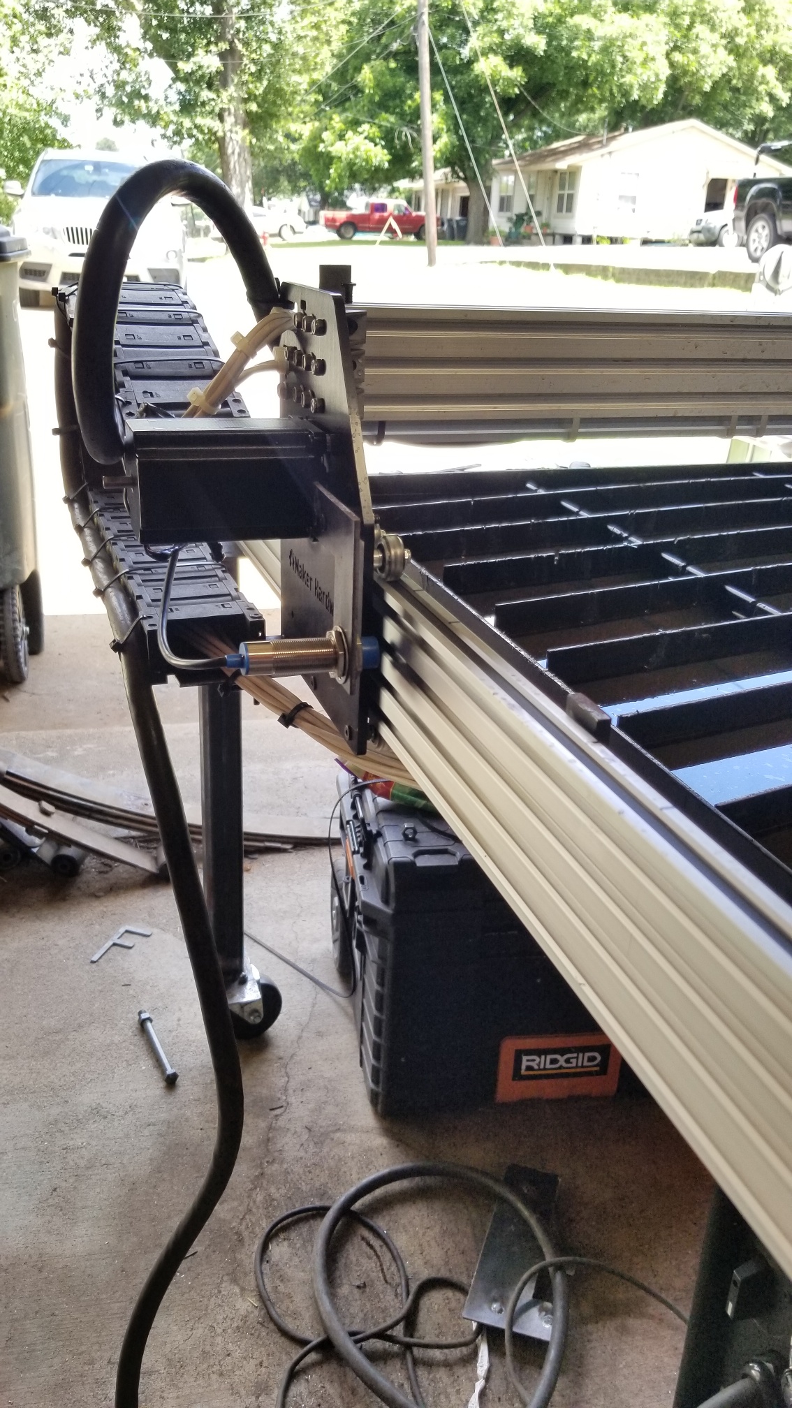

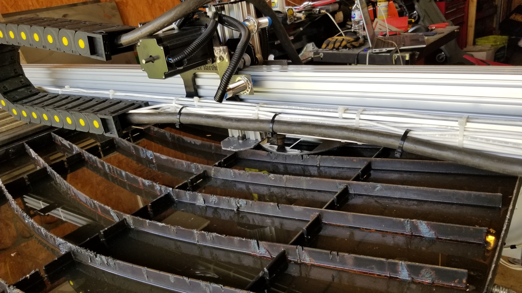

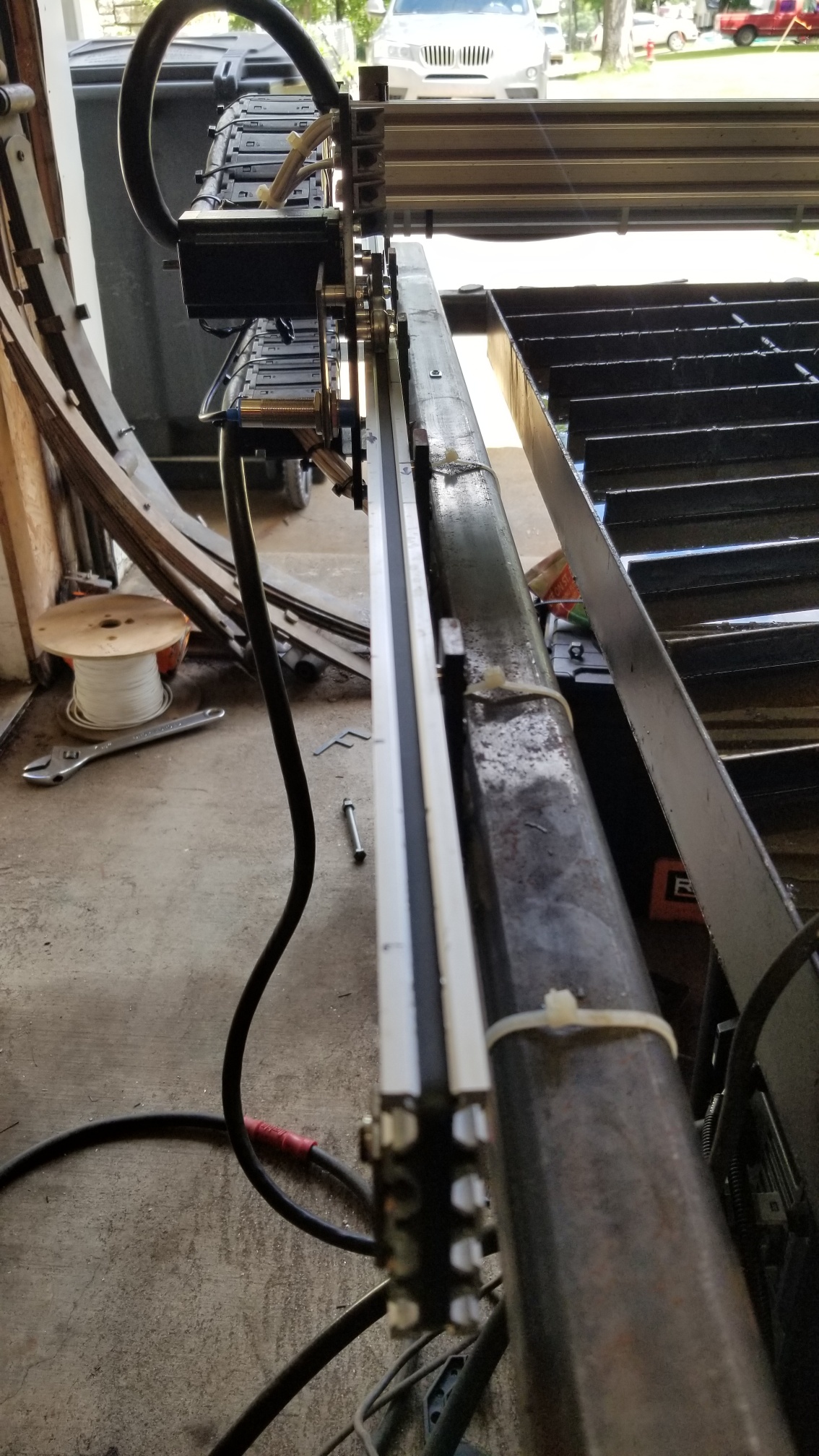

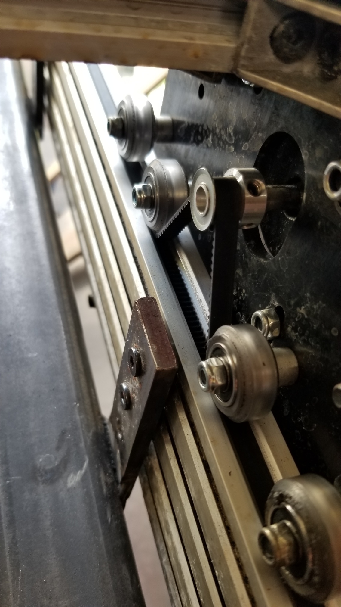

- dvn4life1972
- Posts: 401
- Thank you received: 173
03 Jun 2020 20:12 #169996
by dvn4life1972
Remaining pics.
- Posts: 21959
- Thank you received: 7478
03 Jun 2020 20:22 #169997
But the pictures do explain a lot, rubber bearings for one and the direct drive on that size of the machine are not good at all.
So now remains to check if those bearing do veer off course while moving, and setting the drives to 1 microstepping or full step, adjust the ini file to reflect that and do some more tests.
Be warned, at full step that machine is going to make some horrendous noises !
Replied by tommylight on topic My Newb Plasma Table Attempted Build
Have you seen some of my earlier builds? Some look much worse than this.Please don't mind my mess. I hate showing this thing being a rookie and all, all of you guys have some really nice builds.
