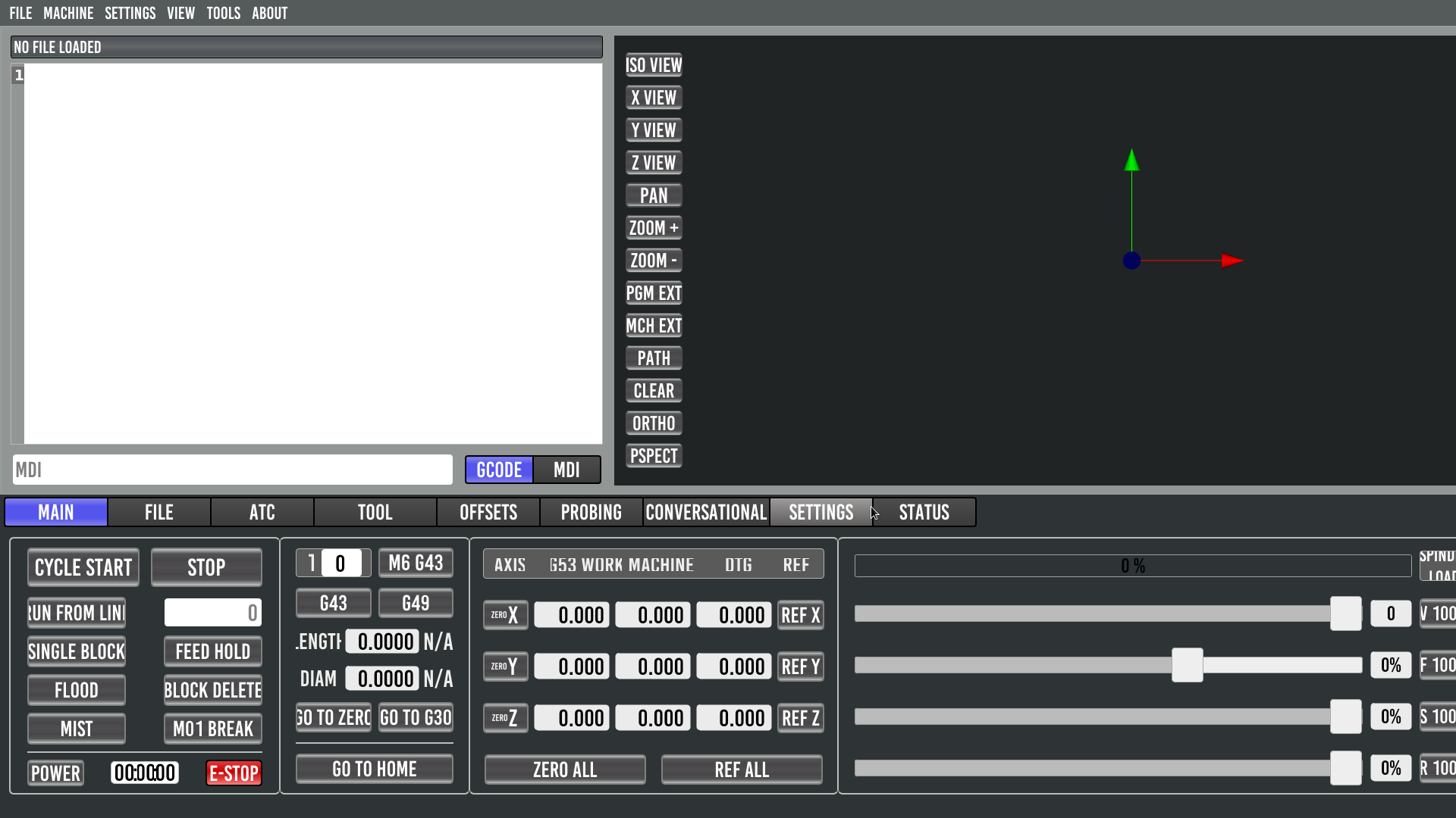

Probe Basic is throwing errors during start up, but still loads and I can home the sim. When I try to load my old working config (edited for new mesa sserial board & other changes) the same error shows up in the terminal (as with the sim), as well as hanging up for a long time.
When PB eventually loads, I can't come out of estop and power on the machine. I've tried editing HAL so there's nothing connected and i should be able to toggle the GUI buttons or directly in halshow, but nothing works.
Troubleshooting (starting from terminal and using LCNC config chooser)

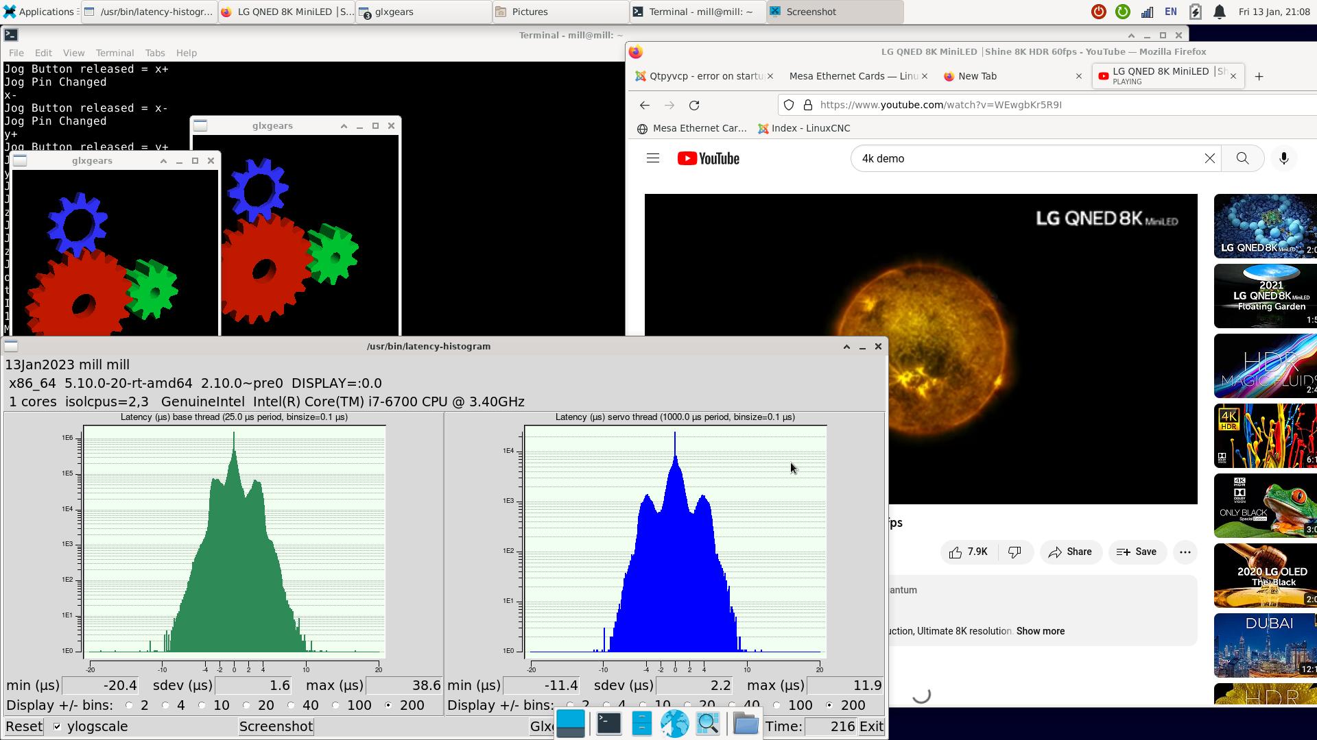

I think latency looks OK, screenshot attached. I ran the lcnc-hw script for a couple hours last night and no spikes showed up.
I've attached terminal outputs from multiple LCNC startups. HAL and INI were attached earlier and I've not made any significant changes.

- loads, no errors
- qtpyvcp (PB sim)
- loads, homes, error in terminal, resolution is wrong (screen cut off)
- qtpyvcp (PB_lathe_sim)
- loads, homes, resolution is wrong, no terminal errors
- qtpyvcp (PB my edited config)
- loads after delay seen in terminal, window is wrong, can't turn machine on

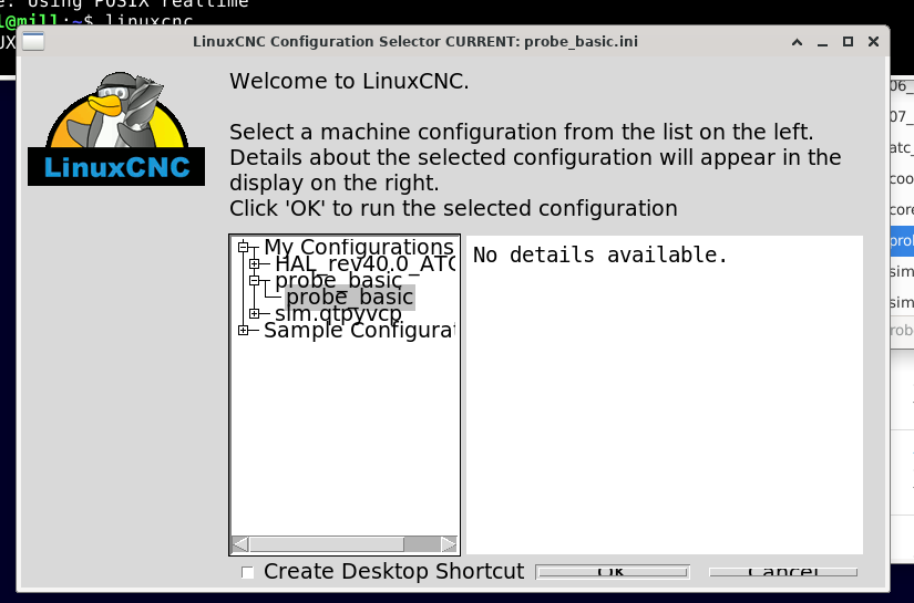

For PB_sim:
start lcnc in terminal, config chooser window shows up, and I select the probe_basic sim under My Configurations
For PB_lathe_sim:
start lcnc in terminal, config chooser opens, select sim.qtpyvcp, select XYZ, and select PB_lathe from menu

For PB_sim:
For PB_lathe_sim:
