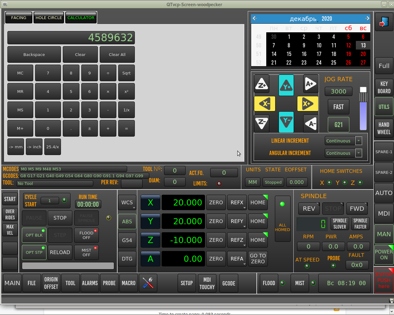

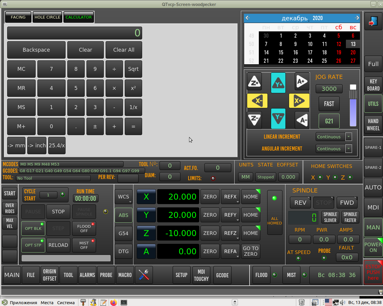

Replied by cmorley on topic Сustomization QTvcp
it does if you test the calculator directly.
I would guess that the font size gets overwritten from a stylesheet setting.
try something like:
try something like:
Calculator QLineEdit{
font: 25pt "Lato Heavy";
}Please Log in or Create an account to join the conversation.

13 Dec 2020 00:25 - 13 Dec 2020 00:41 #191813
by hottabich
Replied by hottabich on topic Сustomization QTvcp
Super!!! Works great! Now the calculator can be edited to your liking. I also addedRespect and respect for you.
Thank you!
Calculator QPushButton{
font: 13pt "Lato Heavy";
}Thank you!

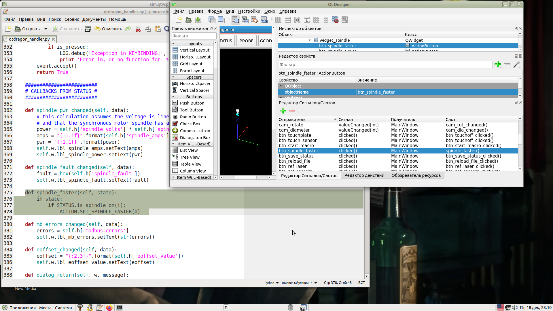

And please tell me how to programmatically disable the run in action button UP, Down function? This is for the safety of the car, I think so. Thanks for attention!
Last edit: 18 Dec 2020 10:00 by hottabich.
- Posts: 7368
- Thank you received: 2182
18 Dec 2020 11:40 - 18 Dec 2020 11:41 #192355
So this is the relevant code in action_button.py
it checks what spindle you wish to start (-1 means all spindles)
If the spindle is running it speeds them up.
If the spindle isn't running it starts it at the default spindle speed.
Here might be a function to add to the handler file to be called from a button.
You would need to use designer to connect a signal to it.
It assumes you only wish to speed up the spindle number 0
Chris
elif self.spindle_up:
if self.joint == -1:
a = 0
b = INFO.AVAILABLE_SPINDLES
else:
a = self.joint
b = self.joint +1
for i in range(a,b):
if STATUS.is_spindle_on(i):
ACTION.SET_SPINDLE_FASTER(i)
else:
ACTION.SET_SPINDLE_ROTATION(linuxcnc.SPINDLE_FORWARD,
INFO['DEFAULT_SPINDLE_{}_SPEED'.format(i)],i)Here might be a function to add to the handler file to be called from a button.
def spindle_faster(self, state):
if state:
ACTION.SET_SPINDLE_FASTER(0)Chris
Last edit: 18 Dec 2020 11:41 by cmorley.
- hottabich
- Posts: 574
- Thank you received: 96
18 Dec 2020 15:14 #192389
by hottabich
Did as in the screenshot did not change. What am I doing wrong?
- Posts: 7368
18 Dec 2020 17:10 #192406
Did you remove all builtin actions from the action button?
This new function should used instead of any qtvcp built in actions.
In fact it could be called from a normal QPushButton.
I would also add a temporary print statement to confirm if the new function is being called.
