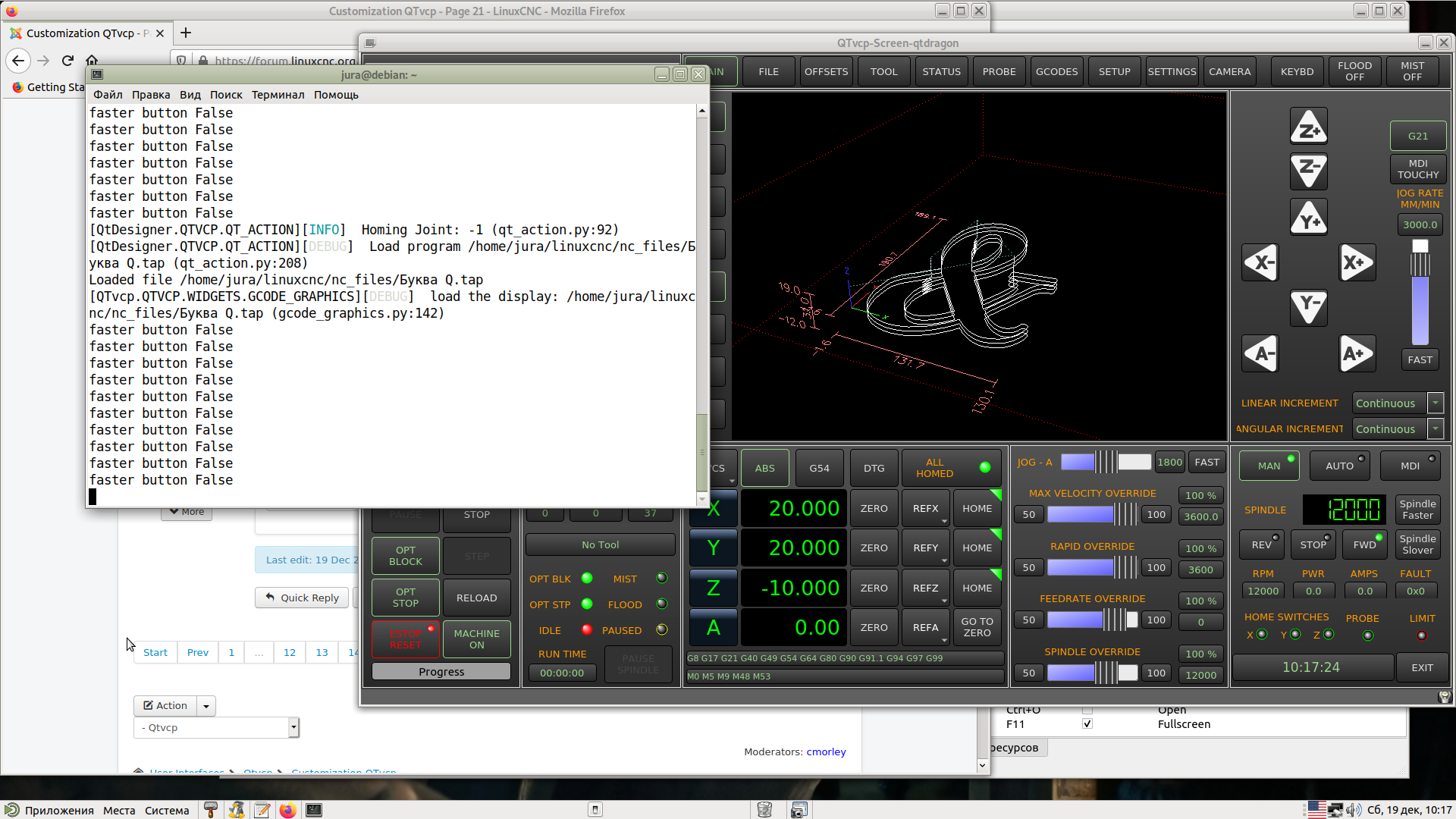

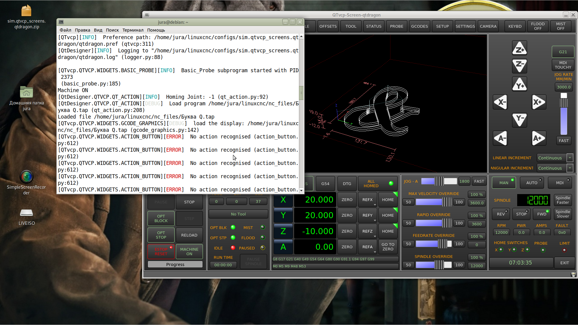

Action button. Converting to QPushButton no reaction.
No action recognised (action_button.py:612)Please Log in or Create an account to join the conversation.
- Posts: 7368
- Thank you received: 2181
19 Dec 2020 06:20 #192426
Replied by cmorley on topic Сustomization QTvcp
did you add a print statement to the function?
- hottabich
- Posts: 574
- Thank you received: 96
19 Dec 2020 06:34 #192428
by hottabich
Replied by hottabich on topic Сustomization QTvcp
How to do it?
- Posts: 7368
19 Dec 2020 07:37 - 19 Dec 2020 07:38 #192432
def spindle_faster(self, state):
print 'faster button', state
if state:
if STATUS.is_spindle_on(0):
ACTION.SET_SPINDLE_FASTER(0)
Last edit: 19 Dec 2020 07:38 by cmorley.
- hottabich
- Posts: 574
19 Dec 2020 08:20 #192435
by hottabich
Happened faster button False.
- Posts: 7368
19 Dec 2020 08:47 #192439
Good - ok the state is never True so the rest of the code doesn't get run.
I see now that you used 'clicked()' as the signal so that's why it's always false.
No problem, change it to this:
def spindle_faster(self):
ACTION.SET_SPINDLE_FASTER(0)Please Log in or Create an account to join the conversation.

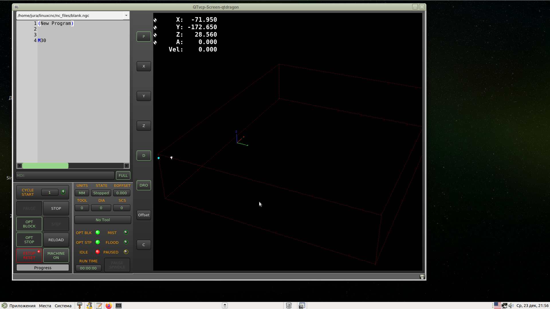

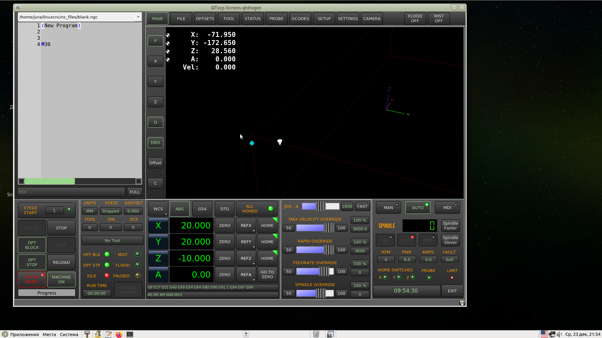

In full screen mode, I added a DRO display to the display. Everything is fine, only the A axis has one more sign and is converted. It can be fixed? But that's good enough.
- Posts: 7368
24 Dec 2020 00:35 #193049
you want to change the DRO format of the rotary axis? 0.000 to 0.00?
I just pushed to master a way to do this:
You can change others too:
self.w.NAME_OF_GCODE_DISPLAY.dro_deg = "% 9.2f"You can change others too:
.dro_in = "% 9.4f"
.dro_mm = "% 9.3f"
.dro_deg = "% 9.2f"
.dro_vel = " Vel:% 9.2F"
