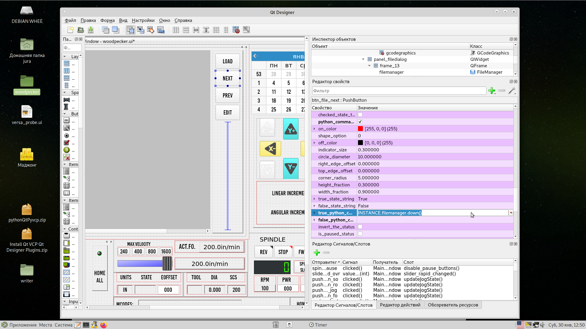

30 Jan 2021 04:56 #197137
by hottabich
Replied by hottabich on topic Сustomization QTvcp
If there is room, add two buttons like the screenshot for QTabWidget.
- Posts: 7368
- Thank you received: 2182
30 Jan 2021 11:20 #197166
Replied by cmorley on topic Сustomization QTvcp
You could even take Hottabich's idea further - use a stacked widet and put a label and two buttons above it - basically make your own tab widget.
Hottabich you interested in donating one of your screen to linuxcnc? I was thinking the X1/dragon combo one - do you call that one woodpecker too?
