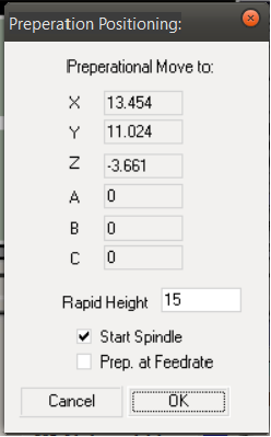

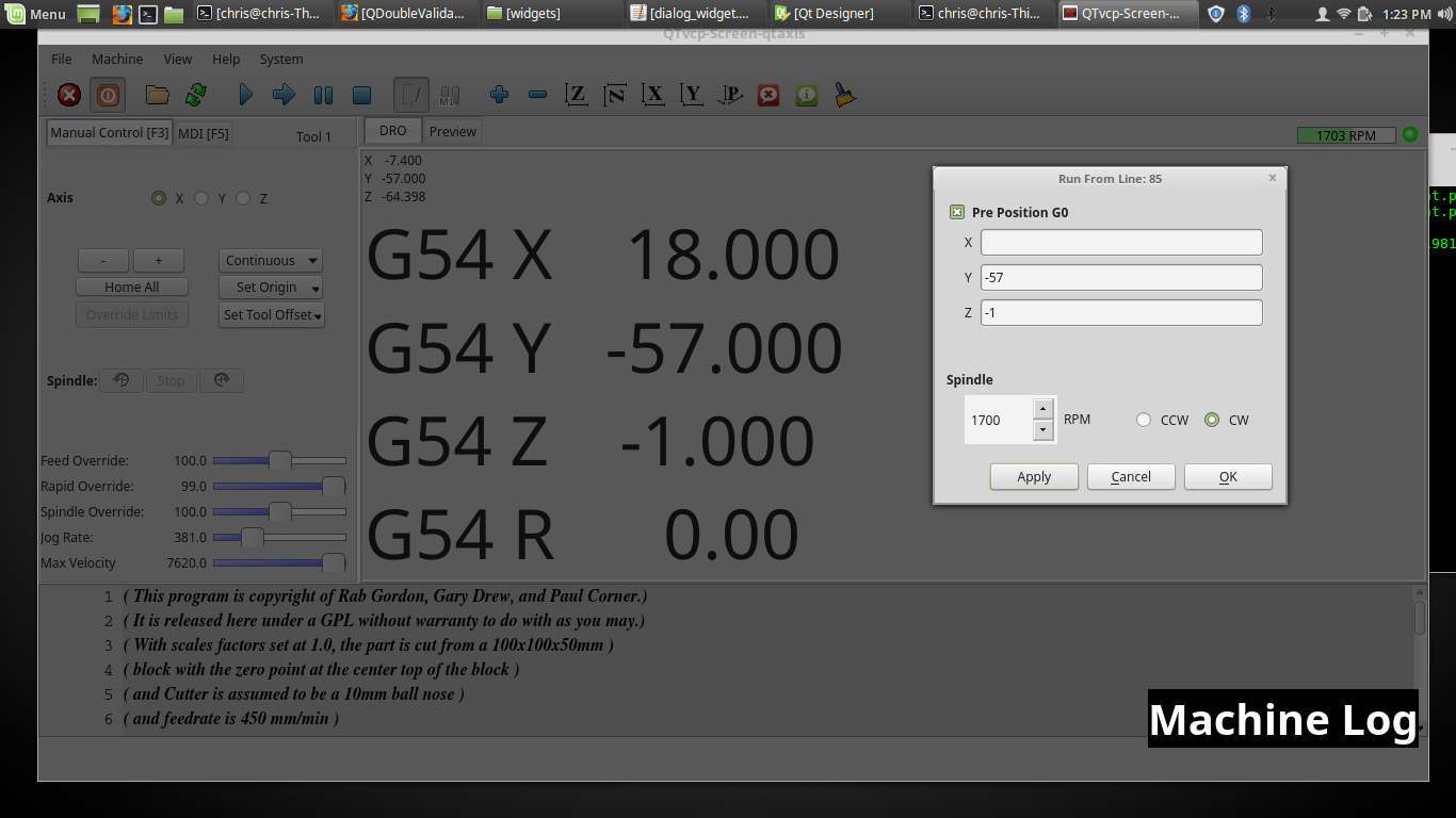

23 Apr 2021 18:24 - 23 Apr 2021 18:29 #206883
by hottabich
Replied by hottabich on topic Сustomization QTvcp
Hello. And you can extend the function of the initial line to look like as in the screenshot dialog box.
I implement it with macros. It is very good to start from any line or GCode block from scratch blanks.
Or at least add a safe height to the function start line number.
Last edit: 23 Apr 2021 18:29 by hottabich.
- Posts: 7368
- Thank you received: 2181

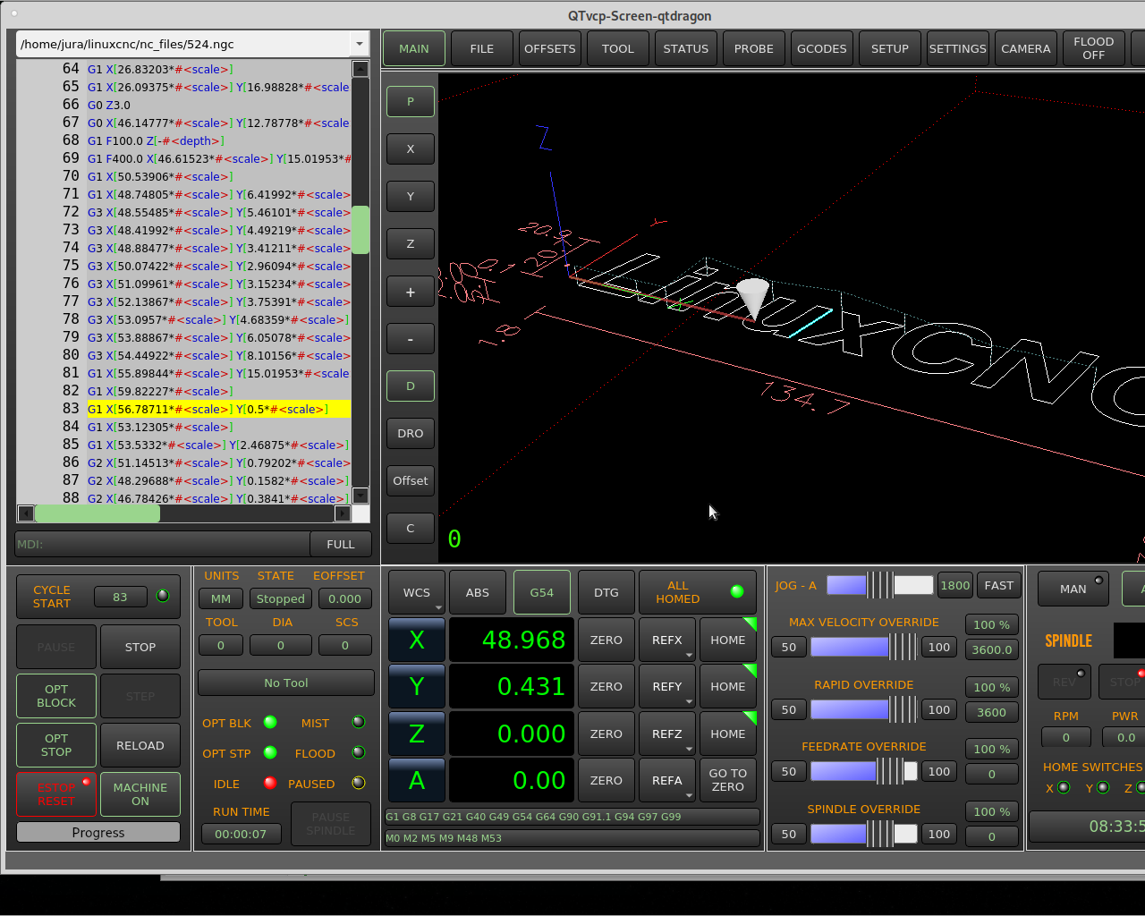

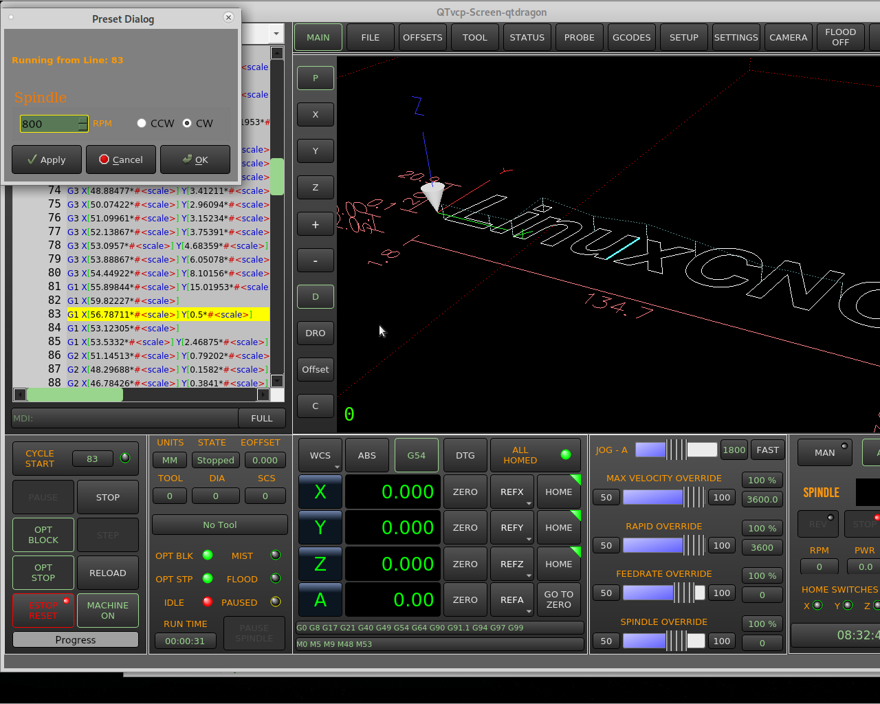

05 May 2021 14:14 #207972
Replied by cmorley on topic Сustomization QTvcp
Sorry I missed this - busy working long hours - is this to rapid to a specific point before restarting?
