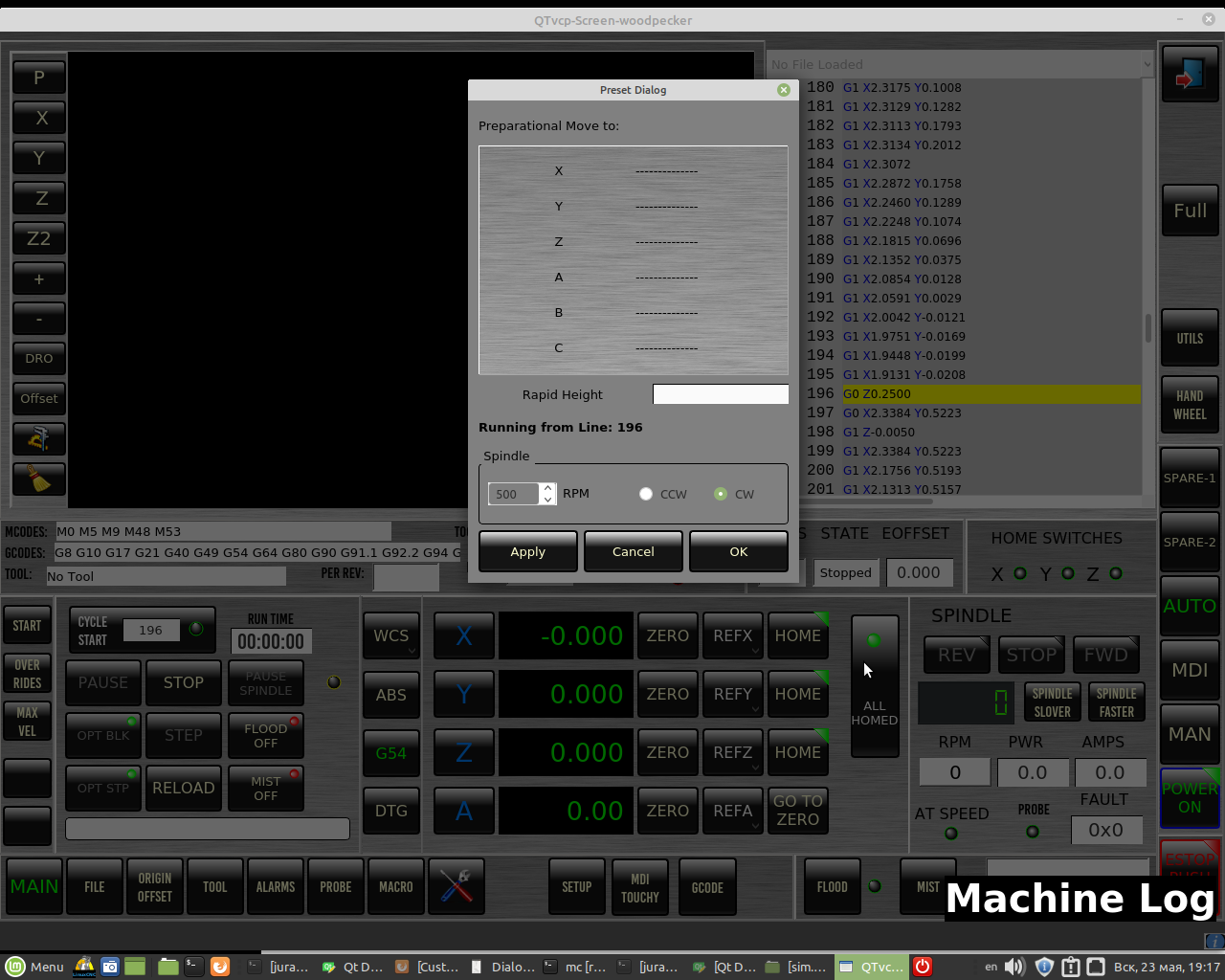

Almost like that. For now dialogue window is missing an option to set up safe height to start from line execution. Dialog dro label x, y, z.... coordinate line number. Is it possible to have such functionality at LinuxCNC? Thanks in advance

At the moment there is no way to start work from scratch of the workpiece from the selected line. G54 (x0,y0,z0) Start line number, lifting the cutter to a given safe height, starting the spindle, pause for 5 seconds, the tool goes to the coordinates of the selected line and lowers along the z, work is in progress. This is relevant after shutdown of the scheduled and emergency machine. Thanks for attention!

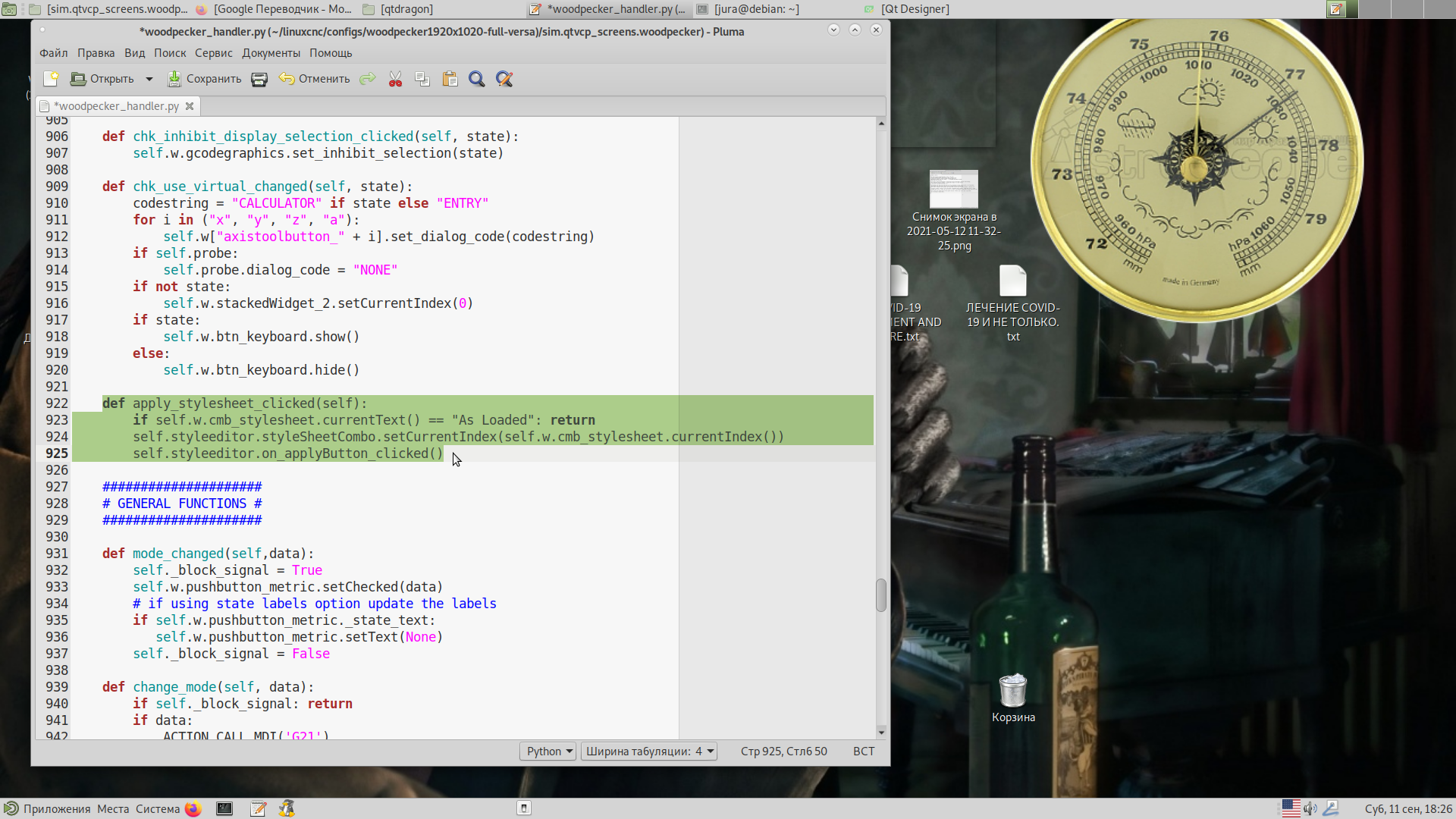

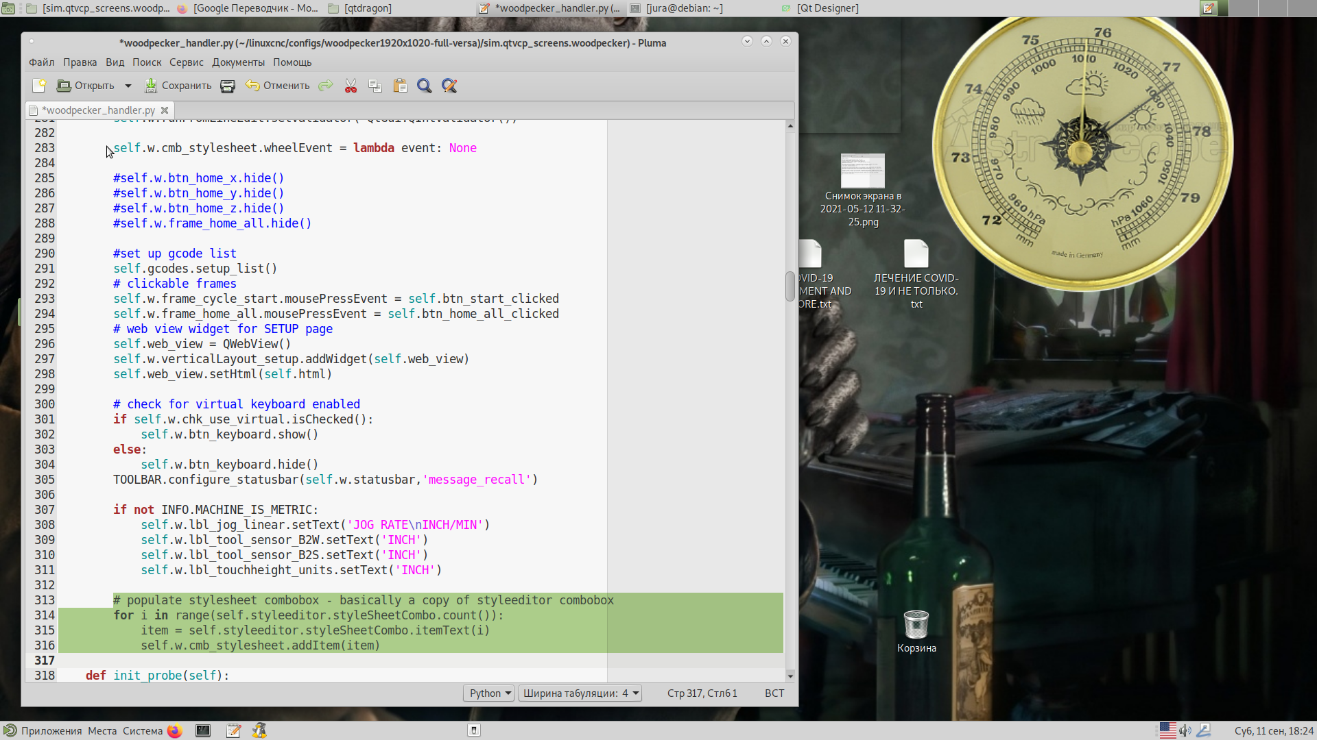

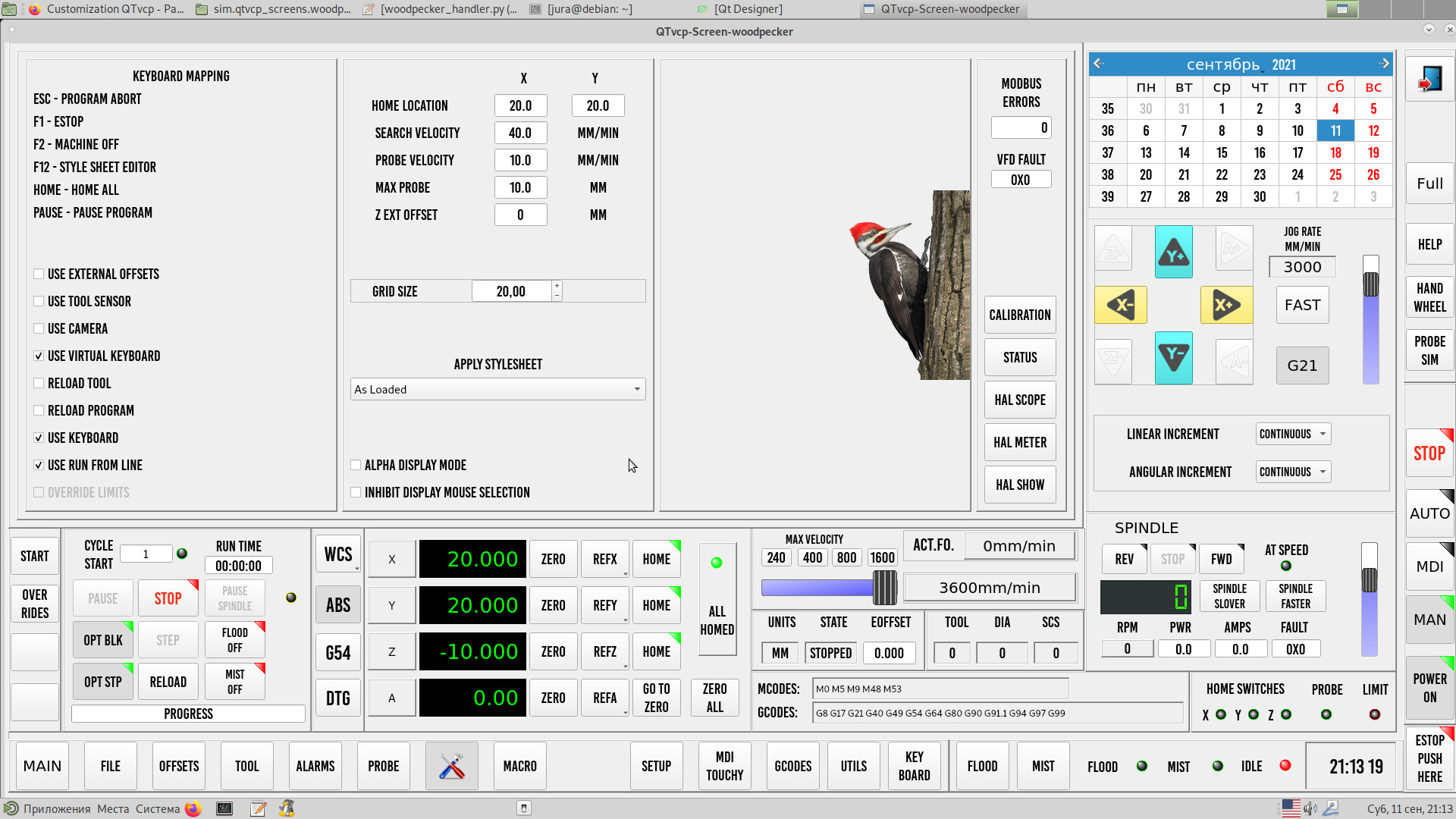

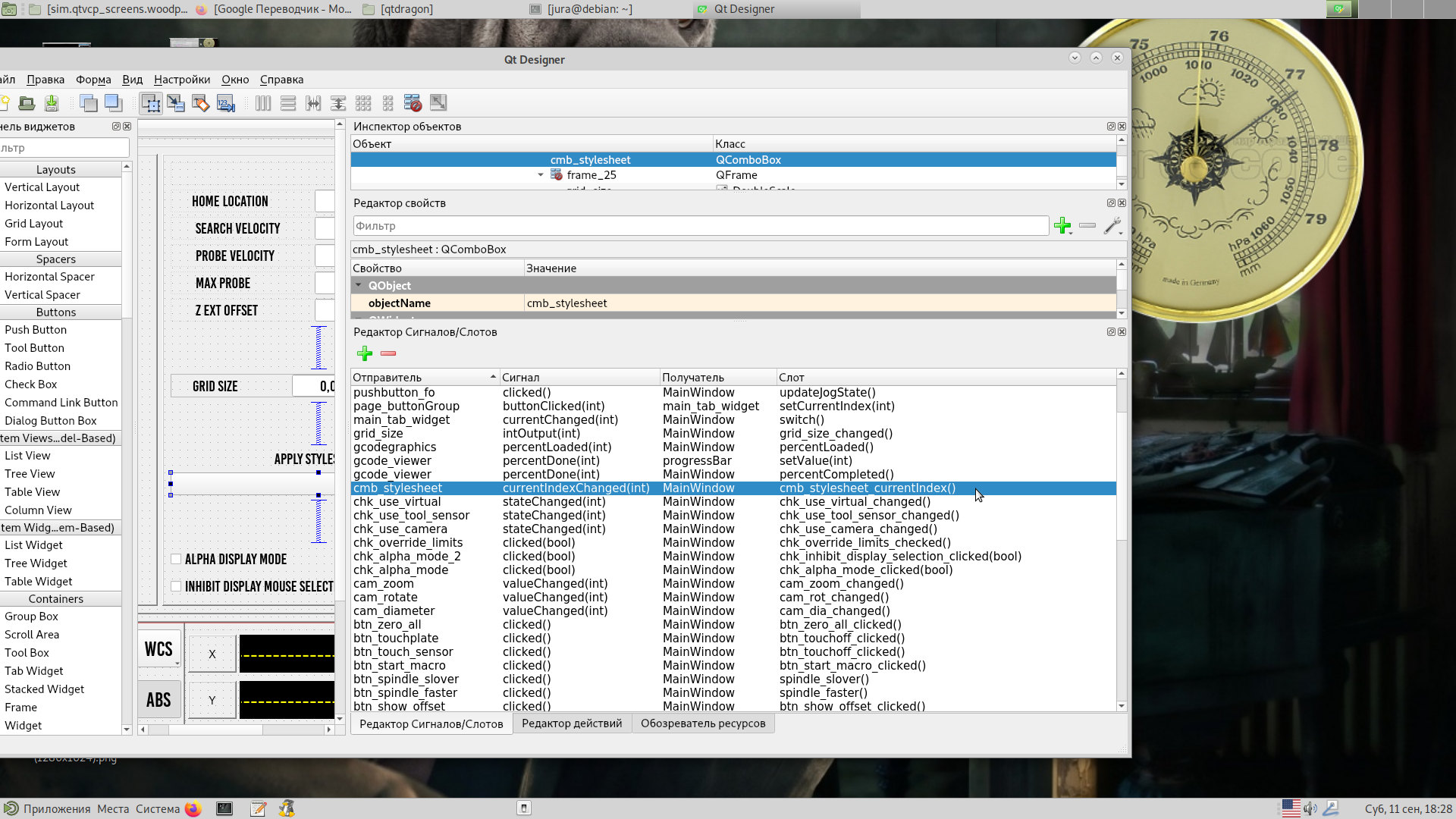

[justify]Hello! I want to add to the woodpecker from QtDragon hd master apply_stylesheetCombo. Please help to register correct signal slot. Thanks![/justify]

11 Sep 2021 12:54 - 11 Sep 2021 12:55 #220237

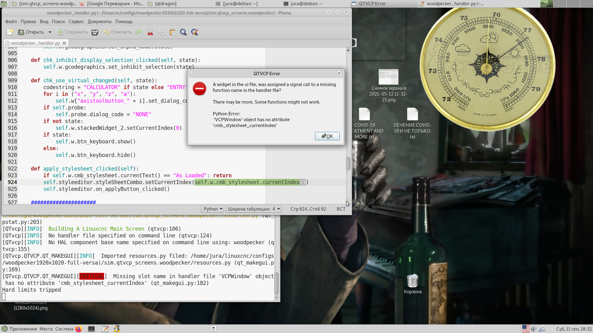

Replied by cmorley on topic Сustomization QTvcp
Try this (untested)
In designer change the slot name from 'cmb_stylesheet_curentindex()' to 'apply_stylesheet_clicked(int)'
change function in handler file to:
def apply_stylesheet_clicked(self, index):
self.styleeditor.styleSheetCombo.setCurrentIndex(index)
self.styleeditor.on_applyButton_clicked()
Last edit: 11 Sep 2021 12:55 by cmorley.

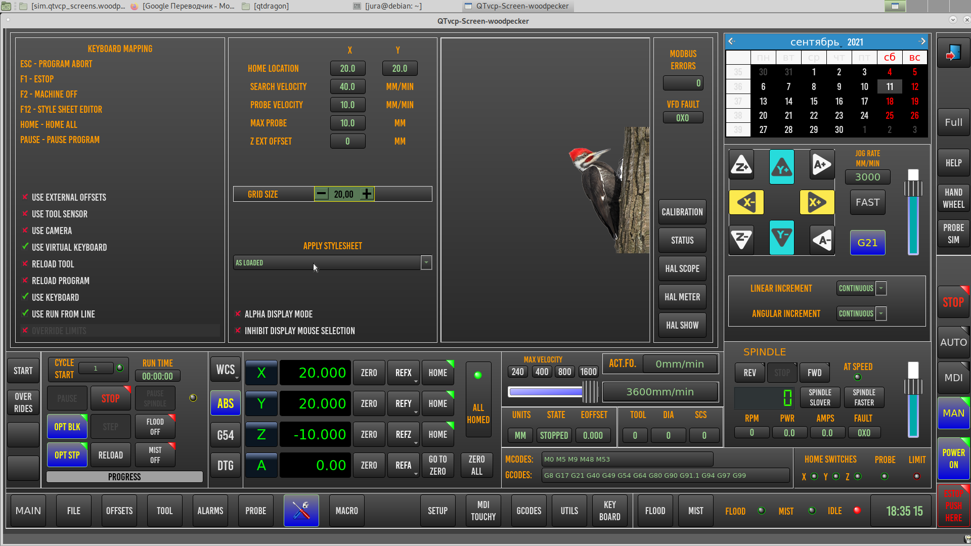

11 Sep 2021 13:16 - 11 Sep 2021 13:19 #220244
by hottabich
Replied by hottabich on topic Сustomization QTvcp

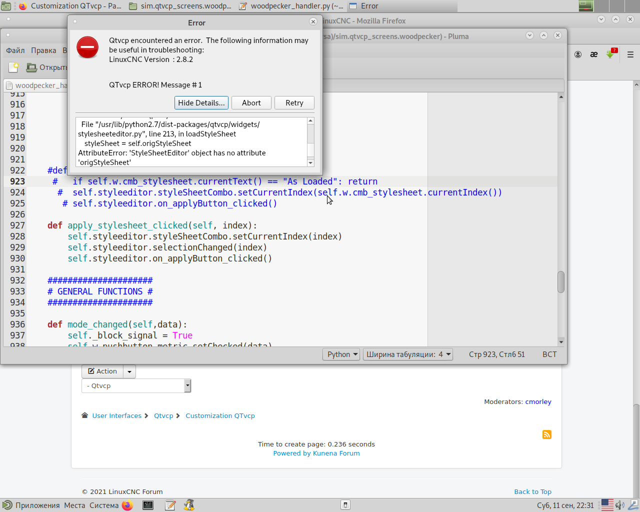

Thank you, now it's switching the stylesheet. But also default stylesheet doesn't apply. (please see screenshot)
Stylesheet .gss files are located in config directory. Linux CNC 2.8.2
Last edit: 11 Sep 2021 13:19 by hottabich.
- Posts: 7368
- Thank you received: 2182
11 Sep 2021 13:34 #220247
See if this helps:
self.styleeditor.selectionChanged(index)

11 Sep 2021 14:32 - 11 Sep 2021 14:39 #220250
by hottabich
Cathed an error.
Fixed, and now it works
if self.w.cmb_stylesheet.currentText() == "As Loaded": return
Thank you so much!
Thank you so much!

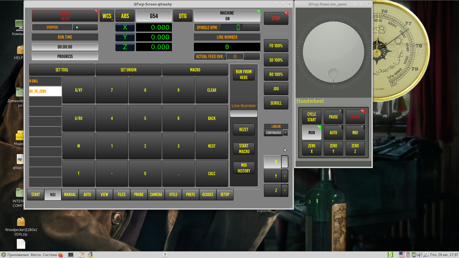

29 Oct 2021 09:51 #224655
by hottabich
Hello! How to register so that when choosing tab_mdi TabWidget interface went to mdi_mode. Thanks!
