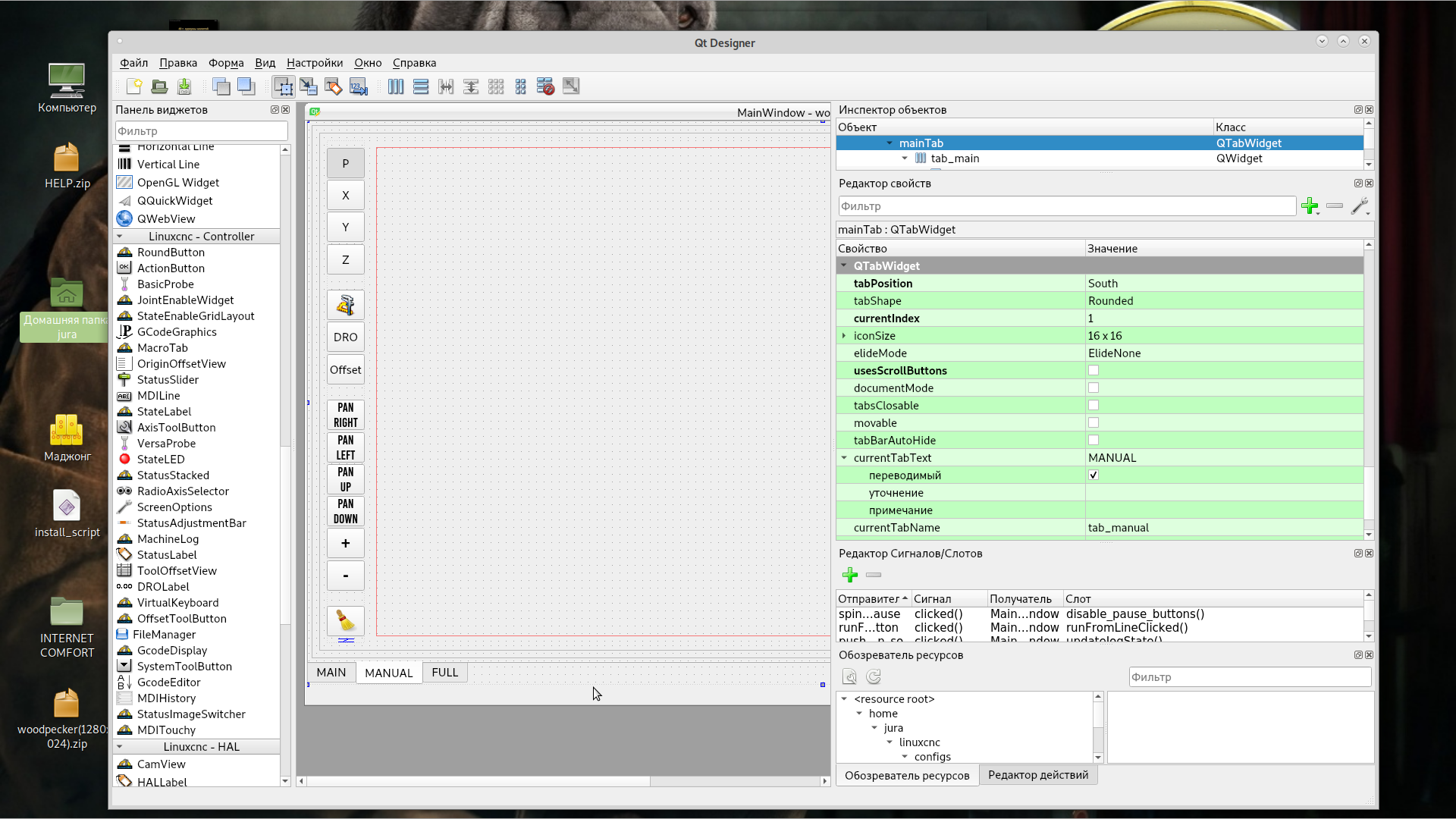

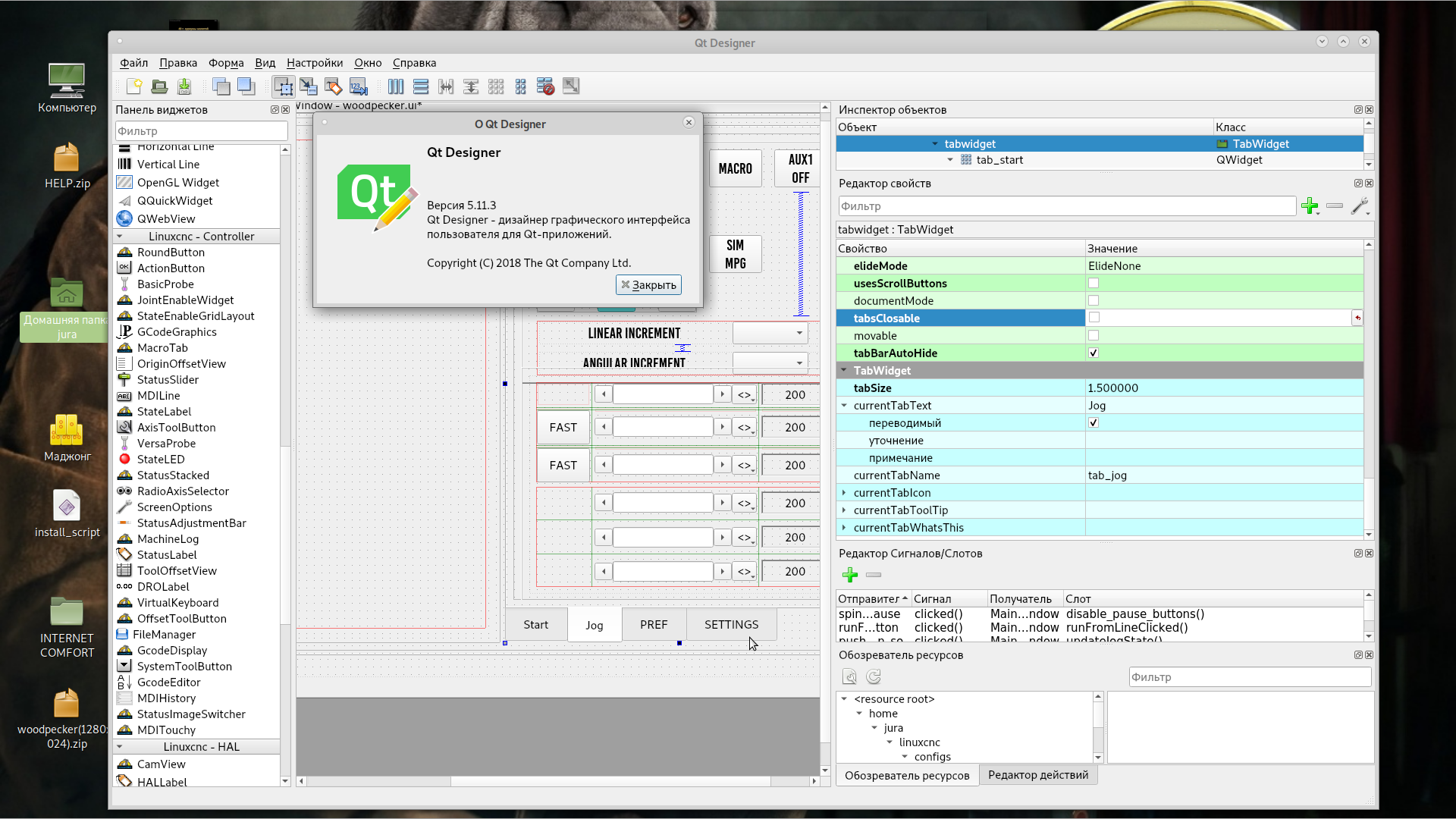

Hello! Please tell me how to change the height of the button in TabWidget and tabBarAutoHide? In QTabWidget, the height of the button can be changed in the StyleEditor.
- Posts: 7368
- Thank you received: 2182
23 Nov 2021 13:31 #227428
Replied by cmorley on topic Сustomization QTvcp
Try changing the icon size in the tab widget
- hottabich
- Posts: 574
- Thank you received: 96
23 Nov 2021 14:46 #227431
by hottabich
Replied by hottabich on topic Сustomization QTvcp
TabSize, icon_size, autoHide change nothing.
- Posts: 7368

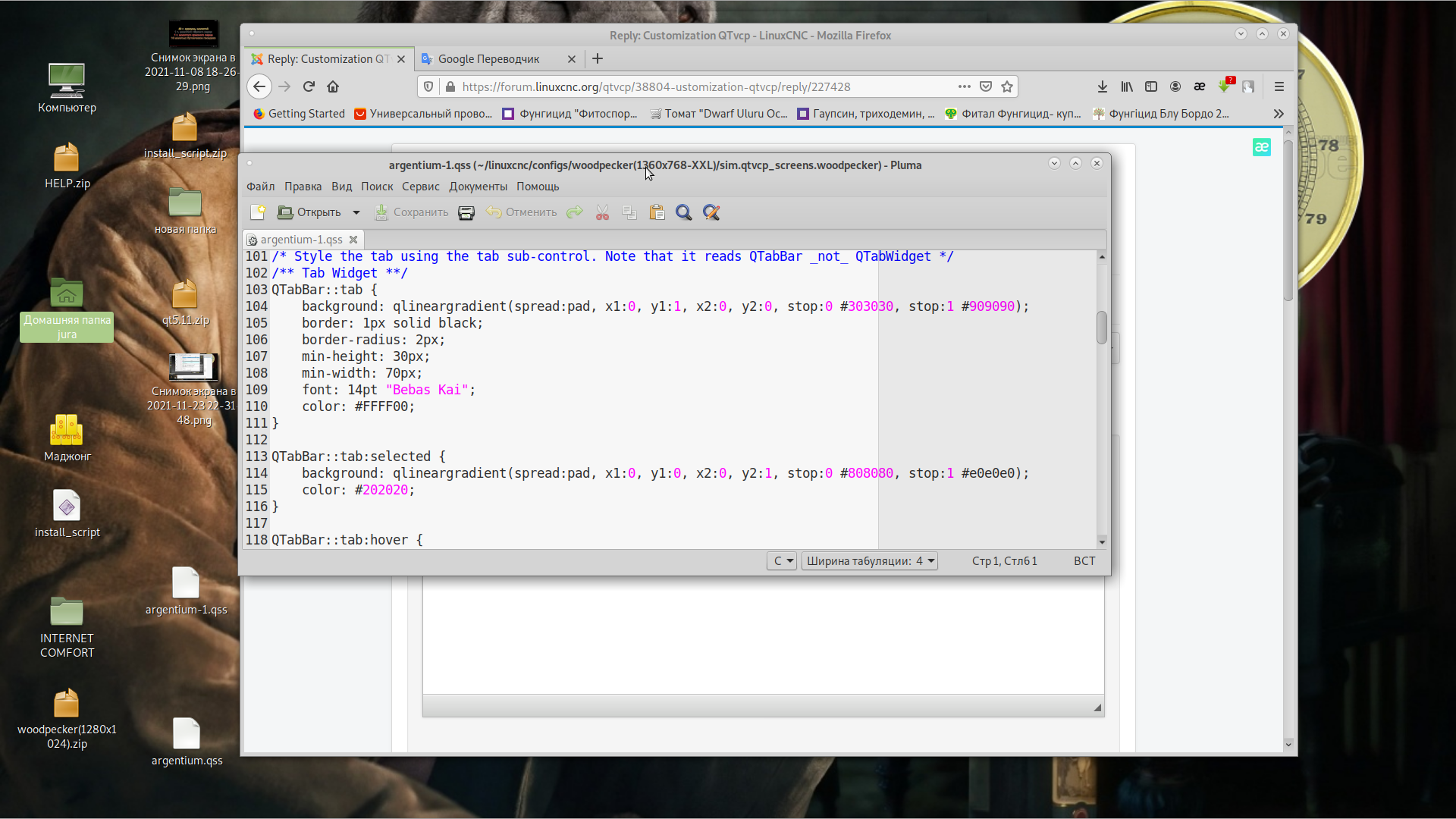

23 Nov 2021 15:38 #227436
Then style sheets is probably the only way:
doc.qt.io/qt-5/stylesheet-examples.html#...abwidget-and-qtabbar
- hottabich
- Posts: 574
23 Nov 2021 17:23 #227453
by hottabich
Replaced TabWidget with QTabWidget and it's fine. Thank you for the attention!

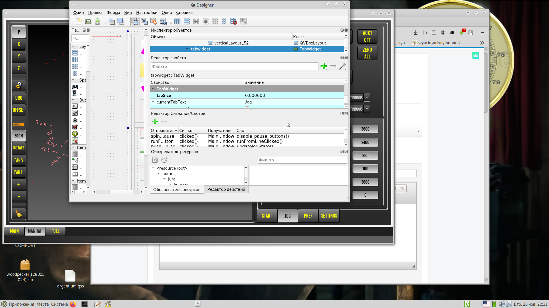

- Posts: 7368
23 Nov 2021 17:39 - 23 Nov 2021 17:40 #227455
Sorry i missed it was TabWidget not QTabWidget.
There is a property tabSize that might have helped
Last edit: 23 Nov 2021 17:40 by cmorley.
- hottabich
- Posts: 574
24 Nov 2021 03:40 #227490
by hottabich
TabSize in the constructor does not work, I asked about this in the post above. Thanks!

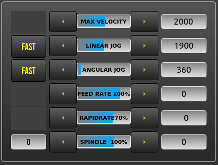

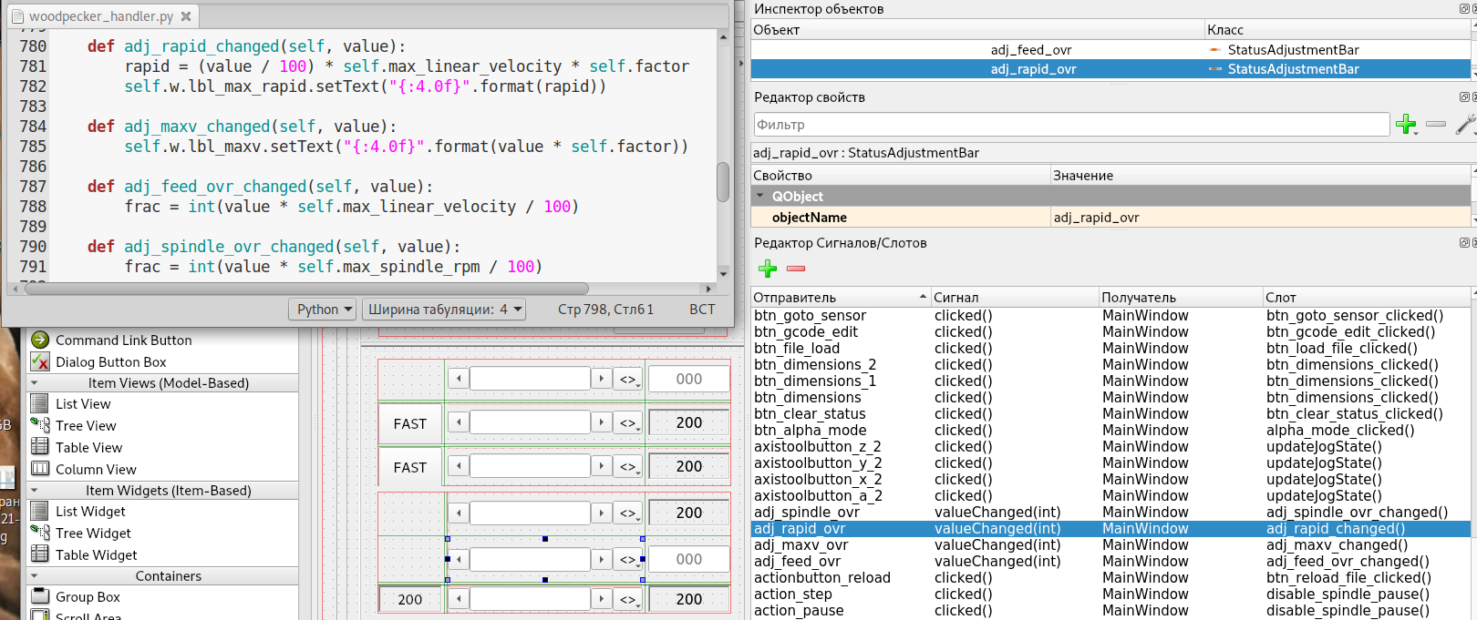

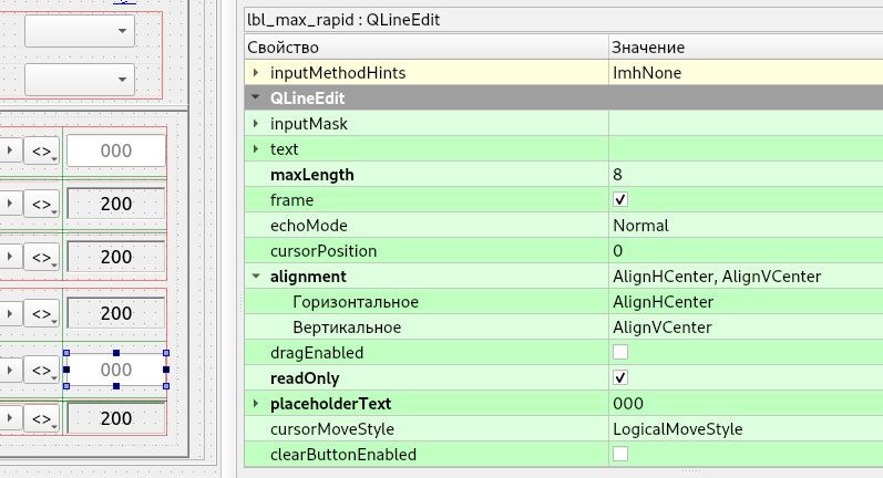

26 Nov 2021 14:50 #227685
by hottabich

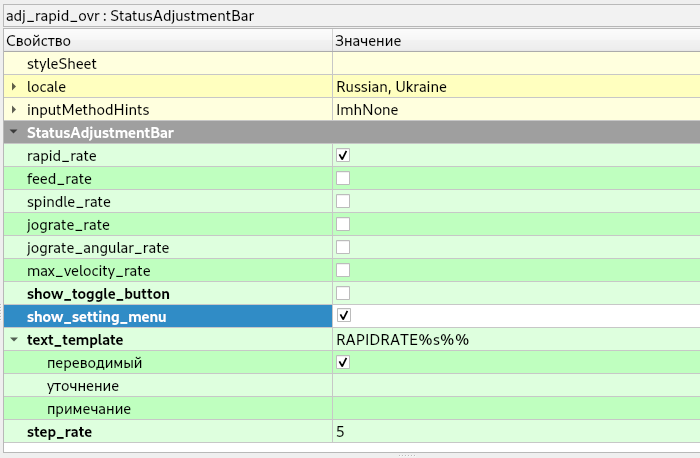

Please tell me what is wrong with the rapid_rate adjustment. The numeric value of current_rapid_rate is not displayed.
- Posts: 7368
26 Nov 2021 16:12 #227694
I would add a print statement in the function adj_rapid_changed to confirm it's being called.
I would guess a variable such as self.factor = 0
Chris
Chris
- hottabich
- Posts: 574
26 Nov 2021 23:39 - 26 Nov 2021 23:53 #227724
by hottabich
My mistake. For python 3 it works as is. This is how it works with python 2. Thanks!
def adj_rapid_changed(self, value):
rapid = (float(value) / 100) * self.max_linear_velocity * self.factor
self.w.lbl_max_rapid.setText("{:4.0f}".format(rapid))
Last edit: 26 Nov 2021 23:53 by hottabich.
