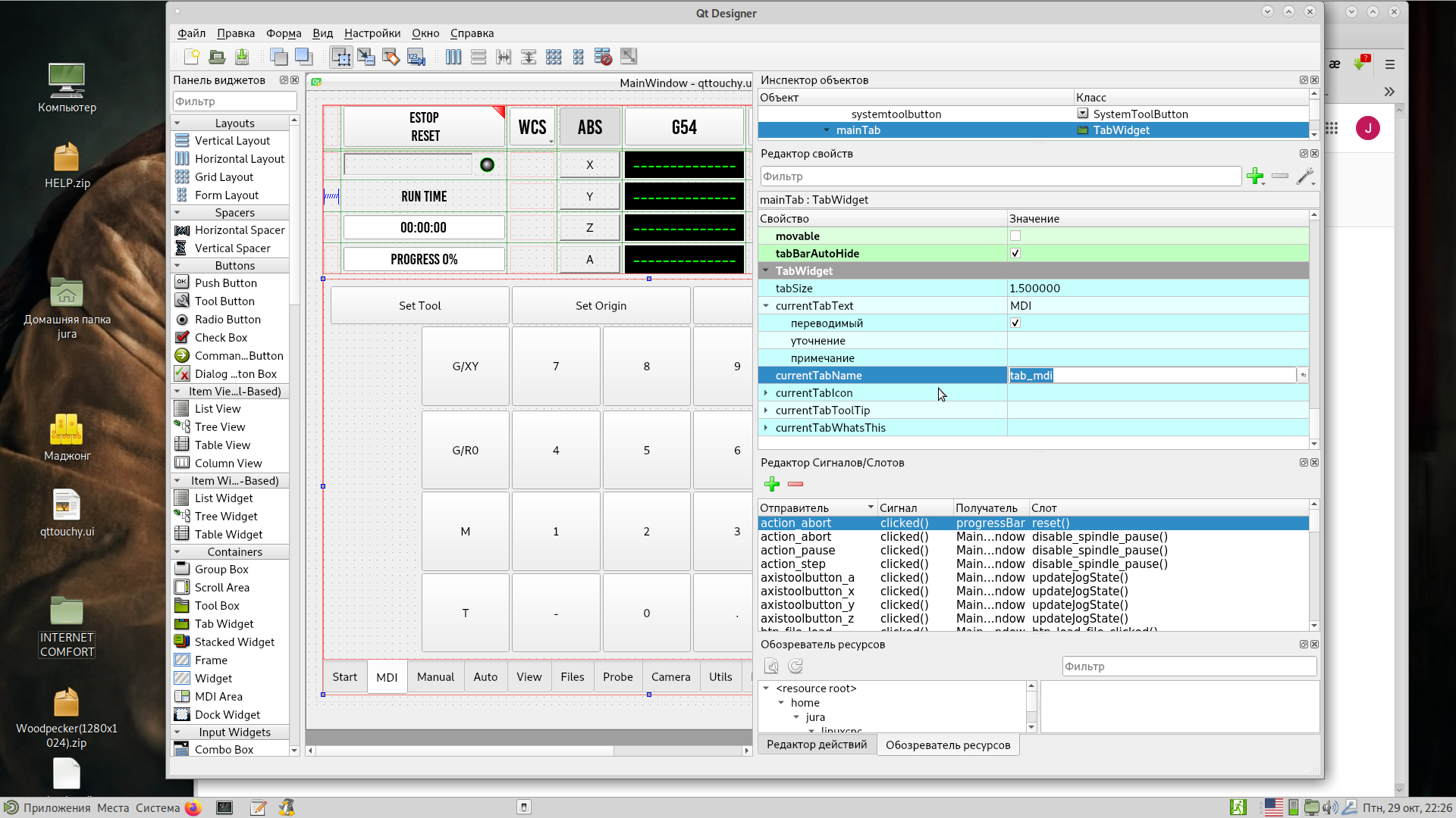

You can add a signal in designer to tab_widget that is sent when the tab changes.
currentChanged(int) pobably would do what you want.
I don't see the sender (tab_mdi) in the constructor.
self.w.main_tab_widget.setCurrentIndex(TAB_MDI)
self.w.tab_mdi.setChecked(True)
ACTION.SET_MDI_MODE()
self.w.mdi_mode_button.setChecked(True) I need to somehow link it in the handler. I think so.

The question is closed. Did this:
def btn_start_macro_clicked(self):
if STATUS.is_mdi_mode():
self.w.tab_mdi
print 'run MDI'
self.w.mditouchy.run_command()
return
Thank you for the attention!

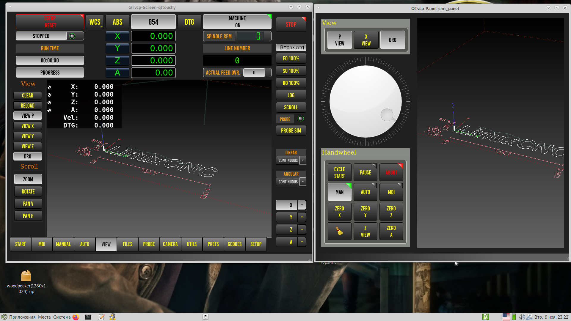

Modified sim_panel.ui for full screen. Please tell me how to add to sim_panel view dro?
- Posts: 7368
- Thank you received: 2181
10 Nov 2021 04:15 #225917
Replied by cmorley on topic Сustomization QTvcp
If you want to turn the embedded DRO on and off this should work:
self.w.GCODE_GRAPHICS_NAME.setProperty('_dro',True)
self.w.GCODE_GRAPHICS_NAME.setProperty('_dro',False)

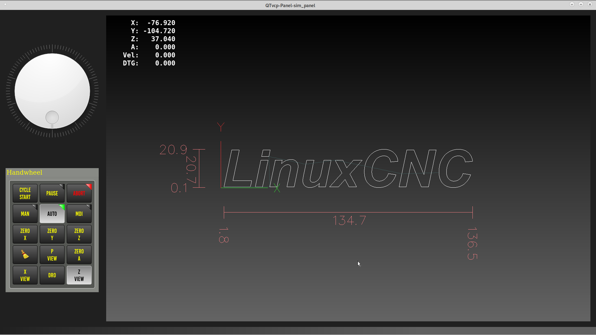

Thanks, but where to register for sim_panel.ui?If you want to turn the embedded DRO on and off this should work:
- Posts: 7368
10 Nov 2021 13:55 #225987
you would add a handler file called sim_panel_handler.py in your config folder.
- hottabich

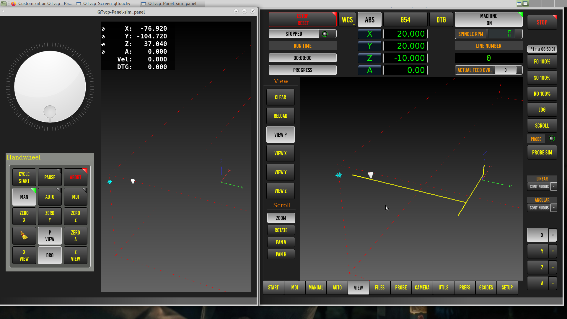

Replied by hottabich on topic Сustomization QTvcp
Thanks. Ideally used using widgetswitcher.
But this is probably impossible. What do you think?
Thanks to your advice, it turned out like this in the screenshot.
Last edit: 10 Nov 2021 21:07 by hottabich.
- Posts: 7368
11 Nov 2021 02:10 #226053
So I might not understand what you are wanting.
Widgetswitcher is for moving a widget around on the screen. you asked about setting the DRO property on and off.

With sim_panel_handler.py dro is included on and off, everything is fine. Then I had an idea aboutmoving gcodegraphics into a separate scalable window for any monitor, but this is not possible. I think so.
Thanks for your help.
