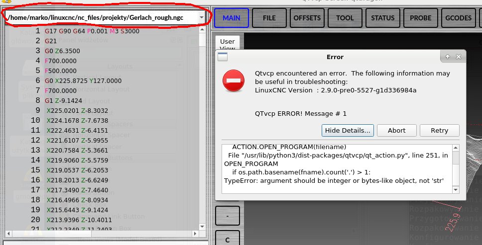

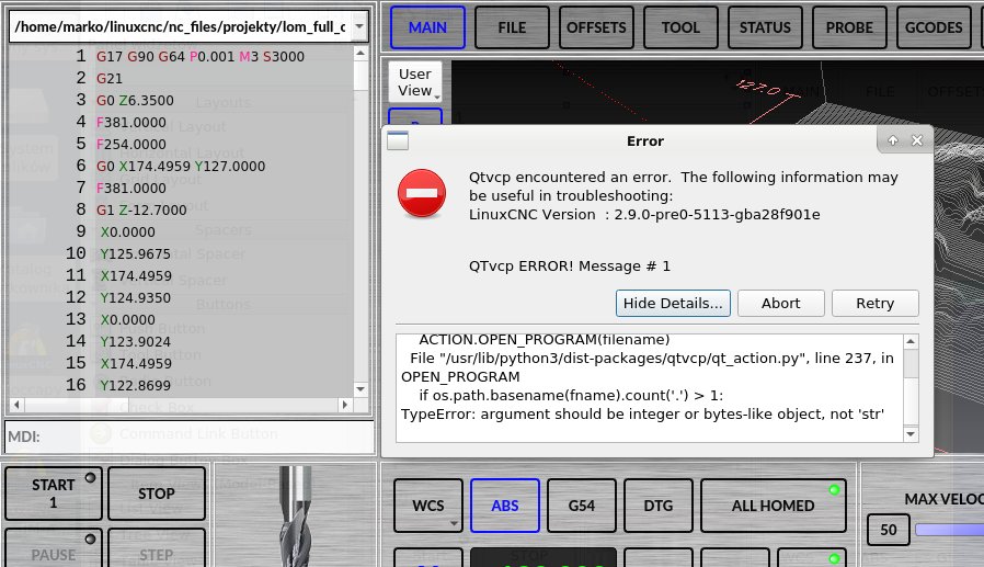

I found another bug in man and mdi mode:
If you press the field with the history of files on the code and again press on
file path then i get an error. I think it's a python2 leftover.
The "fname" variable looks like this b '/home/marko .... gile.ngc' , but I don't know where to change it to make it good'

I'm guessing you are using buildbot binaries to get linuxcnc?
It seems buildbot is behind. My files are different.
I'm having trouble deciphering you instructions.
'history of files' - do you mean the file_manager widget on the file tab?

Sorry, I use google translator, not everything can be understood.I am using to test linuxcnc 2.9 in a virtual machine.After updating linuxcnc I have files that can be found at github.com/LinuxCNC/linuxcnc/, so I think they are the latest. The files history is the space above the g code window just like in the screenshot.

Replied by cmorley on topic Error in tool_offsetview.py
Thank you,
yes looks like you have the same file now.
Yes you are right python2/3 error in the handler file.
Pushed the fix to master.
Chris

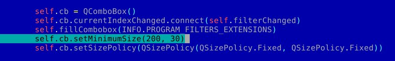

1. In the fole window there is too narrow a file type selection bar as in the screenshot. In my file, I fixed this by changing line 125 in file_manager.py
