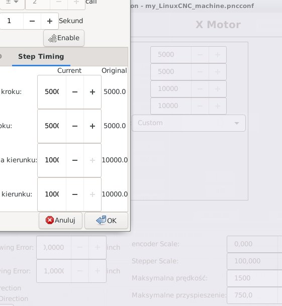

widened the step timing spinbox in pncconf.
Let me know if that's better.

19 Mar 2022 11:45 #237710
by MarkoPolo
Replied by MarkoPolo on topic Error in tool_offsetview.py

Replied by cmorley on topic Error in tool_offsetview.py
Ok improved pncconf's test/tune dialog.
Sure I would like to look at your changes.
