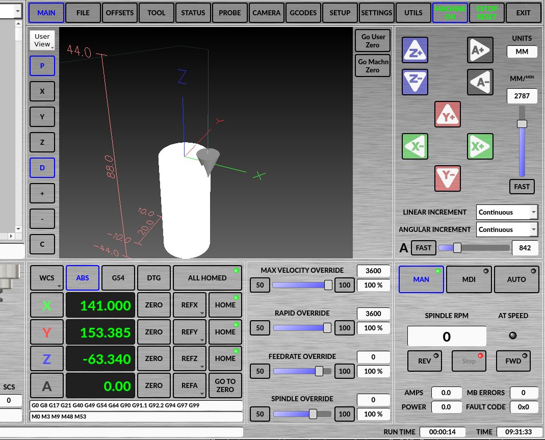

They are now without that white border, the Estop is a bit smaller and it has the effect of a pressed button and that green LED ...

What do you think about such changes to move the jog-a to the place of manual movements? I have such suggestions.
Marek
Marek
- Posts: 7368
- Thank you received: 2181
02 May 2022 09:10 #241838
Replied by cmorley on topic Error in tool_offsetview.py
Seems pretty reasonable to me.

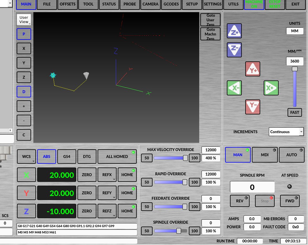

I'm sending layout changes. Modified the latest qtdragon.ui file.
There is also my theme file, maybe someone will like some color on this cold metal.

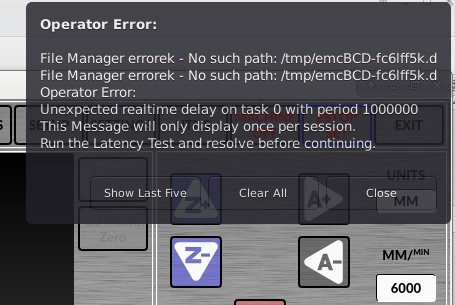

In case of using "utils" qtdragon after exiting the program deletes the directory from tmp and after restart it complains that there is no such file. It starts to irritate me when I turn qtragon on and off a lot while testing the program. He can do this to delete the directory from tmp only when a new project comes out, or something else ..?

with the screen closed, check your preference file. look fir similar to this:
[FILEMANAGER_JUMPLIST]
/home/chris/linuxcnc/nc_files/examples = /home/chris/linuxcnc/nc_files/examples
erase the tmp file paths and save the file.
start the screen
That should fix it.
start the screen
That should fix it.

oh looks like it could also be (in preference file):
[BOOK_KEEPING]
last_loaded_directory = /home/chris/linuxcnc/nc_files/examples
If that points to a temporary file, you would get the error.
I'll have to think of a good solution to that.
[BOOK_KEEPING]
