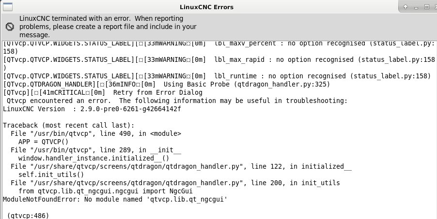

I've never used git / path. How to use it to make it easier to make changes?
Which image file paths have been changed?
Which line numbers have an error?
It is possible that I am doing something wrong, I would like to avoid such mistakes.
After the last update, qtdragon does not start, and so does qtdragon_hd.
As for qtdragon_hd.ui, I see a lot of flaws, I don't use qtdragon_hd but I will be happy to work on it.

10 Apr 2022 23:42 #239869
Replied by cmorley on topic Error in tool_offsetview.py
After checking manually I agree ..I can't find any image file not using the resource file.
I did a diff check of your file vrs the latest file at the time and it seemed to show image path changes. weird.
Development in linuxcnc is usually done by compiling the source code which is held on github.
After that you can do 'pull requests' of new work or send patches made from different branches or i can look at your code on github.
Normally posting the changed files here is fine, it's just ui files are tricky to edit.
I'm happy to get improvements on any screen you are willing to work on.
I think I have fixed the error you found - it may take a bit for the buildbot to update.
Chris

12 Apr 2022 22:30 #240091
by MarkoPolo
Replied by MarkoPolo on topic Error in tool_offsetview.py
Fixed a lot of bad match bugs in qtdragon_hd. I can't use pull request yet and it's traditional for now. I have modified the latest qtdragon_hd.ui file. so it is possible that it is enough to replace the whole file if you accept these changes.
qtdragon is now working properly, ngcgui is starting (I don't know what's going on yet, but it's a detail), the buttons that are supposed to turn off during work also work fine. Thanks.
