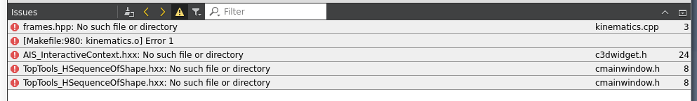

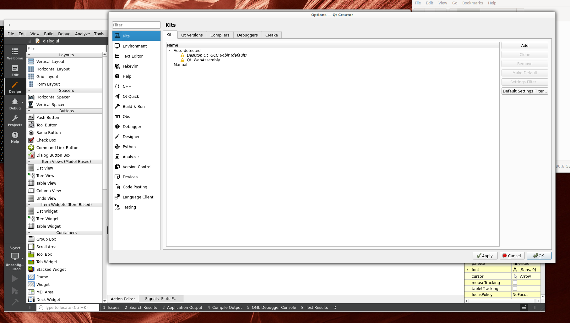

So I started again with a new ISO install and installed the qt online installer and installed the missing libxcb-util1 then installed cmake and made the archive. Then I pointed "Qt versions" to the correct location as in the git tutorial.
Now when I try to compile a new project the compile buttons are inactive. I think this is because it can't find a "Kit". How do I point it to the correct Kit?

Here i did point out to the "tab page" QT Versions, Tab Kits seems oke.
You can try to install my provided qt version. It's just copy paste.
Then you don't have to use the online installer, etc.
howto: github.com/grotius-cnc/QT_Creator/releases

Start Qt, add a kit (this will create a default kit), add Qt Versions : Desktop/Qt/5.15.1/gcc_64/qmake
When you load the Qt project "Qt_skynet_app" at your Desktop, file "Skynet.pro" it will configure and you can compile this.

Thanks for your efforts. Must have been a ton of work. I have now succeeded to compile and run "Skynet Robot Controller"!
A few notes for other users:
Run the auto installers on desktop to your needs.
I also had to run the "Ethercat_installer" as Skynet.pro did not compile without it.
should be:
Start Qt, add a kit (this will create a default kit), add Qt Versions : Desktop/Qt/5.15.1/gcc_64/bin/qmake
It's important to remove the other entry (the one with the yellow warning sign. Otherwise the compiler will keep using that.

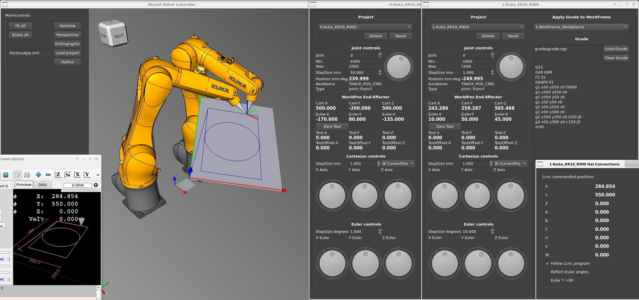

Once the project successfully compiles and the window "Skynet Robot Controller" appears, click on "load project" to load the KUKA robot.

A nice practice to start with is to load your own robot step files. You had a tiny white robot. I edited the orginal kuka stepfile
with Freecad into one file for each moving part.
To start and try out a little bit, you have only to edit the FactoryApp.xml file.
Then you could load your own robot step files, and change the parameters of the kinematic chain in the xml.
That should have to work. The kuka document helps you to figur out, how the chain dimensions are used.
If that is done, you could start lcnc and load a gcode file into the workframe, and try to move it from lcnc.

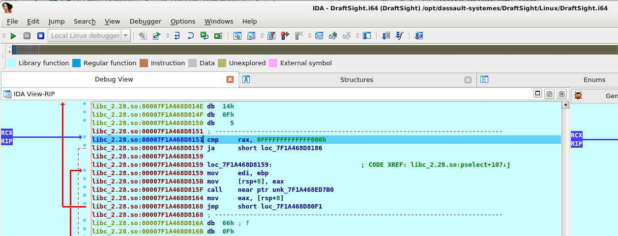

Now loading DraftSight 64 bit with IDA.
It stops at the rax line. How to solve this?
