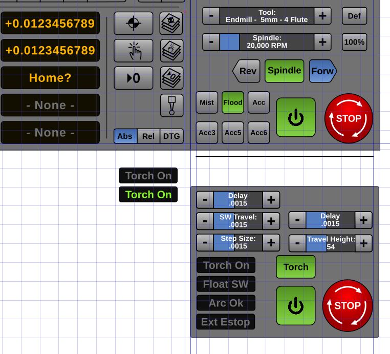

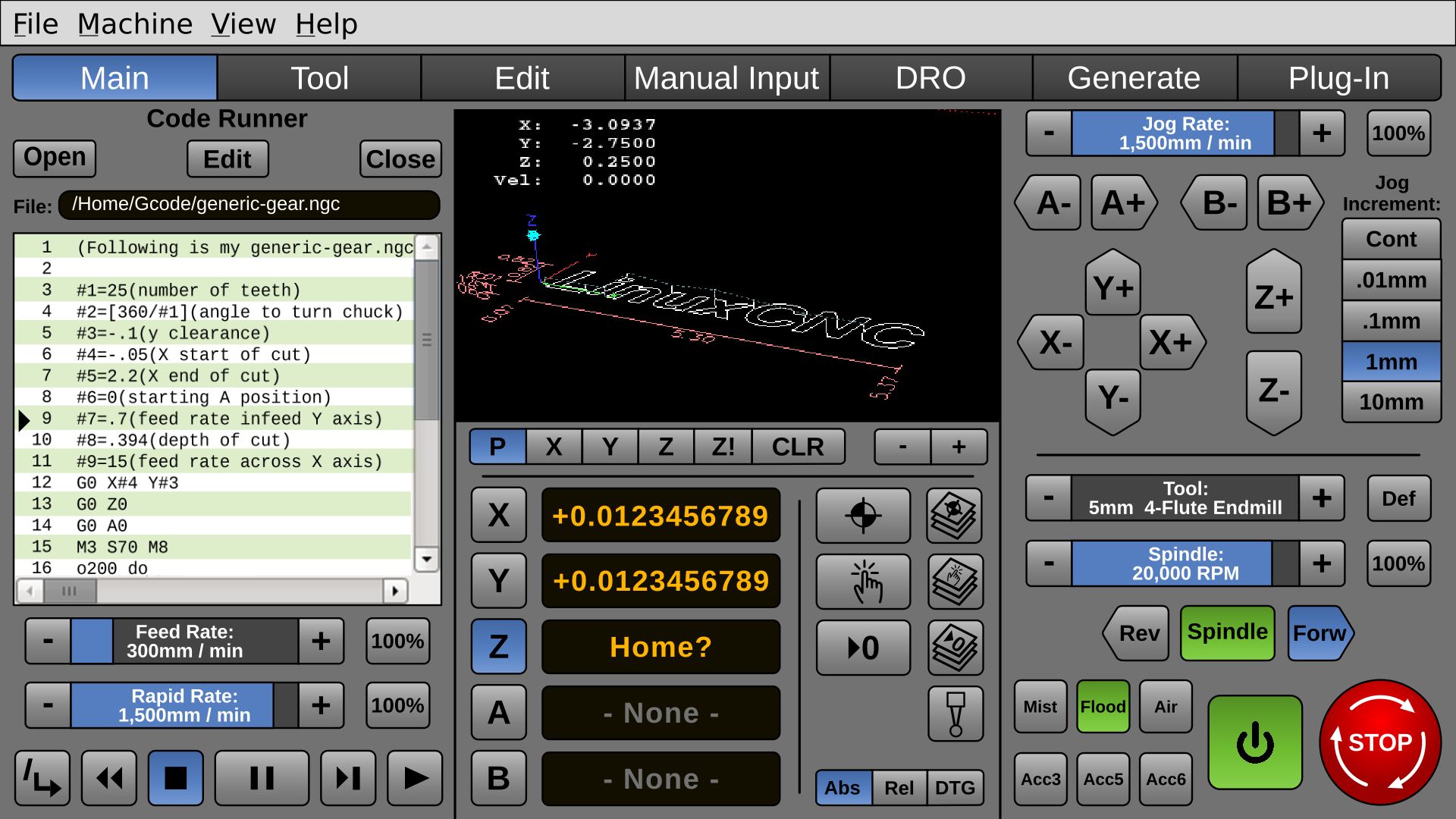

* Added Touch Buttons
* Added Tool button, but I don't like it
* Reworked Axis/Homing/Zero
* Removed Quick G-Keys for larger code view. To be moved to Manual Input
* Changed MDI to Manual Input, so new users would know what it is
I am not sure what order the items in tab menu should be?
I don't like that there are 2 "Edit"

Well, it seems that there needs to be a machine-specific control panel, which can be configured to each machine type.
...as well as rethink, on my part.
It appears that 1/5 of the screen is for the machine-specific controls.
The mockup I am making will need some indicators. Check boxes can be buttons, perhaps.

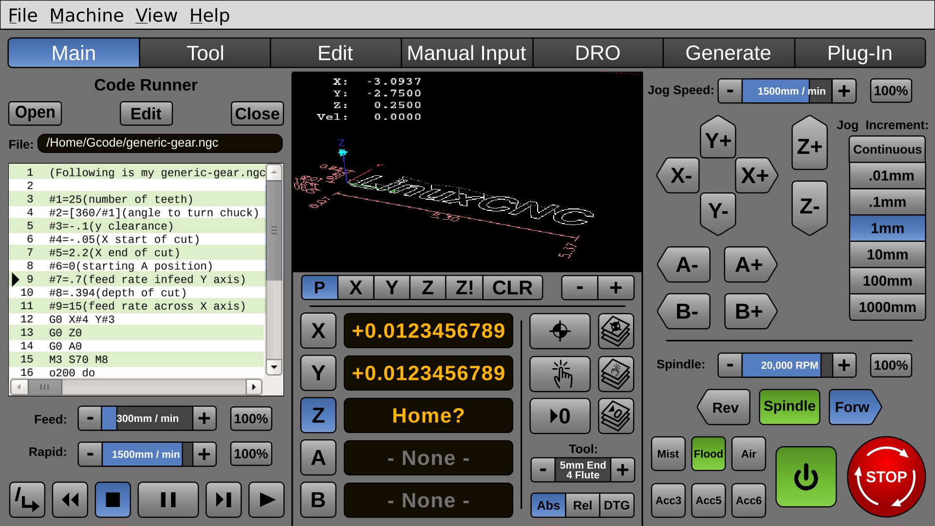

* Moved the tool selector into the lower right, so all the machine specific tools are in one place. It's a start toward flexibility.
* Placed potentiometer text inside the boxes. Might make a bit smaller.
* Started on Probe buttons.
I am trying to decide if the largest buttons can be a bit smaller. I really want the interface to work safely on a 14" touchscreen, or mouse, of course.

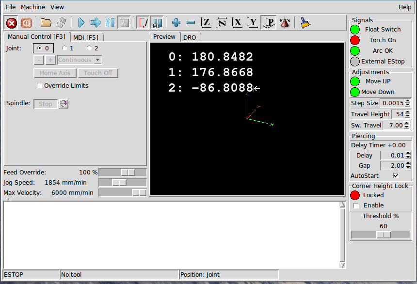

The other interfaces can embed a tab (PyVCP or GladeVCP. Possibly QT or others, I am not sure)
I don't know if any of them have a dedicated box for machine-specific things. I think that Hazzy is designed to be completely customisable?
Replied by andypugh on topic A Widescreen Blender-Style Interface
