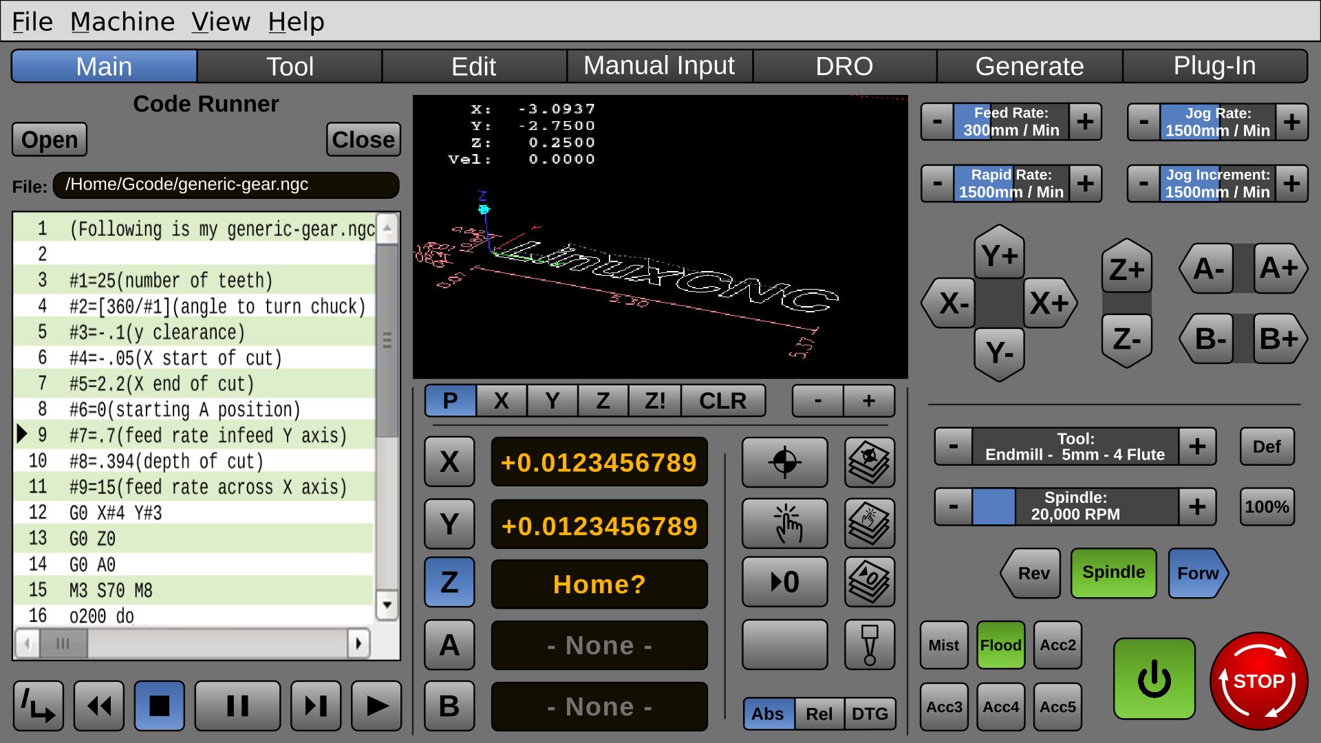

I'm still trying to keep an entire 1/3 screen for special functions, or the default "Code Runner" which means that all the other controls have to live on the other 2/3 of the screen. This has been a challenge, requiring compromise.
For now, I changed the Jog Increment to a progressive control. I don't like this, but I do like having all the normal controls on 2/3 of the screen these areas won't change.
The idea, as such is, that except for the On/Off and the E-Stop, the lower right panel would be configured to a machine-type, such as Mill, Torch, Laser.
I don't have a touchscreen, so I am resizing the mockup to 14" diagonal to see if I can hit them. I tend to favor the bottoms of each area.

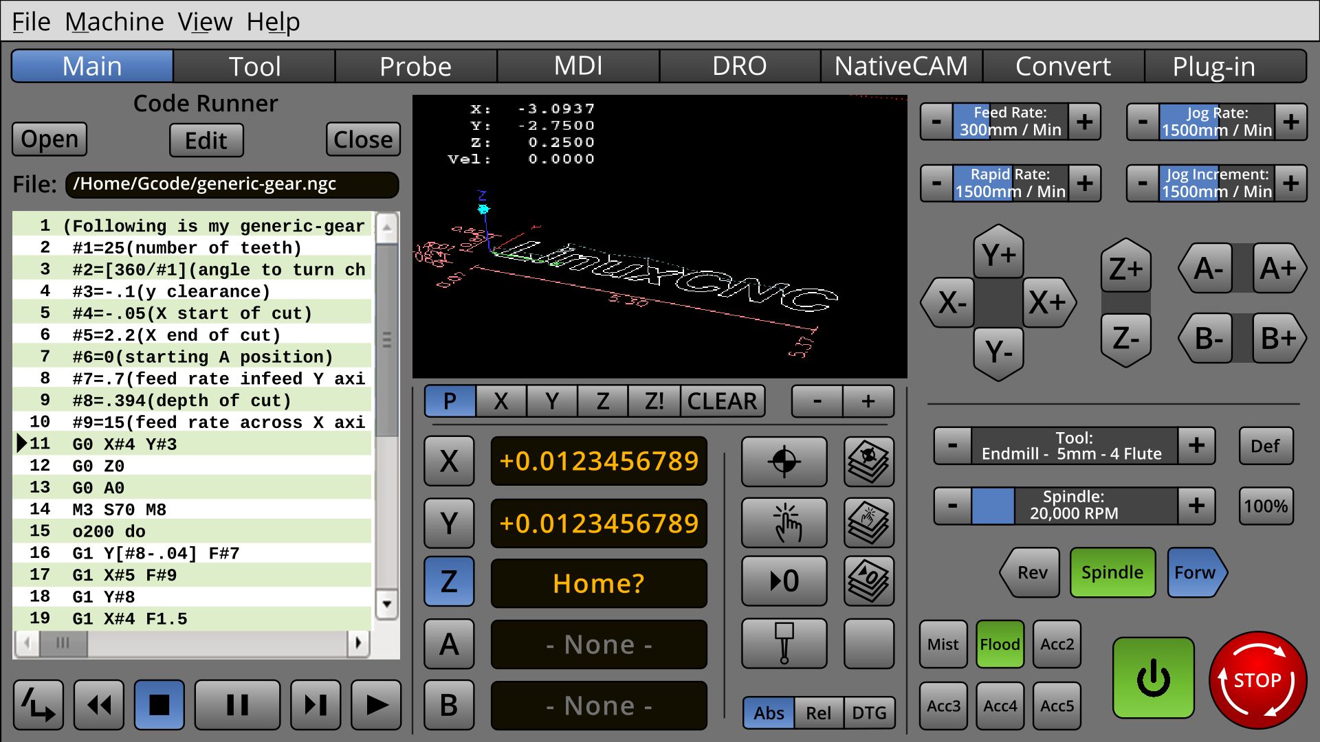

* Included Probe Menu. I thought that there would be a full probe menu, and also a probe button to perform a single predefined probe function.
* Font was changed to "Open Sans," which also has a good license is also good for. I really like the look of Mint Linux. This is almost the same font but has other typeface options, such as the Semi-Bold used mostly in this screenshot.
It's kind of a funny thing. If the fonts are too light, they are hard to see, and if they are too bold, the eye becomes lost inside the blackness of the letters when you get close. I noticed that on the X,Y,Z... Buttons.
It would seem like a good idea to include NativeCAM in LinuxCNC, perhaps Pycam, though with everything called CAM, it would be confusing to a new user. I would Generate and something else for NativeCAM, but if NativeCAM was native to LinuxCNC, what would it be called?
The Readout mode is really in the wrong column. It should be nearer the readout.

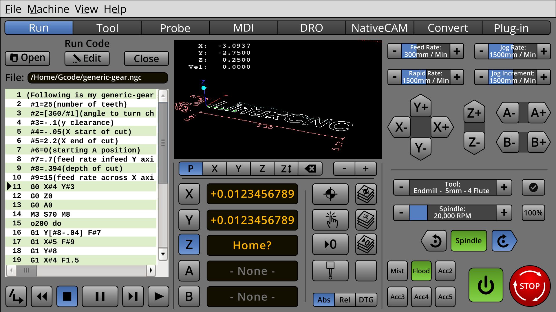

* Changed "Main" to "Run."
* Experimenting with adding some Faenza icons. Faenaz is a very popular icon theme. Because all the icons, so far in the mock-up are monochromatic, I just extracted part of each.
There are now several new icons.
I was worried about the Estop looking too similar to the Forward and Reverse icons, but because the color is different, it appears not to be a problem.
I've had an ulterior motive for using popular icons and fonts: I want to present a familiar interface. I've not really tried to make anything new here. In fact, I'm trying to take as much from other works, to make people comfortable.
On the Main or Run menu, I've not wanted to put the traditional probe icon, because it's not apparent what it is without adding the reddish probe tip color. I've been trying to keep red and green off the interface so they can be used for On/Off and Estop.
