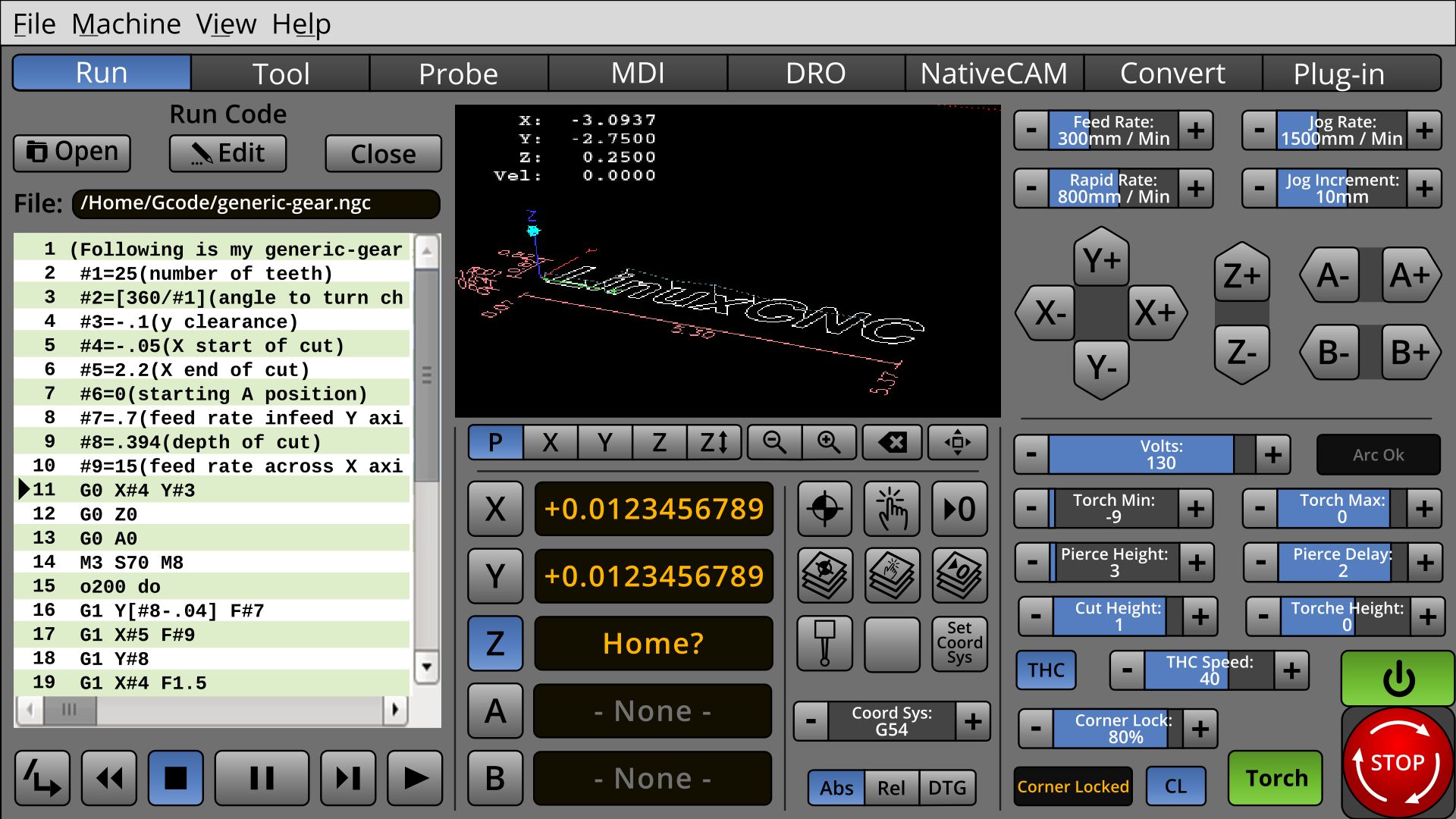

I am still working on the torch controls, but I don't know which ones need to be on the main screen.
With no feedback as to their priority, this is the mess I've made of them.
I was hoping that I would get them close enough so a Torch Person could tell me what I am doing wrong.
Until then, this is what there is : )
Note: The torch controls on the lower right are swapped for milling controls, where applicable.
Also note: Minor redesign of the Estop and Power buttons. They aren't going any smaller.

* Changed E-Stop button shape to square. I was worried that the user might mistake the onscreen Estop for a physical one. The screen button is estop'ie enough, but not too much.
* Reworked Home/Touch controls. I am back to liking them.
* Minor change on View controls.
* Totally done with this for tonight, this time, really, I think.

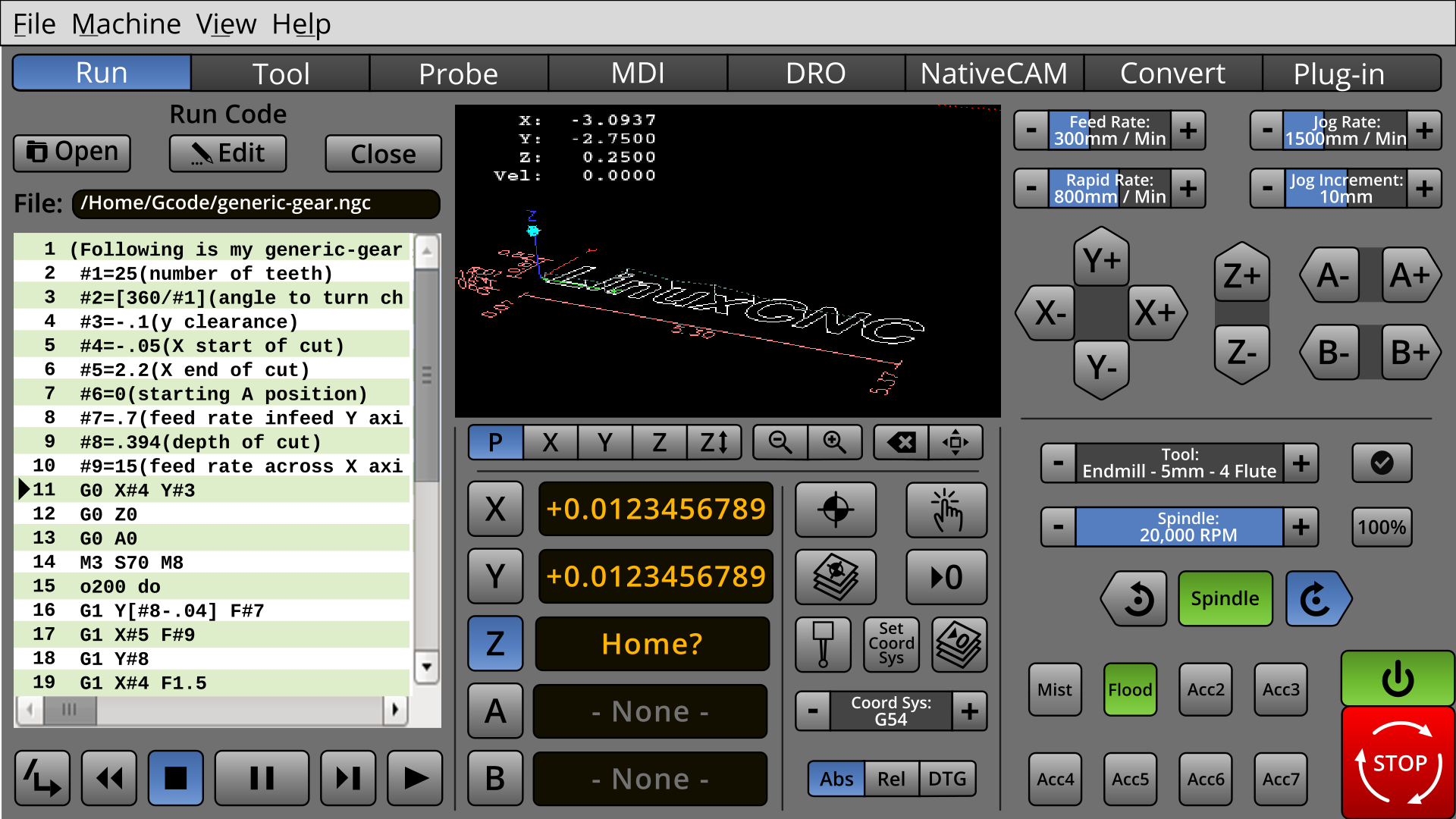

Do you think a lower right panel could be made for a lathe?
What should Icopy--err draw inspiration from?
What do you want on there?
What should I

Well, seeing as you asked...
If the INI says "Lathe" then you probably want to rotate the jog arrows and lose the A, B and Y. (But potentially reinstate them if the GEOMETRY says that they exist)
A lot of people seem to be jumping through hoops to be able to use the Tormach PathPilot interface, though I haven't even bothered to experiment.
goo.gl/images/1qP9o9
As I say, I think what LinuxCNC needs is a dedicated lathe interface, not a Mill interface with mods.

Many of the controls are common between a lathe and mill, but the nice tool selection menu should be made in the "Tool" tab.
The X,Y, Z should work for both.
I've made the A and B controls and readouts smaller, though I've added a C. For a lathe, this area can be used for "Diameter" and "Length", and perhaps something else, perhaps something avant-garde such as "Tool Distance to Chuck."
Other than the Estop and Power buttons, the lower right panel can be whatever else a lathe needs, but the remaining controls are closer to a mill than a torch : )

-Torch Volts should be there for people with THCAD ( myself included recently, still sitting on my desk)
-Pierce height should be there, rarely adjusted but needed for cutting thin and thick plates.
-Pierce delay should be there, used more often but can also be set in gcode.
-ARC-OK must be there, usually programmed to motion-enable so machine will not move without that signal.
-UP/DOWN LED's should be there for people with simple THC, also useful for THCAD.
-Cut height should be there, can also be adjusted by changing Voltage.
-Torch height not needed, can be adjusted by changing Voltage, same as cut height.
-LED for floating head switch should be there.
-Floating head switch travel does not need to be there, has to be set once per machine.
-Travel heigh would be nice to have, on thicker material can be set lower, saves time on multiple cuts.
Can not think of anything else for the moment.
Thank you very much.
Replied by tommylight on topic A Widescreen Blender-Style Interface
