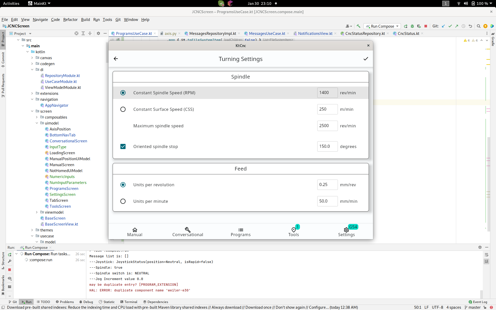

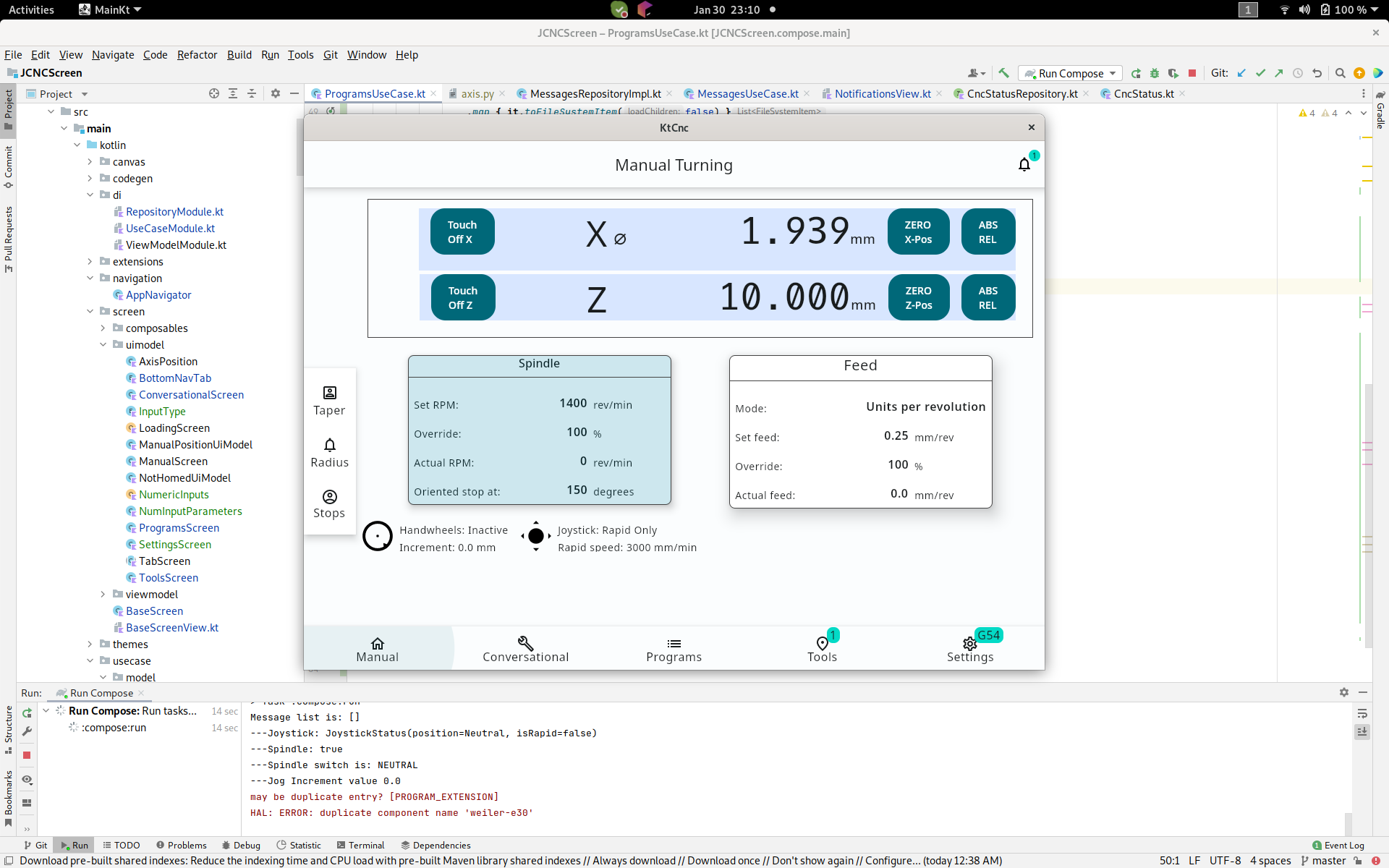

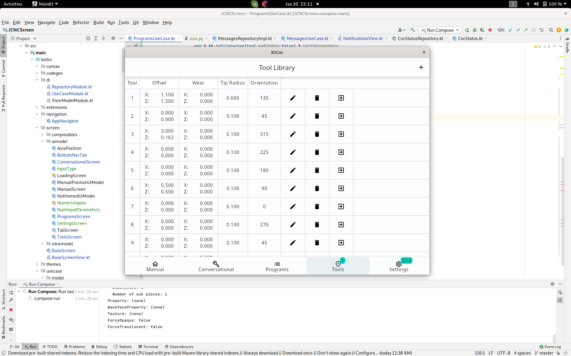

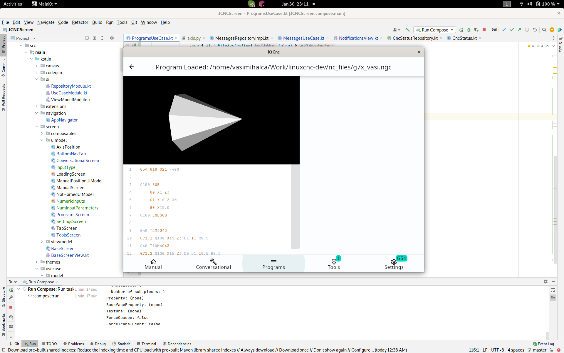

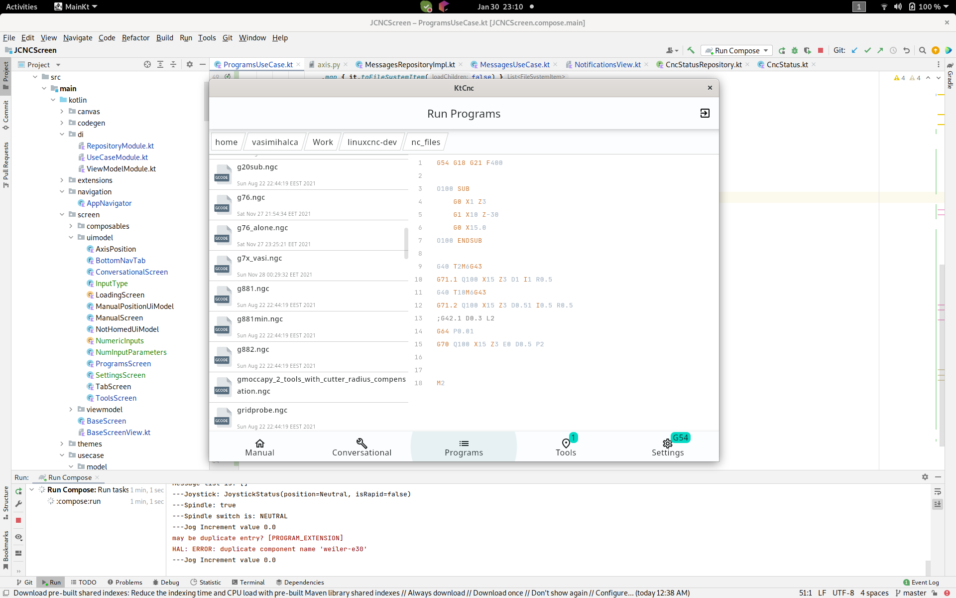

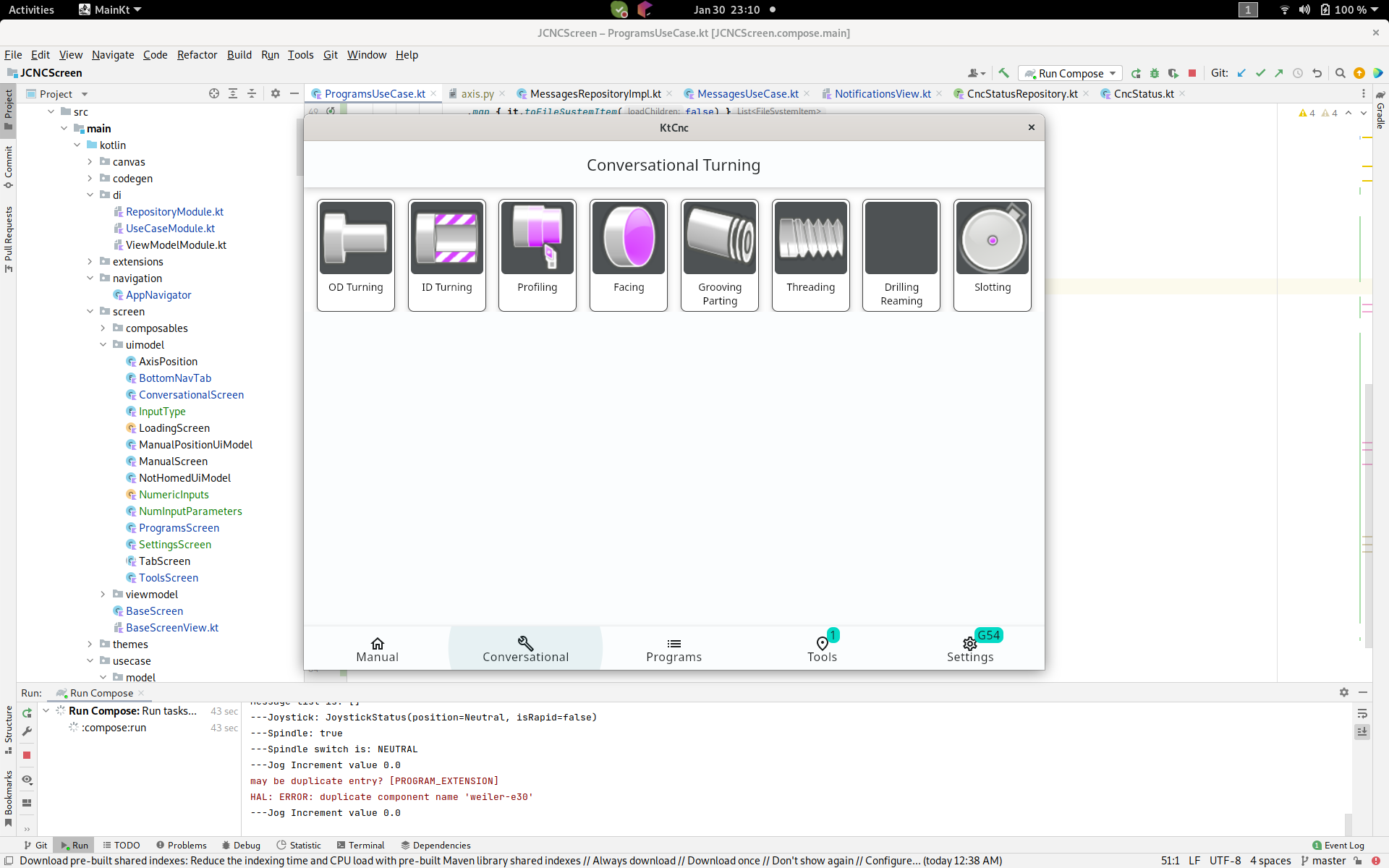

30 Jan 2022 15:20 - 30 Jan 2022 15:23 #233581
by vmihalca
Replied by vmihalca on topic Java UI for linuxcnc
Hi Reinhard, I was recently looking again over your code trying to figure out how you have implemented the rendering of the toolpath.In the meantime I have managed to sort out the JNI for interacting with HAL, I can create components, pins and interact with them.So now I am able to react to the physical buttons of my machine in the software. I don't know how many hours of coding you invested on your app, but for sure I had lots of work on mine and I am quite far from being over. Other than the benefit of better learning kotlin and compose ui framework which helps me in my day to day job...I could have written it faster in qtpyvcp, but now that I am here, I would rather try to sort out the rendering part. I only need 2D rendering since I am using this software only for lathe, so if you could help me figure this out, I would be really grateful.Below you can see some screenshots from my app, and I need to mention that your work on JCNCScreen was a huge help.
As you will see, I don't have icons yet, everything is quite work in progress, but so far I got all the features that the old sinumerik from weiler had.
